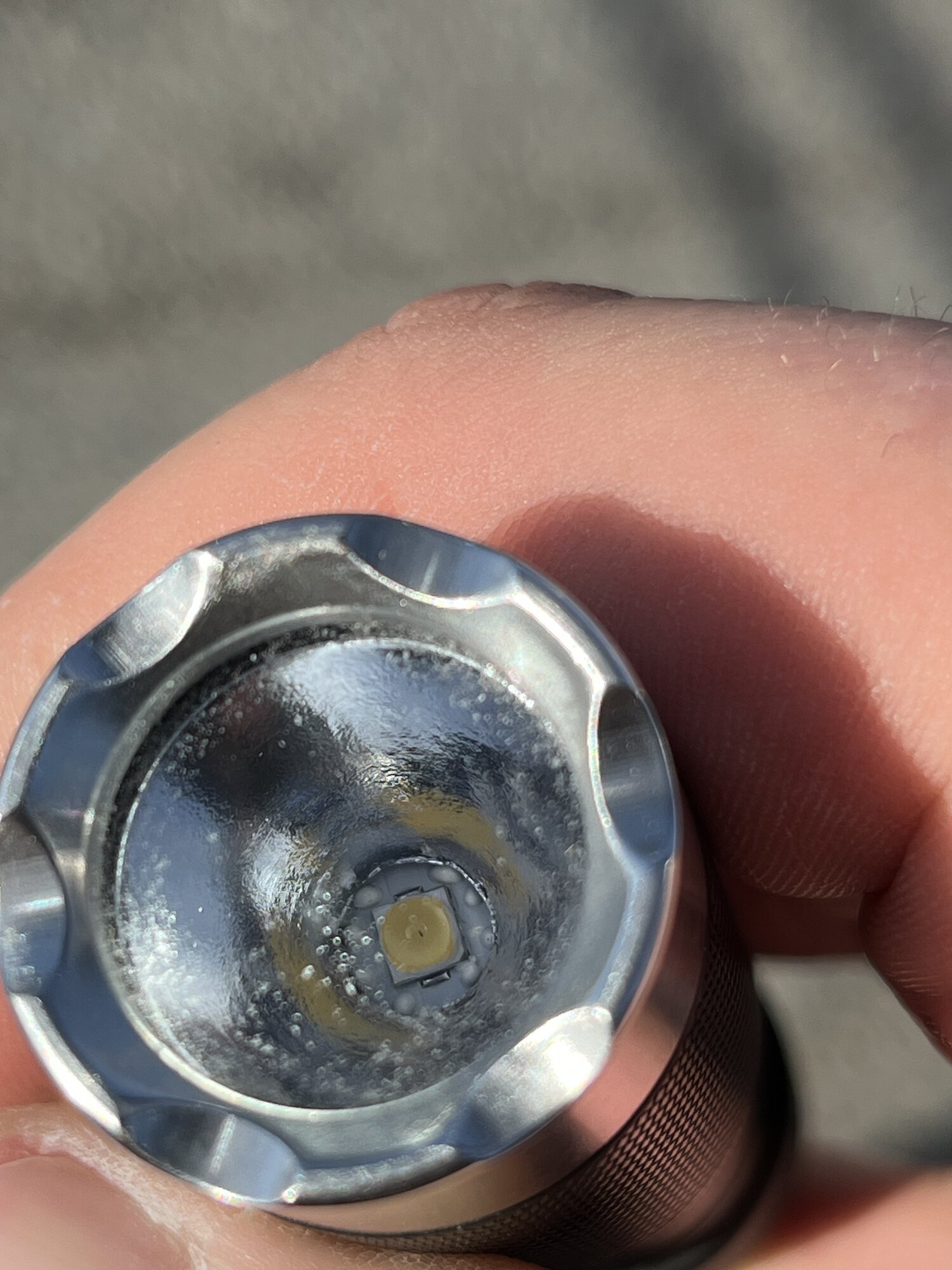

Finally something I can contribute to. First off, let me say I'm one of those people who are extremely careless with my gear (hence why I buy stuff I CAN be careless with.) I fish daily on the river and have beaten the hell out of these lights. Aside from that, I am constantly setting things down in the rocky/sandy beaches on the river (think the beach, but way coarser sand). Everything I own gets covered in sand and wiped off with the ole' trusty shirt.
It was MUCH harder than you think to even get this on camera, but as you can see, I've managed to scratch the glass lens on the left where I've only partially removed the AR coating on the sapphire on the right while the surface of the lens is relatively unscathed. Both lenses are in SIGNIFICANTLY better shape than some of my other lights I use, trust me...I had to seriously abuse these things to get to this point. If you are working in a highly abrasive environment, the only "benefit" of sapphire is just that...you will only destroy the AR coating and not the surface of the lens it's self.
With all of that being said....at the end of the day, turn the lights on and you couldn't tell the difference from a brand new beam to save your life.

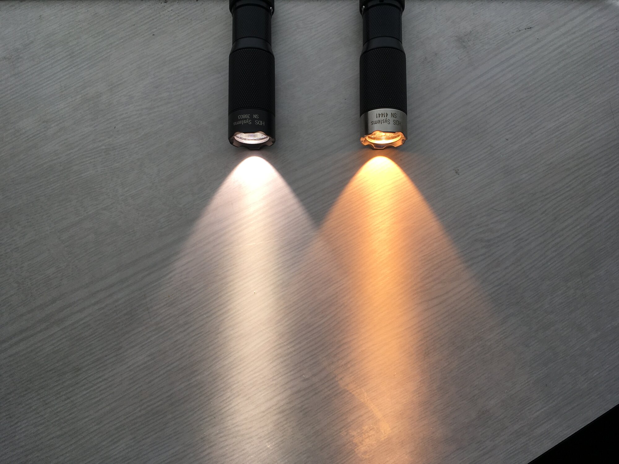

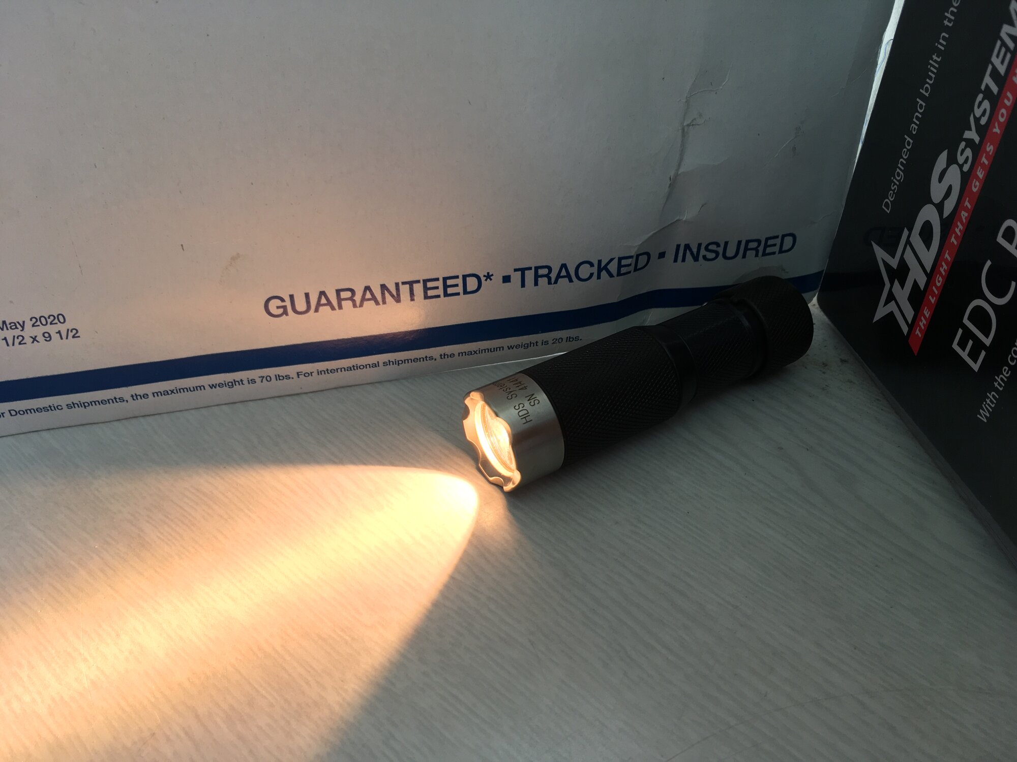

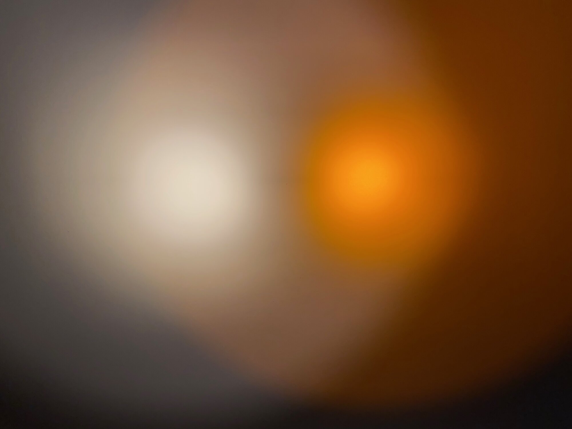

The NB27 I ordered arrived today. It was a very nice incandescent warm color temperature. For the time being, I compared NB45 and NB27 side by side. In the daytime, the low color temperature is more emphasized, and it feels as if the setting sun is shining only here.

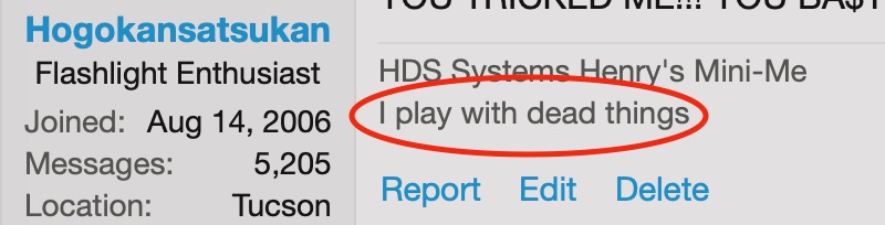

So I went back to school for a bit because I was bored and wanted to tick off a few skills on my "should probably learn this" list. Last day of class was on Wednesday 17th, took the NREMT test on Thursday the 18th. Got the results on Friday the 19th. Received my AZ EMT license on Monday the 22nd. Applied at a place on Tuesday the 23rd. Interviewed at said place today the 24th and was hired. Will be going to paramedic school next year.
All this because I didn't want to say "Welcome to Walmart" like other people my age.
So my question then is this... should I keep this as a tag line?
