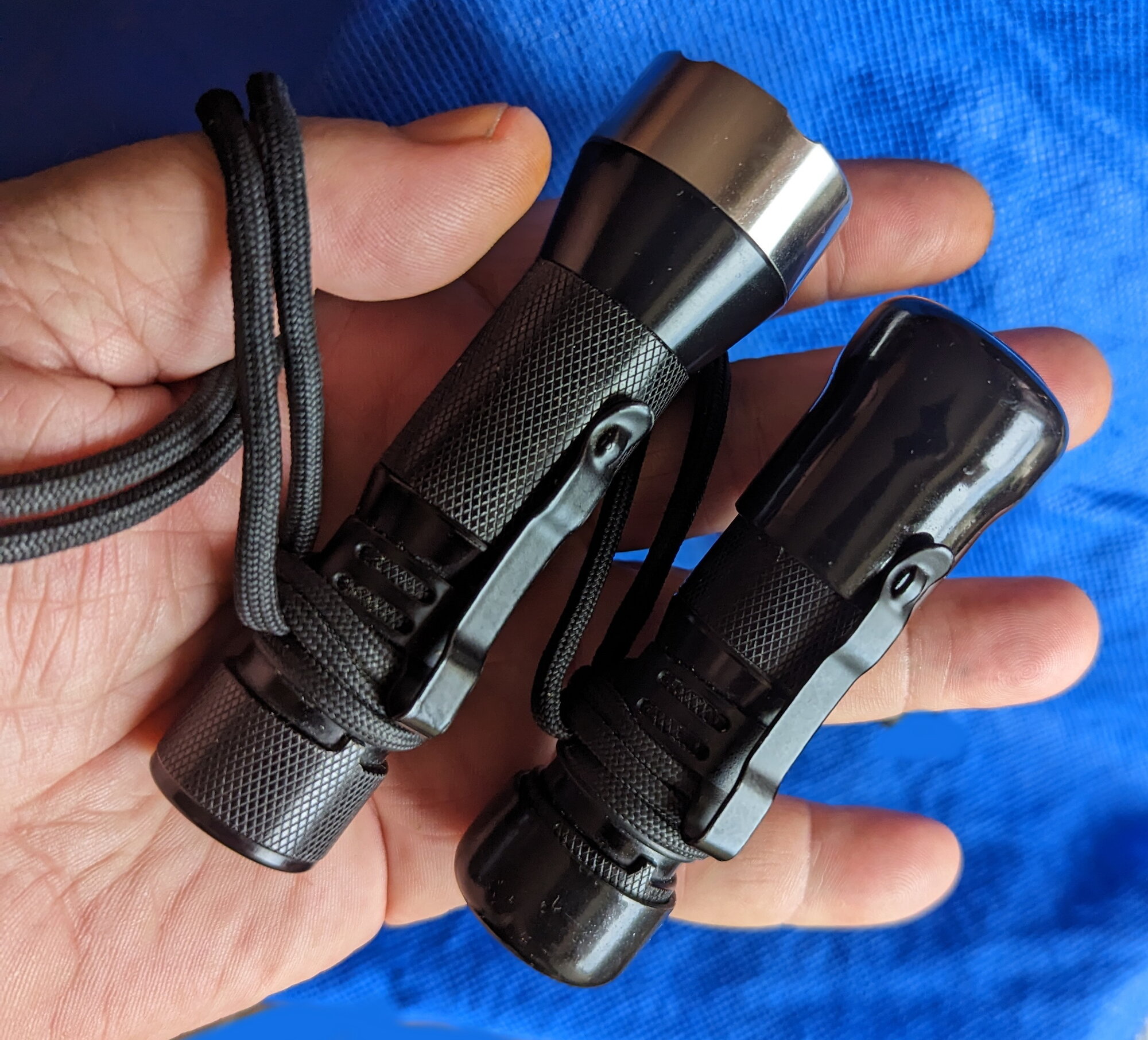

That's true, I just go in the back yard and see how far I can see with it. On another note, you should try an HDSRB bezel if you haven't already. Get all the throw you could possibly want with it.
The HDSRB bezel is great, but makes the light a little too wide to easily pocket.
Good point. I'm still trying to find a solution to this. In the pic below the 123 on the right, even with the Novatac vinyl caps fits perfectly in my front pocket.
The 123 on the left with the HDSRB bezel is another story. May have to try to find someone who knows something about leather to make some kind of holster for it.. Or in pocket bezel up? Hate to do that though..
