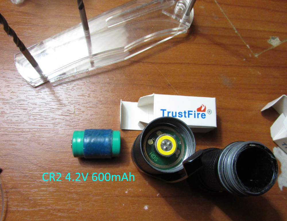

The shop sent me the wrong batteries a year ago, I only checked them now. Instead of CR2 3.6V lifepo4 there is CR2 4.2V li-ion. They can kill the CR2 flashlight that I ordered (or not, but it's too old and rare to check that), so I had to wrap it with electrical tape so that they would not dangle too much and now they live in HDS, lol. I checked both batteries, 16 minutes at level 23 (burst on) and then a sharp drop of 5-10 seconds on every step and shutdown

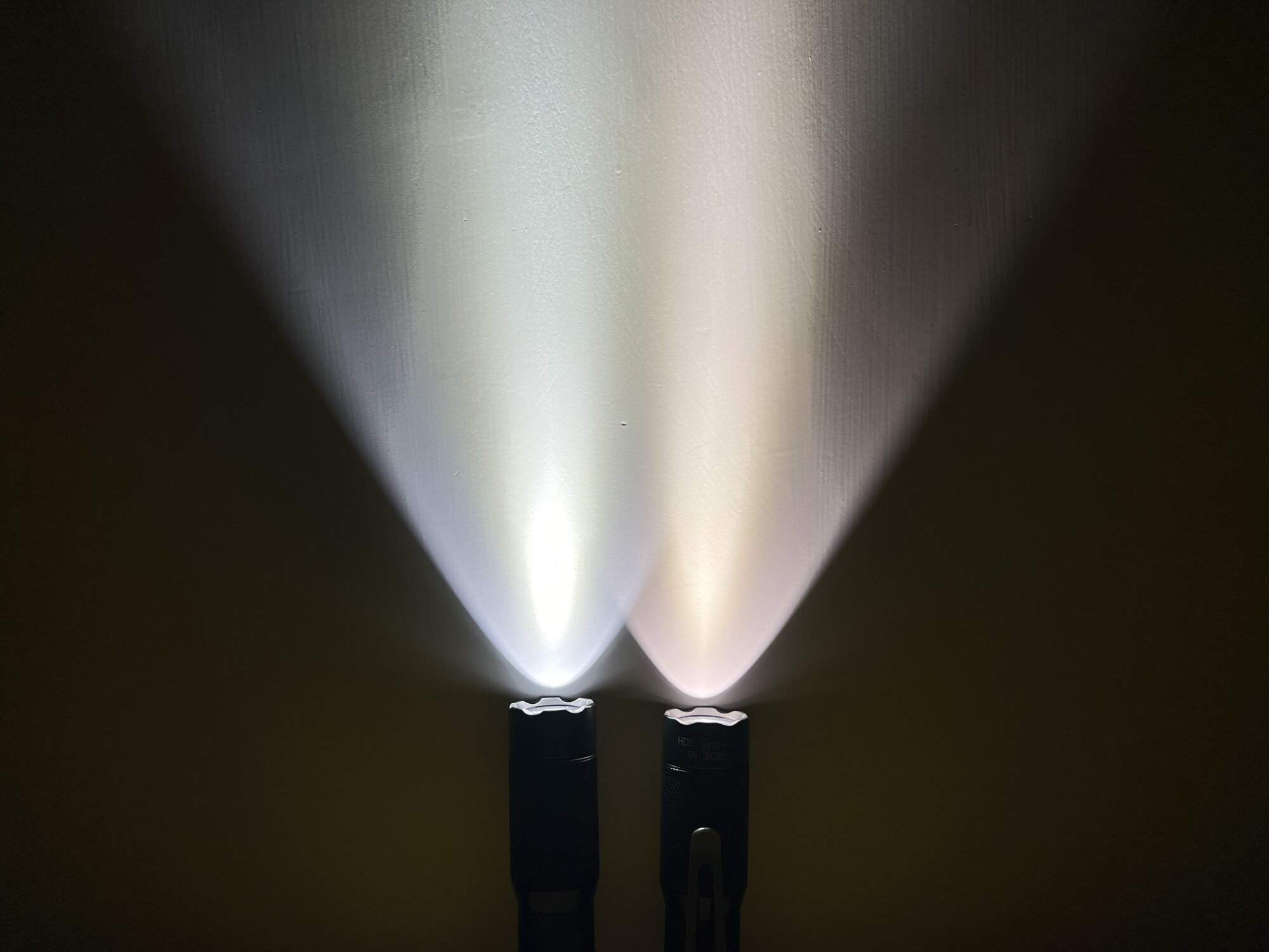

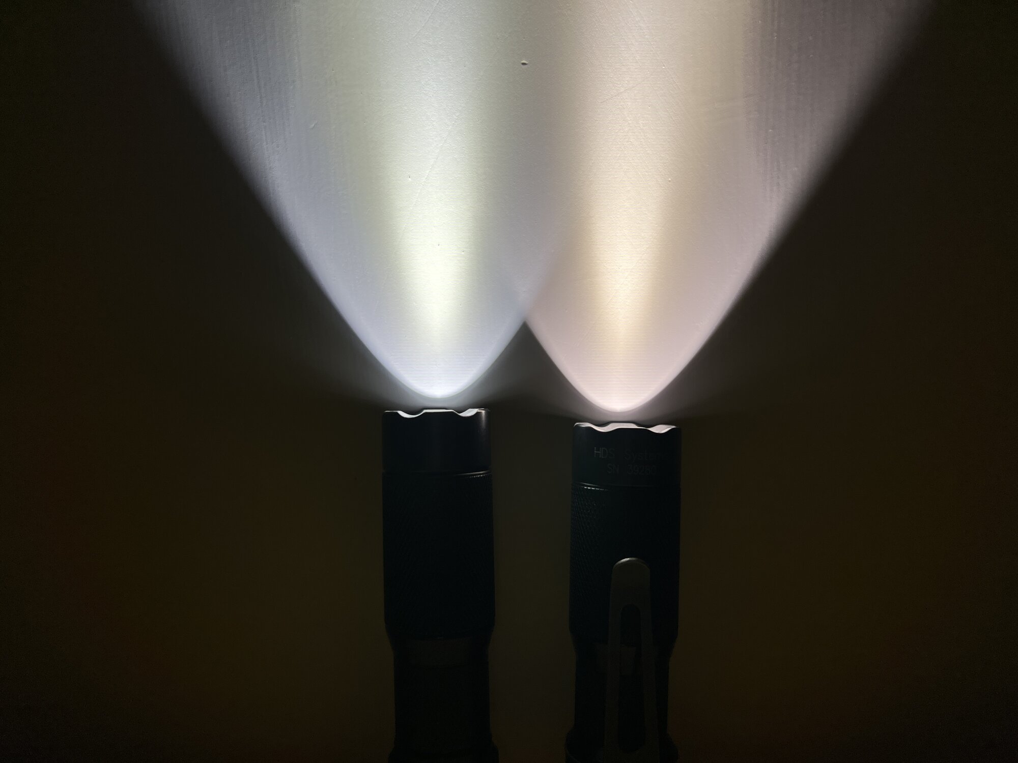

hds with nb45 next to a hds with na52?

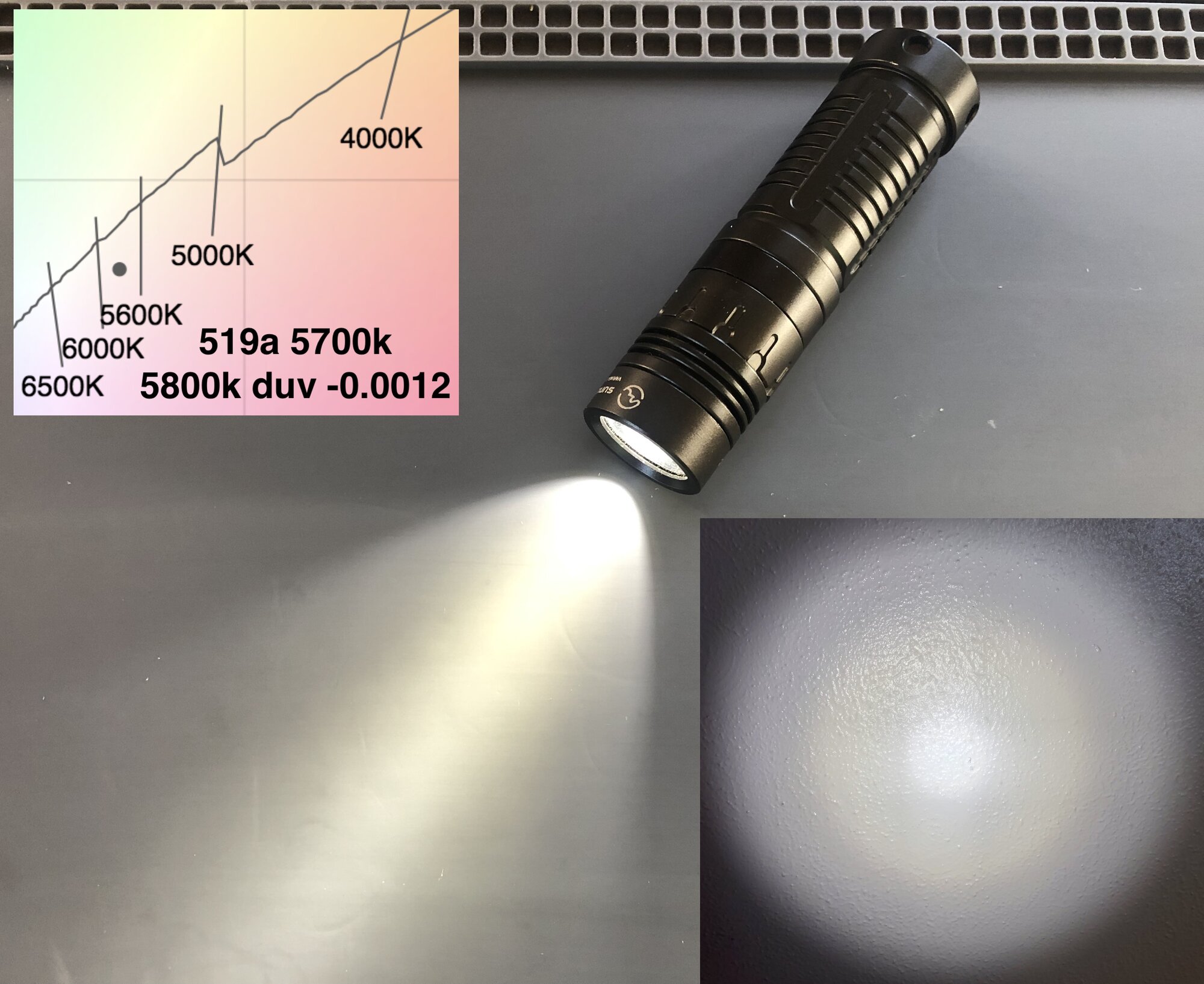

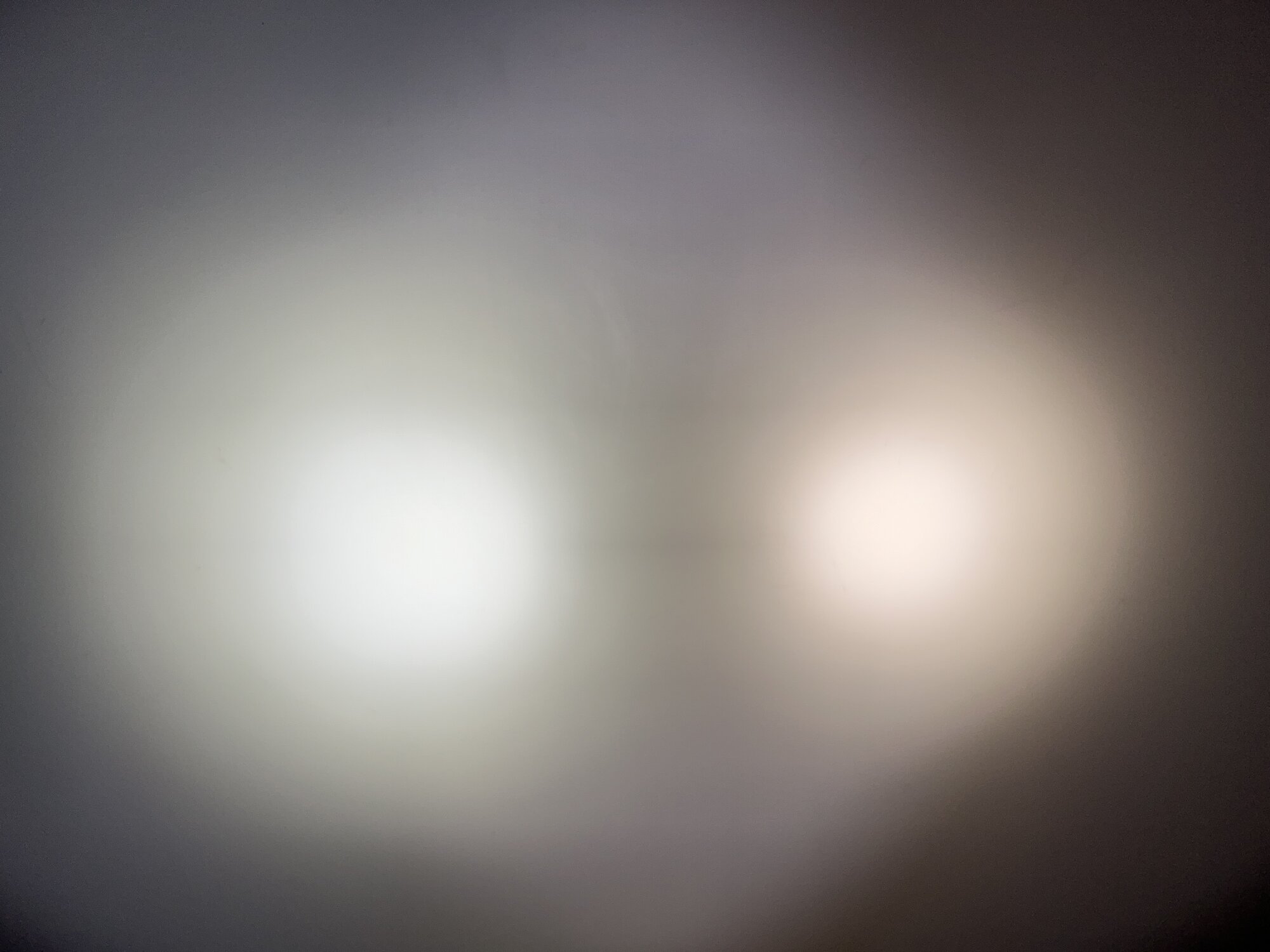

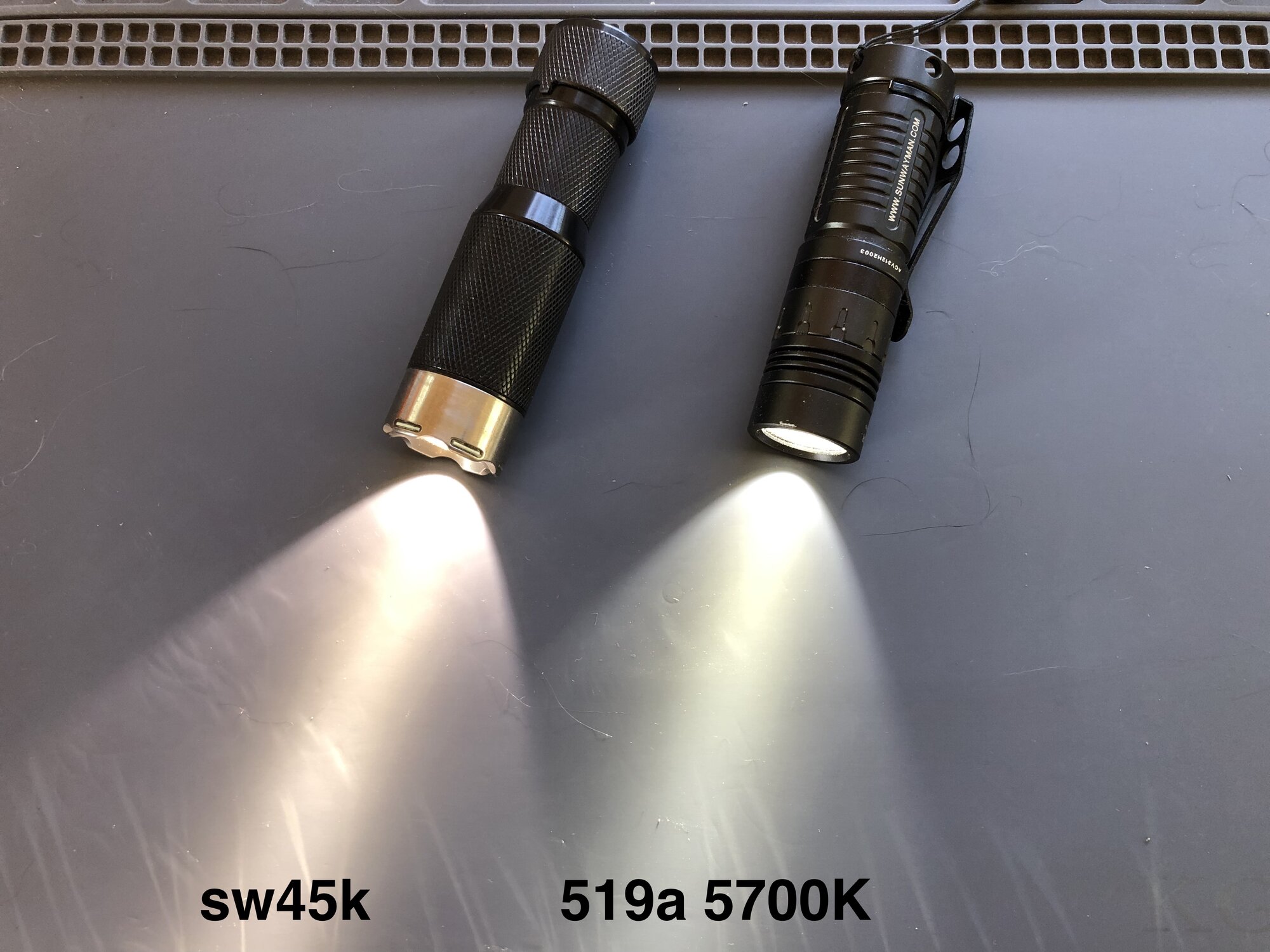

The Sunwayman V10r reflector is not as deep as the HDS, so the transition from hotspot to spill is not as clean as on the HDS.
The 219b has a smaller dome, so a slightly smaller hotspot. The batch of 5700K 519a that HDS got, are closer to 5200K than 5700K. I do not know the Tint DUV of the HDS batch.

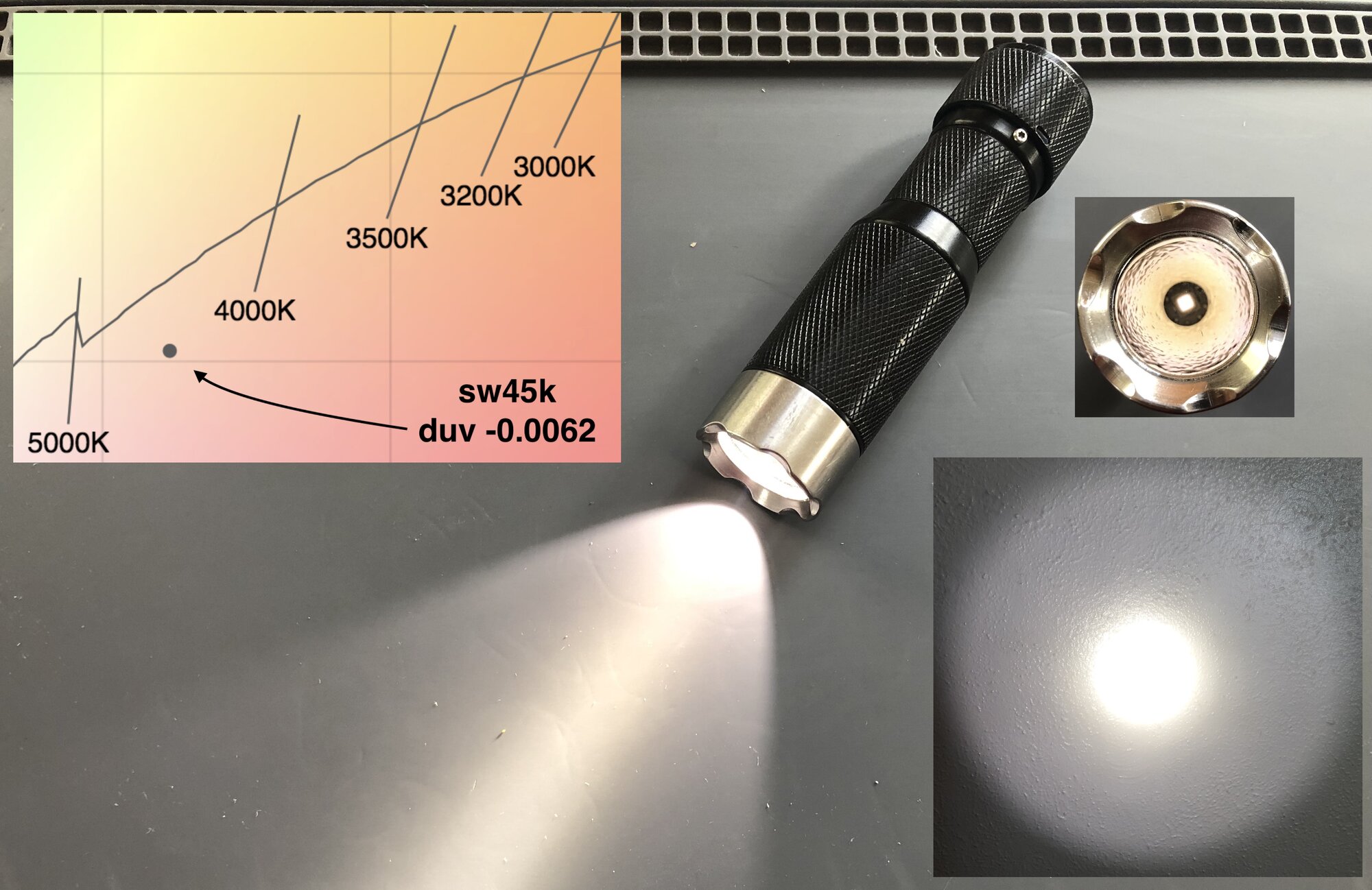

sw45k is my personal favorite. the 519a is also nice, especially if you prefer less pink tint. The cooler color temp of the 519a is nice during the day.
Thank you. Seems like nothing can beat sw45k… not liking the tint on that 519a.
I appreciate it. Will most likely buy another sw45k rotary.
