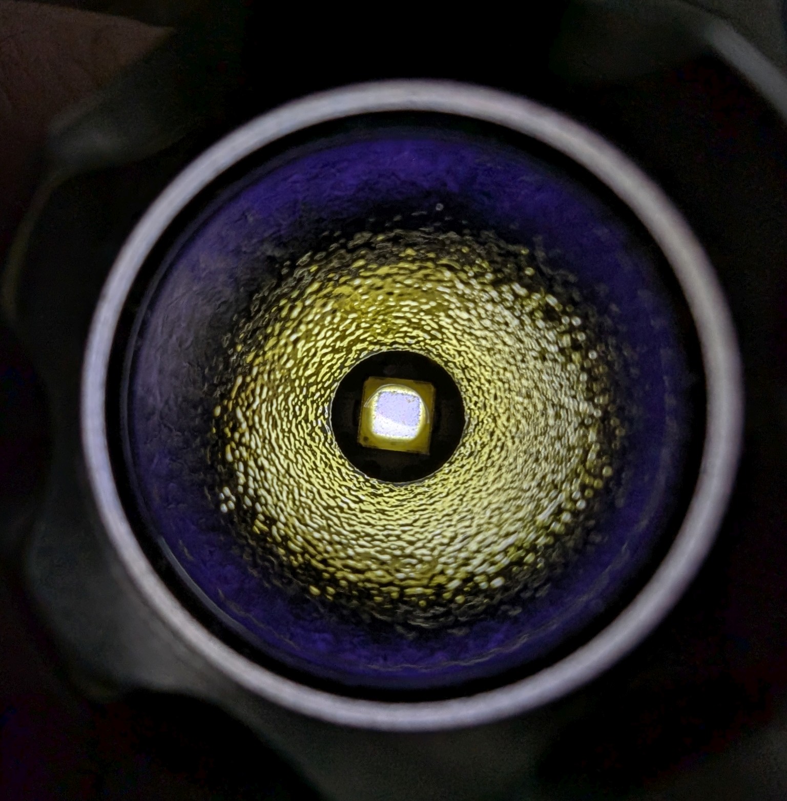

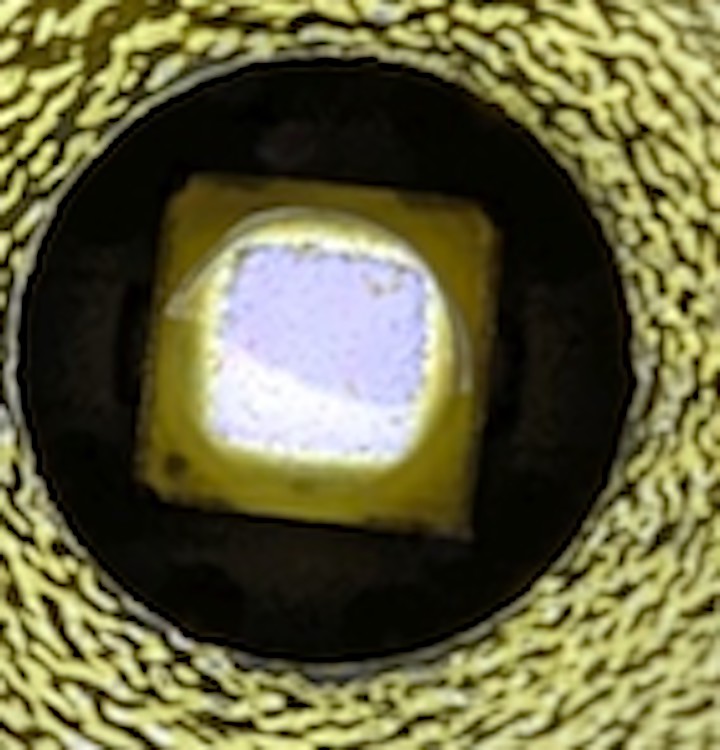

I saw it because half the emitter was darker at low levels. Then when I looked closer I can see a line where the dome is separated. I don't see any tool marks or scuffing that'd make me think someone tried to de-dome it, but who knows. Seller was an experienced HDS owner who claims he didn't notice this or a missing body O-ring.

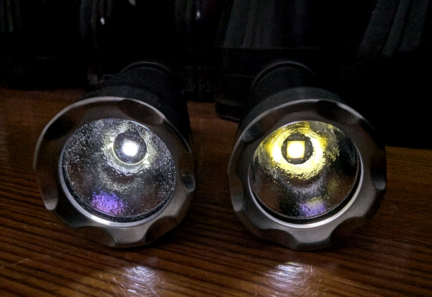

Wow… nb45 looks a lot better IMO. Thanks for the comparisons!
I also did a compare :D
NA52 is a little bit more on the yellow side NB45 is a bit more on the red / rosy side.
[bimg width=600]https://i.imgur.com/Kbnhj7b.jpg[/bimg]
[bimg width=600]https://i.imgur.com/mDgkVUt.jpg[/bimg]
Great photo, that does look like a problem
If HDS does not want to give you a free replacement head, I suggest you send the light to Andy Zhu and have him install a High CRI LED.
For example a Nichia 519a in your choice of color temperature. I recommend Not choosing DeDomed, as it ruins the border of the hotspot.
Jonathan is right, XPG3 dome is holding up very weakly. Once I did dedoming by accident, when there was a piece of some dirt on the diode and I wanted to wipe it off with a cotton swab :oops: (It wasn't HDS)

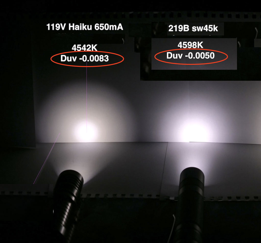

Does anyone have both an HDS with the NB45 and a Haiku with the 119V to compare? I like the selection offered in the McGizmos, they have a touch of pink but not too much. Some of the HDS beamshots look much rosier but it's difficult to tell on a screen. Interested to hear if someone who has both can estimate how similar (or not) the bins are between the two. I'm hoping there's enough blue in the HDS to make my brain happy.
Big props to Henry at HDS--11 day turnaround and I have the light back with a new head and new O-ring. He said he'd never seen a failure like this before. Buying it was frustrating but dealing with the company wasn't. Right up there with Streamlight and Ruger for customer service.
