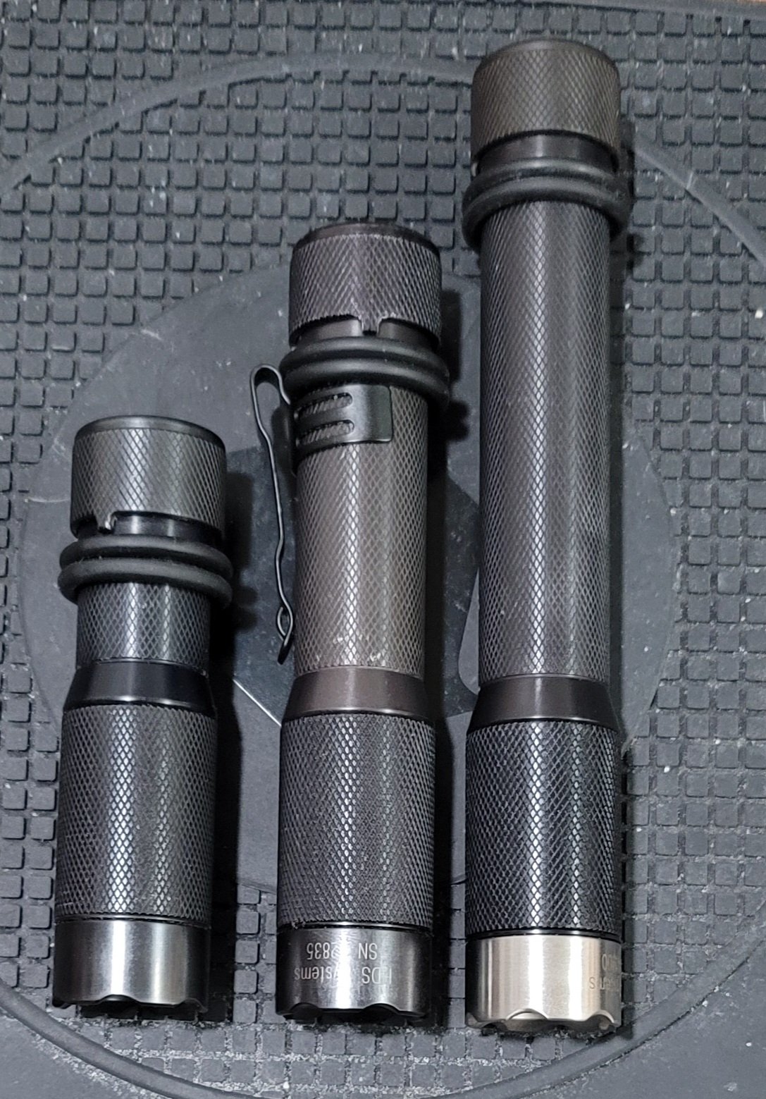

If you care about runtime and don't mind losing pocketability then the 18650 body seems like a no-brainer. A single good 18650 can give you over 3x the capacity of two eneloops.
I'm not sure if HDS are the same as Novatacs in this regard, but my "spec ops" novatac body can hold an 18650 if a brass strip is swapped for the signal spring.

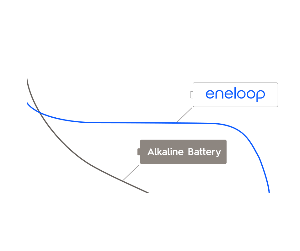

In fact, CR123A batteries have a poor output curve versus Eneloops, as they drop in voltage fairly steadily, while Eneloops hold their voltage throughout most of their output.
I'm still on the fence as to whether I prefer a tapered output (a la CR123A) versus a flat curve. In theory, I like the flat curve, but I think in usage, the slow decline gives me more time to react to lower capacity.

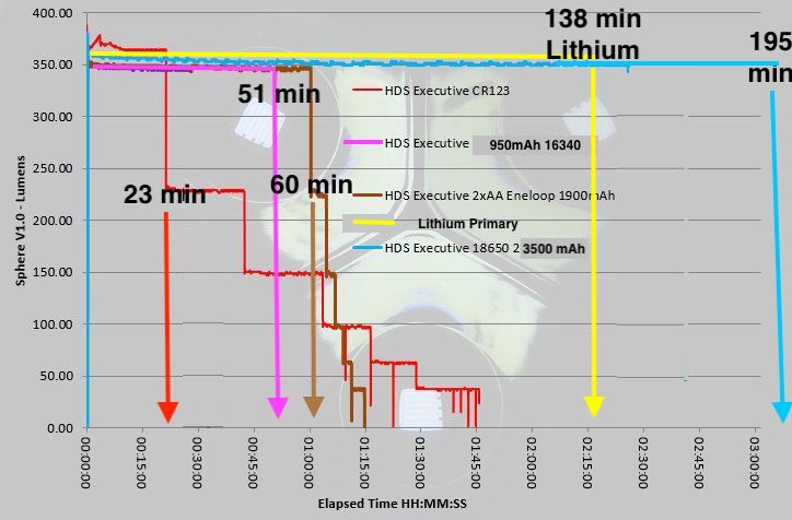

18650 beats all the other options, 2x Ultimate Lithium is second longest (1 hour less than 18650):
3500mAh 18650 is the blue arrow, about 195 min
2x Ultimate Lithium yellow arrow, about 138 min
2x White Eneloop is the brown arrow, about 60 min, (79 min w Pro),
950mAh 16340 is the fuschia arrow, about 51 min
CR123a is the red arrow, about 23 min

Lithium, yellow arrow, is 2x better than Eneloop:

I think the most interesting part of this is how much the CR123A steps down.
Was that intentional? Or just because of the way the voltage drops?
It seems like everything else just runs regulated and dies, but the not the CR123A.

The runtime graph is very clear. I learned once again that the 2AA has an incredible runtime. I also learned that the CR123A's power degradation occurs sooner than I expected when used at full power. I didn't notice it at all because I use the brightness level at low-medium.

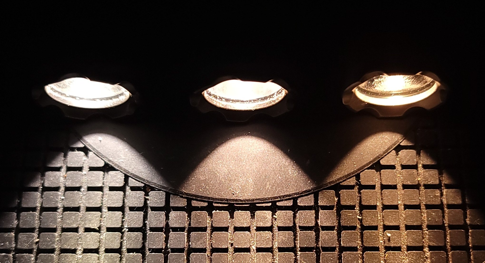

I certainly hope so! I have a whole slew of different color temps...2700k all the way to 5700k. I plan on dedoming the 5700k to get a nice 4300k and more throw, and already have a standard SPA120 with a dedomed 3500k (resultant around 2700k/2800k)
I've been slowly getting braver and braver with the LED swapping. Only a matter of time until I grind a star to fit the slotted pill/driver assembly...I just want to make sure I've got the LED CCT choice JUST right...
