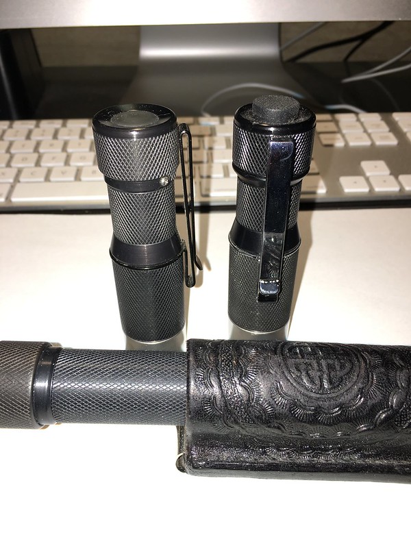

I got a couple of these from Neals Gadgets, look the same and reamed them out a little for proper fitment but when I put it between the battery tube and head as shown, I got the error flash. Not a big fan of messing with the contact wire but what did you have to do to it to make it work?
The clip should go between the battery tube and the tail on a clicky.
Nothing should be put between tube and head. If you have a Rotary you can put it between the bezel and head, but you'll need an extra o ring between the reflector and ring, as I remember.
First let me say if you mess with Henry's design and break it please take full responsibility and pay him to fix it. What you have to do is not a big deal. The contract spring needs to be stretched up a hair or two so that it contacts the copper outer trace on the head plate. If you'll look the spring is not straight out of the body it has a bend so that it can be fine tuned to achieve this. Make sure you open the internal diameter of the clip so that it sets against the shoulder of the body beneath the o'ring. Then you must stretch the spring a Millimeter or so. No more. Take your time and screw on the head to check if it works then stop your done. Hope this helps.
HDS clip install by William Hill, on Flickr HDS clip install by William Hill, on Flickr

I put clips on both the clicky and the rotary without any issue. The clip fits beneath the o'ring and the head screws on just as before. The thickness of the clip causes the sensor spring to loose contact with trace and needs to be longer by a hair. The light is as water proof as before and works as always. Henry's design can't be beat.

Hey, it worked! Not much of a deal at all to move that wire just a tad. Yes, not something I imagine Henry would be in love with doing but I had a spare tube laying around and figured, Heck, what could go wrong? :sssh:
Thanks for the tip Whill! I'm gonna leave it on and use it!
