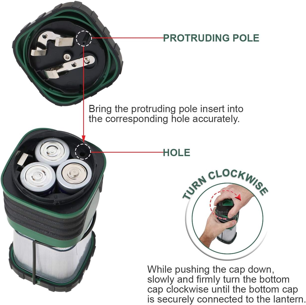

AYL Starlight 700 1300 Lumens LED Lantern, which takes three D cells. I also have a couple of three D cell Maglites. All are are mainly used for emergencies.
I am concerned that the Energizer alkaline cells, which I keep in them, may eventually leak. I was considering Li-Ion D cells. Any thoughts?

@WarriorOfLight I did that with our old Streamlite Waypoint. It takes four C cells. We'd have gone broke using primary cells as we used it every night. I got one to one adaptors and it worked fine. With the three to one units, which I have, I'd have to get 27 Ni-MH AA cells and then they'd just be sitting there, unused for the most part. Honestly, now that I'm really thinking about it, I'm probably better off sticking with the Energizers and checking/testing then once or twice a year.

three D batteries is just over 180mm
Two 26800 Li-Ion with a 20mm dummy cell or extension would work.
Doesn't Five Mega have various extensions
Well, that might work for the Maglites but the lantern has them side by side. Also, I got nothing but lottery sites when I searched "Five Mega".
