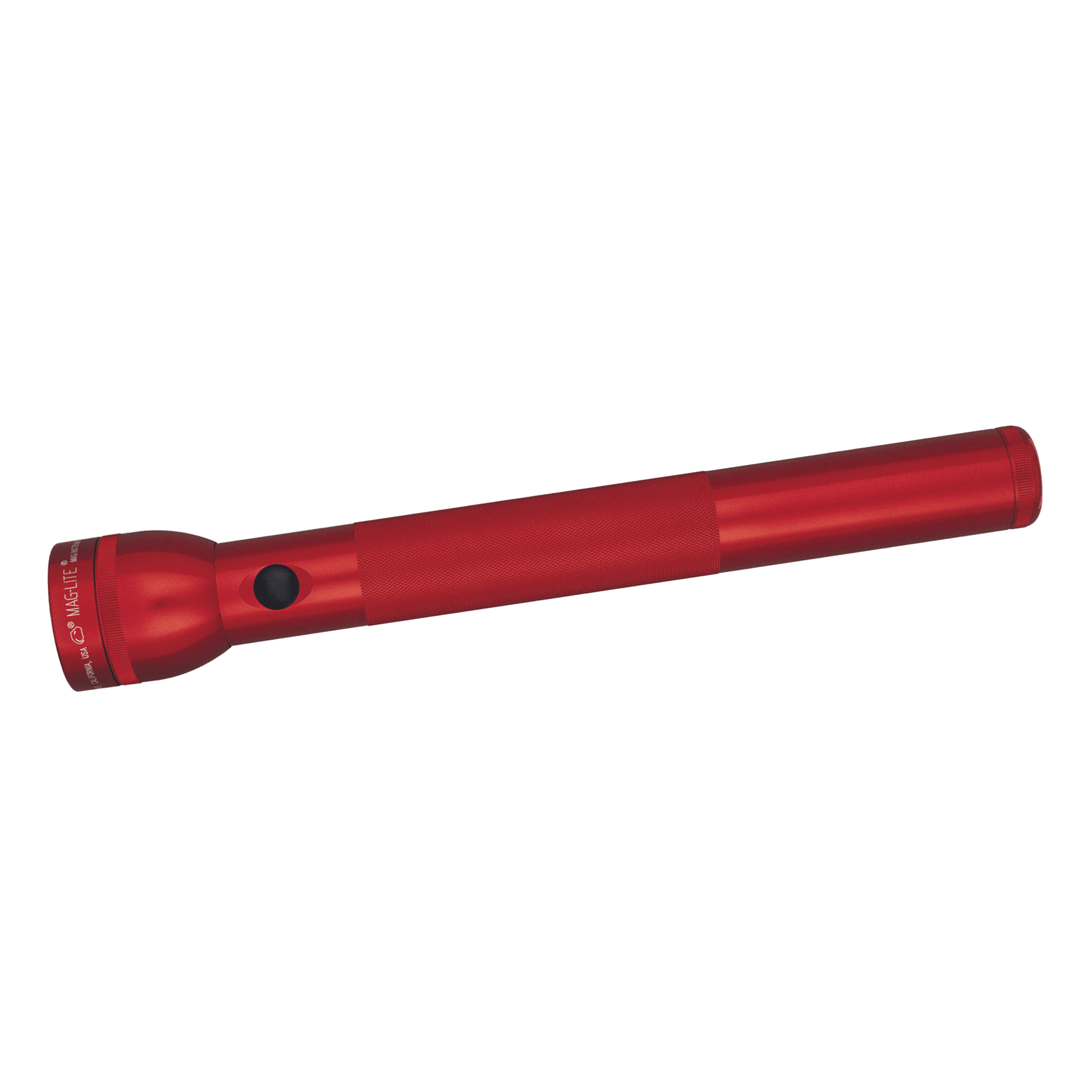

My understanding is that you want to use pair of 18650 cells end to end in a 3D Maglite.
It is possible to make and I do have them but why not using pair of 26650. They are same length but much more capacity compare to 18650.
My decision, as it stands right now, is to go with one-to-one adapters for the lantern. Those are working just fine in the two radios and the spotlight and have for years. Nevertheless, I think I’m getting bit by the infamous Maglite upgrade bug 😁.
@Schokokeks , for the hell of it I tried the three one-to-one adapters in the Maglight. They worked great and yeah, it was a lot lighter. Interestingly, I noticed the D cells were Duracells. I haven’t bought those in years so I checked the date. 2016! No leaks and they still worked though the light was a bit dimmer than with the freshly charged AA Ni-MH cells. I kept the Duracells out of the light, JIC. I’ve pushed my luck pretty far with those and I really like that flashlight.
@fivemega 26650s would make more sense, however I defaulted to 18650 simply because I already have two spares (for my Wuben L50 and L60 lights). I’d have to buy two 26650 cells. My NiCore i2 will handle 26650s, so a charger’s no problem. This I have to think about.

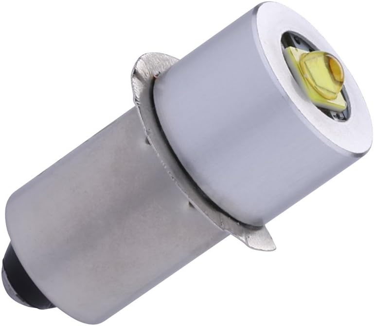

You’ll excuse me if I sound a bit ignorant; electronics are really not my forte. With that said, my question is as follows; if three D cells have a combined nominal voltage of 4.5 and two 18650s or 26650s have a combined nominal voltage of 7.4, wouldn’t the emitter need to be upgraded in my 3D cell Maglite? I mean 7.4V is approximately the equivalent of a five D cell Maglite’s voltage, no?
My next question is, if I do go with the two 18650s or 26650s and I have to upgrade the emitter, would the light be any brighter?
This could turn into an expensive proposition, which is something I'm trying to avoid.

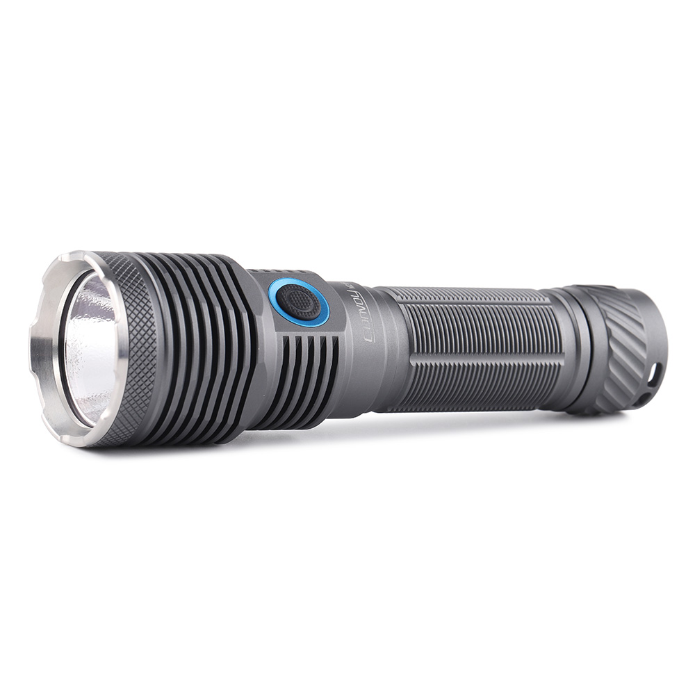

Yes, it will all the sudden get expensive just to run li-ion in your mag. up to 9v (8.4V to be exact)
= Perspective =
this M21F choosing SFT70 emitter in 5000K, adding a Samsung 21700 to the order is $34 total~ delivered in about a week.
..it has a Type C port to charge @ 2A if you want to do that.
@orbital thanks for going to that trouble. That’s a helluva light for the money. If I was looking for a new light, I’d be on that like flies on 💩. I was also thinking that, for a few bucks, I can get a better light than the Maglite. Hell, my Wuben L50 is better by far and all the way around. As a matter of fact, the L50 replaced the Maglite and our Streamlight WayPoint as our daily go-to, let the dogs out at night, light. FYI, we live rural. No fences and lots of critters in the woods, some nasty, thus the nightly flashlight use.
Looking at it logically and practically, the Maglite works as is. It’s an extralight, which doesn’t get used much at all. I need new batteries for it regardless (those expired in ’16), so I’d pop for some one-to-one adapters and a few AA Eneloops just to get rid of the disposable, potentiallyleaking, D cells. Almost every battery operated device in our home is now on Eneloops, I might as well go all the way. Not to mention that I have to start replacing my Ni-MH cells as some date back to 2014. They don’tseem to last as long, are taking a while to charge, and self discharge fast. I’m assuming they’re just old.

@orbital nice light. Did it get noticeably brighter? BTW, my 3D is red also; matches my truck 😁.

That's not my light, just posted a 4D for reference purposes.
Meaning, there are ways to have huge runtime using Li-Ion in a Mag w/ LED ~~~not needing all kinds of adapters/spacers/
also being much lighter.
three 26800 = 242mm (using 1mm magnets between two 26800s' for connection)
four D batteries = 245mm
~3mm difference is nothing
