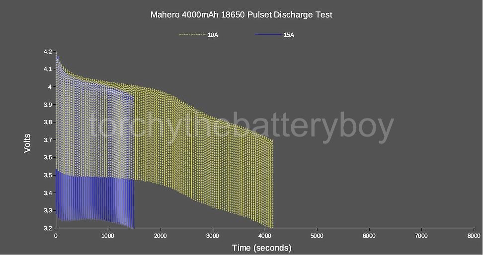

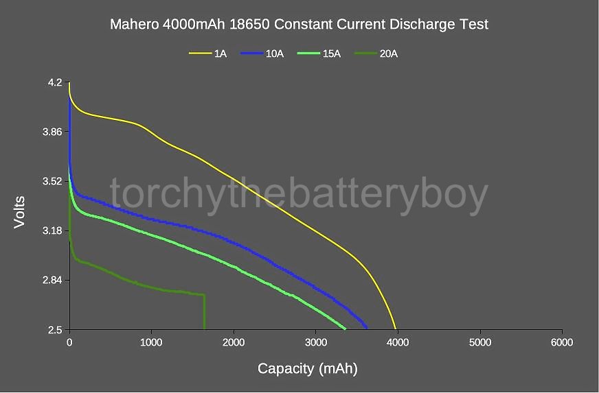

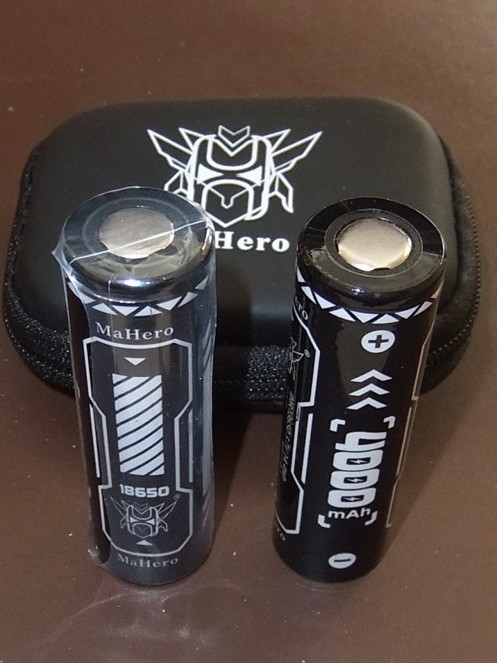

Another 4000mAh 18650, this time from Mahero. I expect these are the same cells as Enook and Vapcell, Actual capacity measured at 4090mAh. This time I thought I would check how much current they would deliver. And I was surprised. They were going along quite well at 20A, but temperature protection kicked in at 72.5°C. They do a pretty good job up to 15A continuous current, and could be used for vaping up to 15A also.
