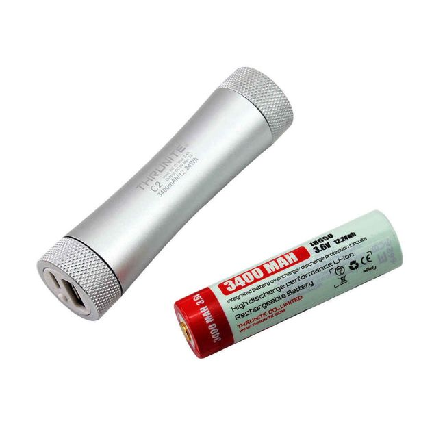

ThruNite made a C2 portable 1x18650 battery charger. It's been discontinued, but several reputable forum supporters still have inventory, at the original price of $20. It takes an 18650 cell, and can operate both as a charger and as a powerbank. (Search "ThruNite C2 Mini 3400 mAh Compact Charger").

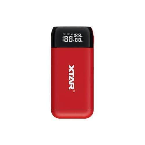

XTAR makes the PB2, a 2x18650 portable battery charger / power bank. Price is $15-25, depending on the seller. Several colors available. The cover lid is magnetic. It stays firmly on until you want to open it.

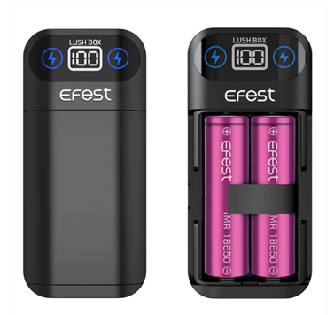

Efest makes the Lush Box, also a 2x18650 battery charger / power bank. Price between $15-20, depending on the seller. The cover lid is magnetic. It stays firmly on until you want to open it.
I have that Efest charger/power bank. pretty good, I also bought a 18650 case for 5 cells with fast charging and wireless charging, looks great on paper, but somehow the power meter seems miscalibrated, when i plug something in it, at first it seems like it discharges slow, and there is plenty of power left, but after around 55% it suddenly drops to 0. I have 2 of them both doing the same thing.
