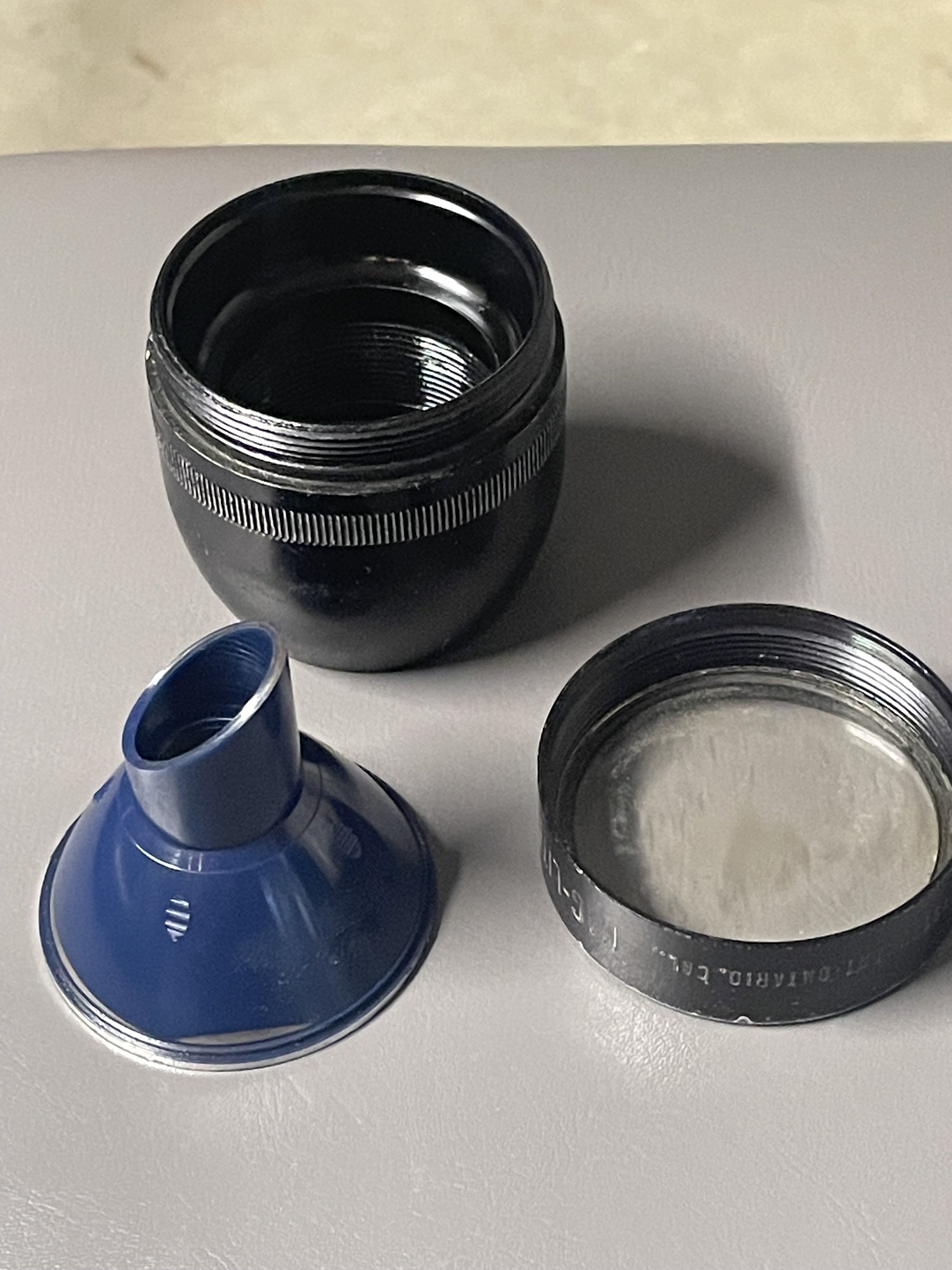

Rightmost was made in April of 1980 and it's the original design. The switch cover will be the large old style, and there are other differences I don't think get talked about much. Original reflectors from that series have a much steeper pitch to the cam. Many are also black plastic rather than blue, although they may be 100% silvered so it's hard to see. The tailcap spring should also be fat, or barrel shaped with a smaller contact tip winding.
You weren't kidding, this reflector is cool looking. Definitely different than the standard Mag reflector. And the head has that same dished out shelf that my 1983 3D does.
And the overall construction is much, much more robust.
@ABTOMAT I'm puzzled, my light has the 1/4" gap at the focus ring, "PATEN PENDING", large switch button, long grip section. It should be 1979 per Jason's website, BUT the serial is in the 19000's which seems to date it 1980 like you said. Hmmmmm.
Edit: Sent Mag the serial and they confirmed a born-on date of April of 1980!
Some people call them "1979" models but it's more like "began in 1979." The first-year design ran until about June of 1980 when they redesigned the switch. Numerically, more were made in 1980 as best I can tell.
