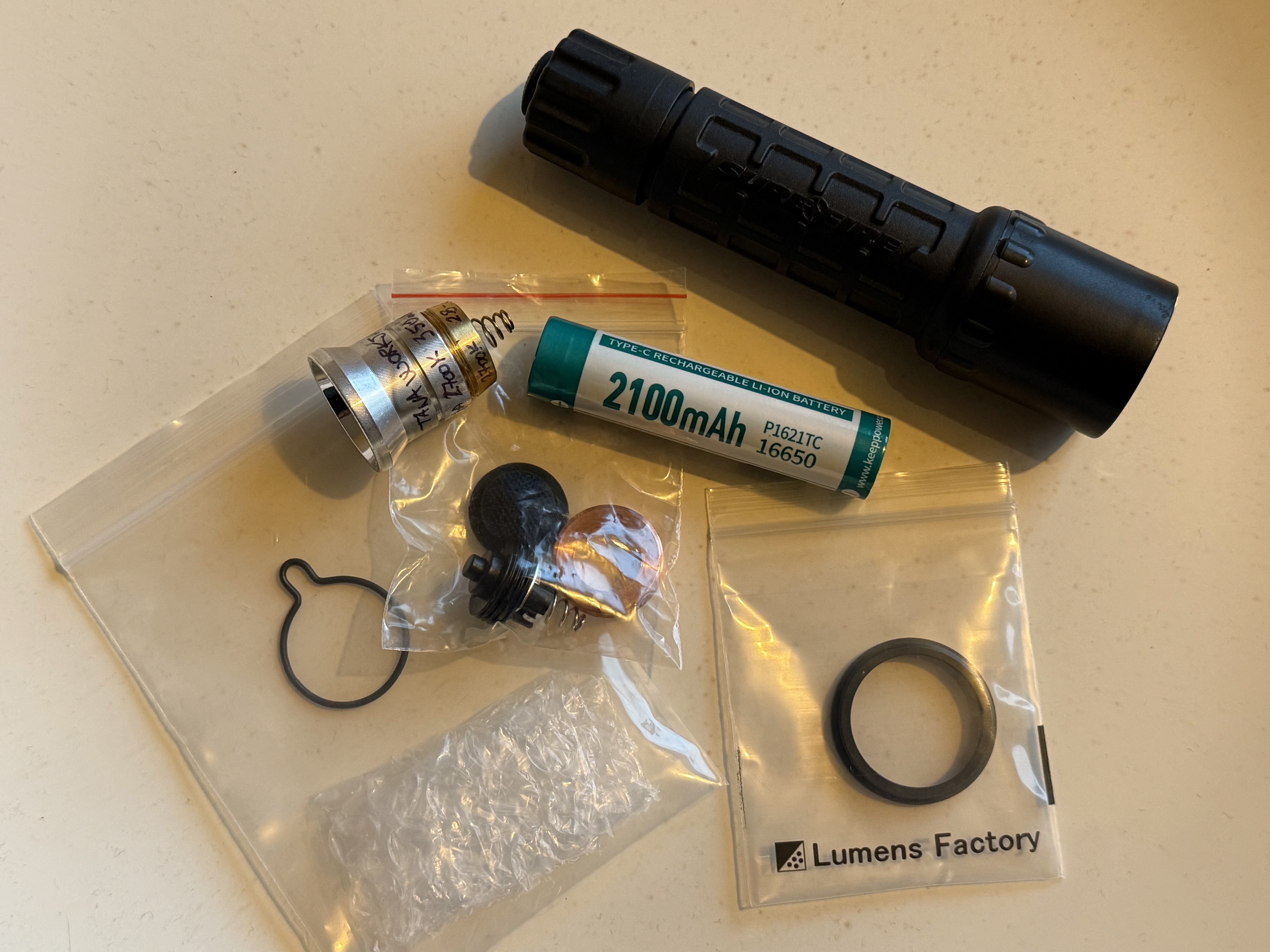

Upgrading old G2
is the Tana locked to a sustainable brightness? The G2, even with a metal head, tends to trap alot of heat in the threaded portion of the body towards the head end. Good choice on battery for convenience and fit. You may or may not need the head spring for that particular p60

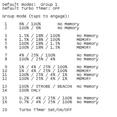

It’s only 350mA so hopefully the heat is not a problem. It’s programmed to 4 levels, 0,2%, 4%, 25% and 100%. Do you think heat will be a problem?
350mA....That should be around 200- 300 lumens? It shouldn't be TOO much of an issue, Malkoff rates his L and LL as suitable for the plastic G's, and his L's run at 300mA for 230 lumens. I guess the only concern would be at max, but even then it shouldn't be too much of a concern

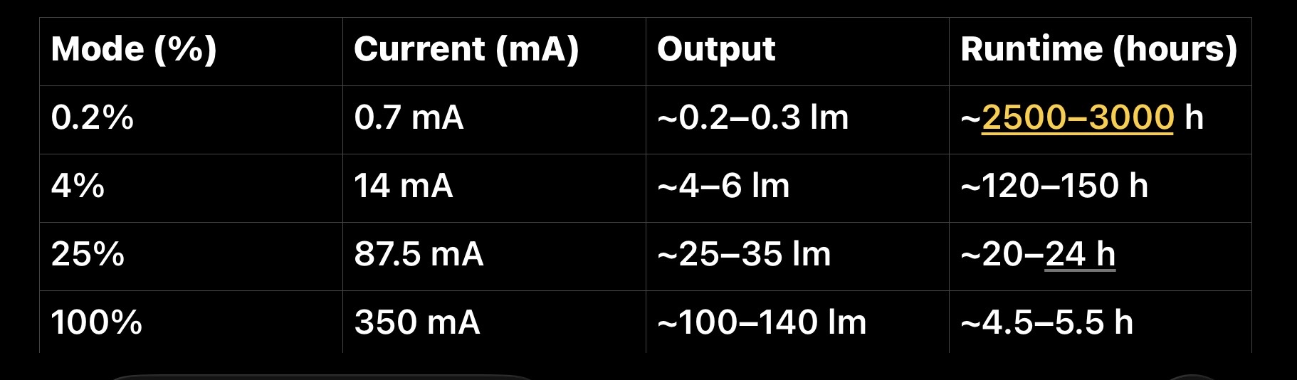

I asked AI to calculate lumens and runtime.

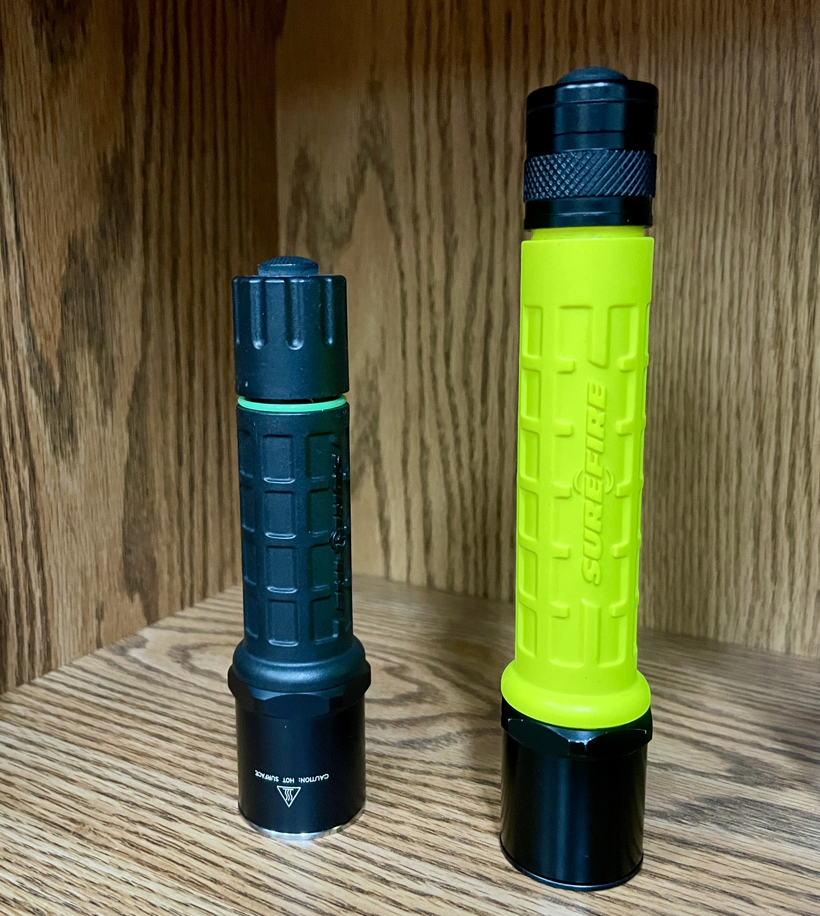

Does anyone else prefer the G2Z over the G2? I owned a half-dozen G2s before I got my G2Z, but I pass up the three G2s I have left in favor of the G2Z. Every time.
I think I have a G2Z somewhere. I will try to find it.
It seems to work but both springs are very compressed because the long battery. What do you mean by head spring?
