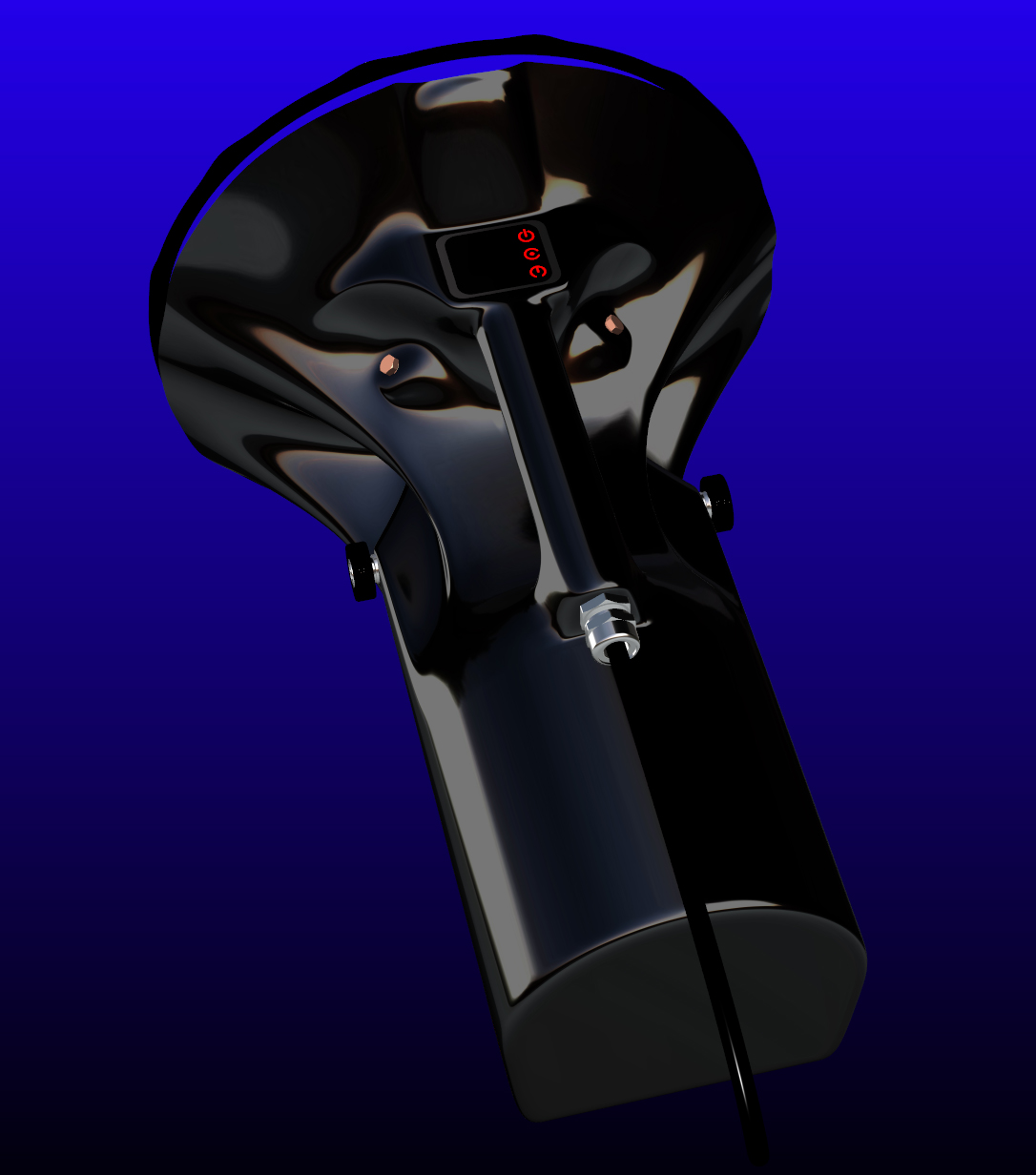

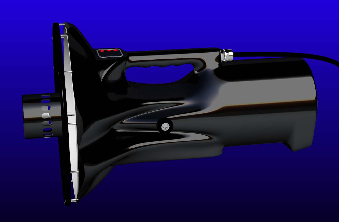

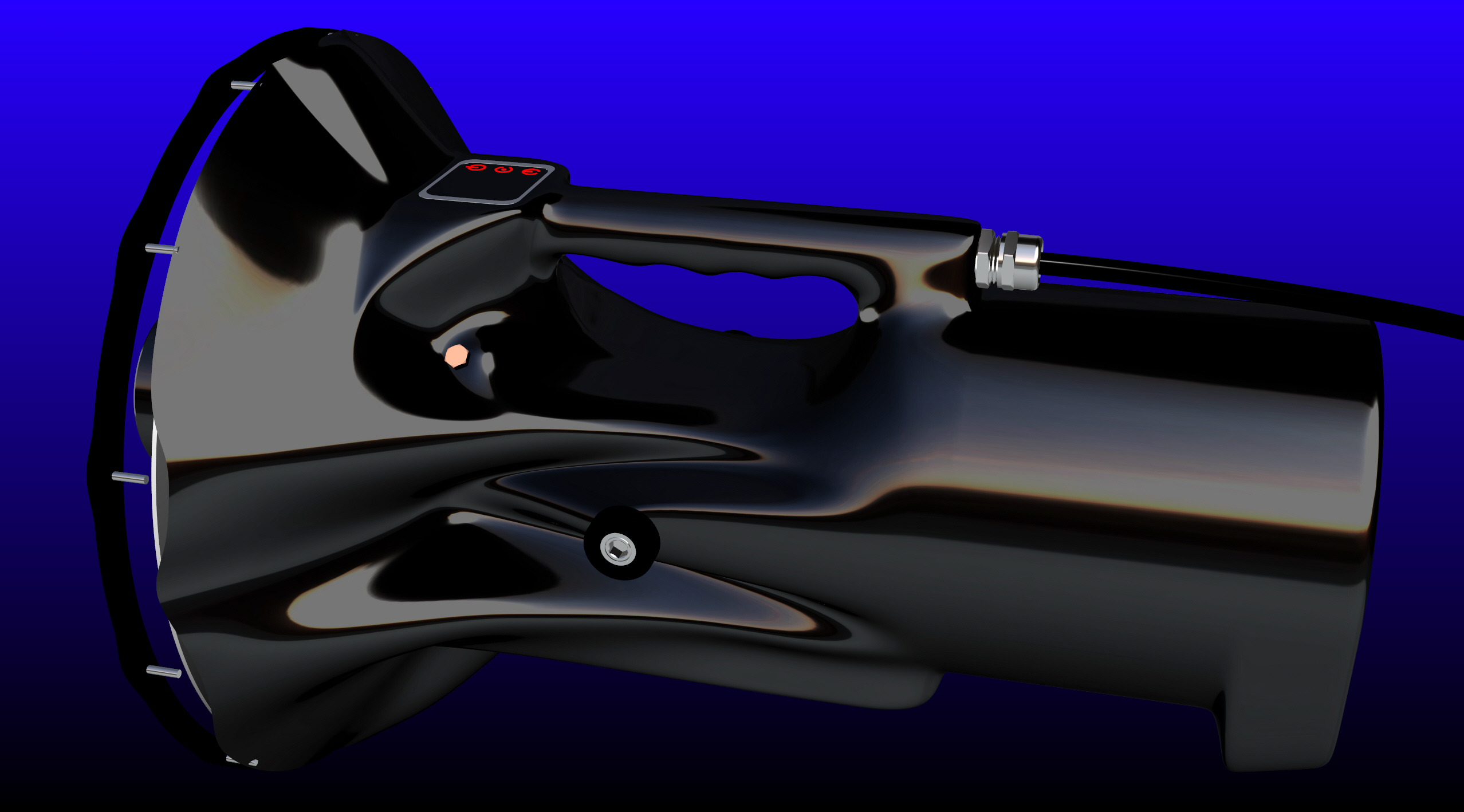

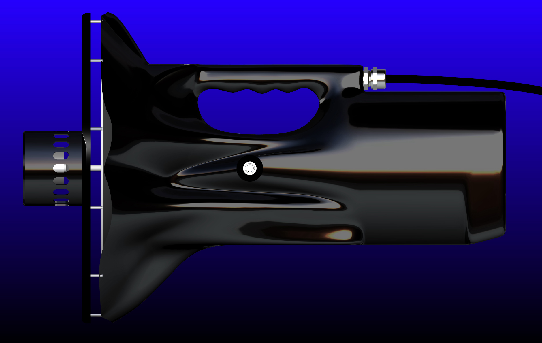

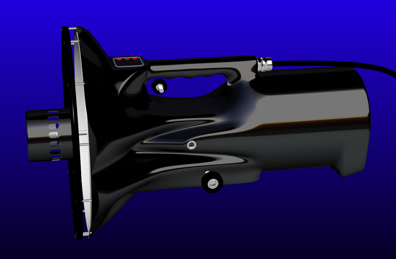

Hi all. Today I've updated the housing for weight-centered gimbal mounts... (click for large)
With allen/thumb screws attached... (click for large)
EDIT: I forgot to shorten the rear intake by 1/2" after testing back in the Spring. Now shortened, above two are still long... (click for large)
EDIT: The housing now has lamp alignment access plugs. These are small black nylon plugs below the controls, but here they are highlighted in copper... (click for large)
(click for large)

Nice pics, it's good to see some new progress.

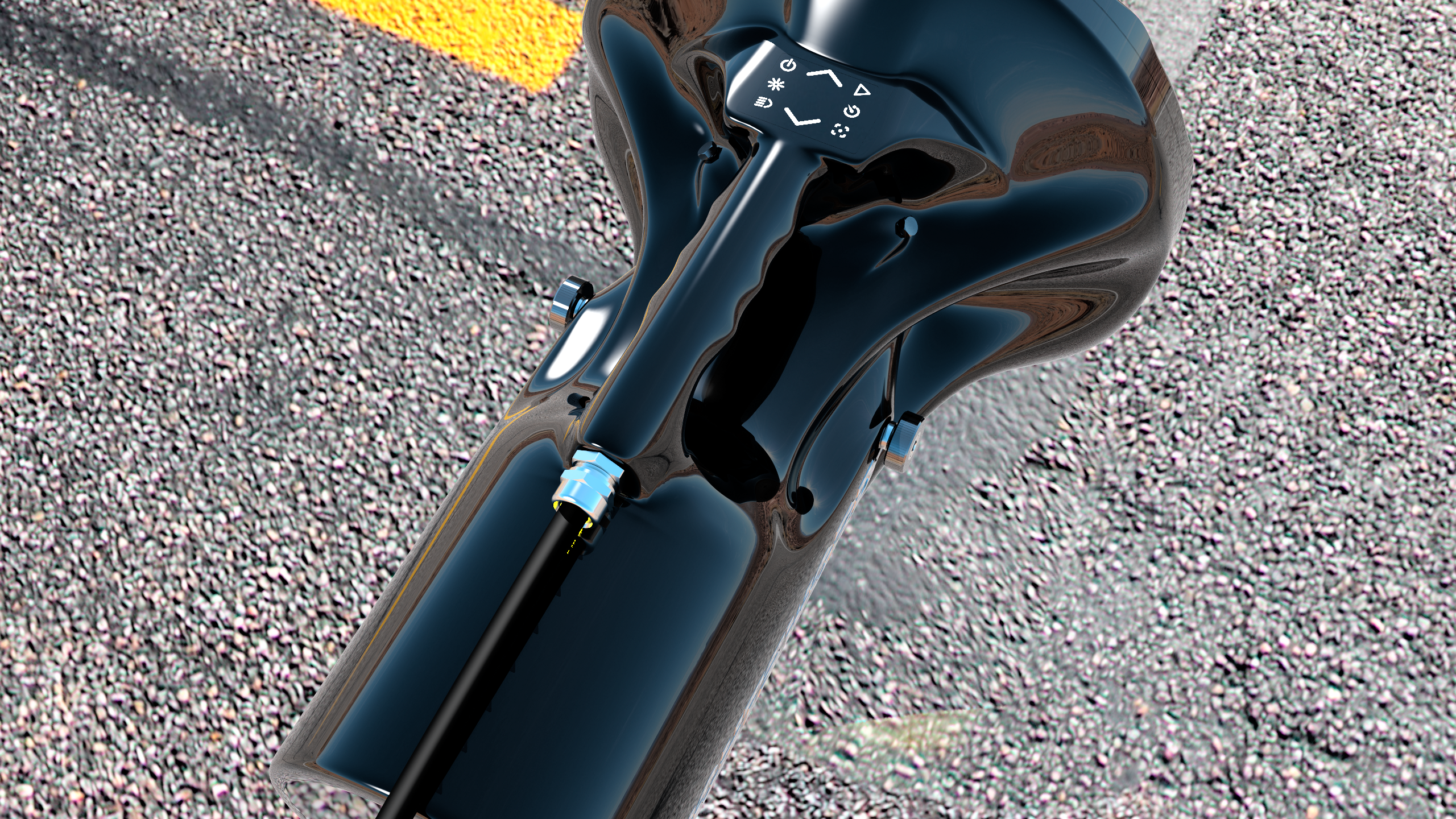

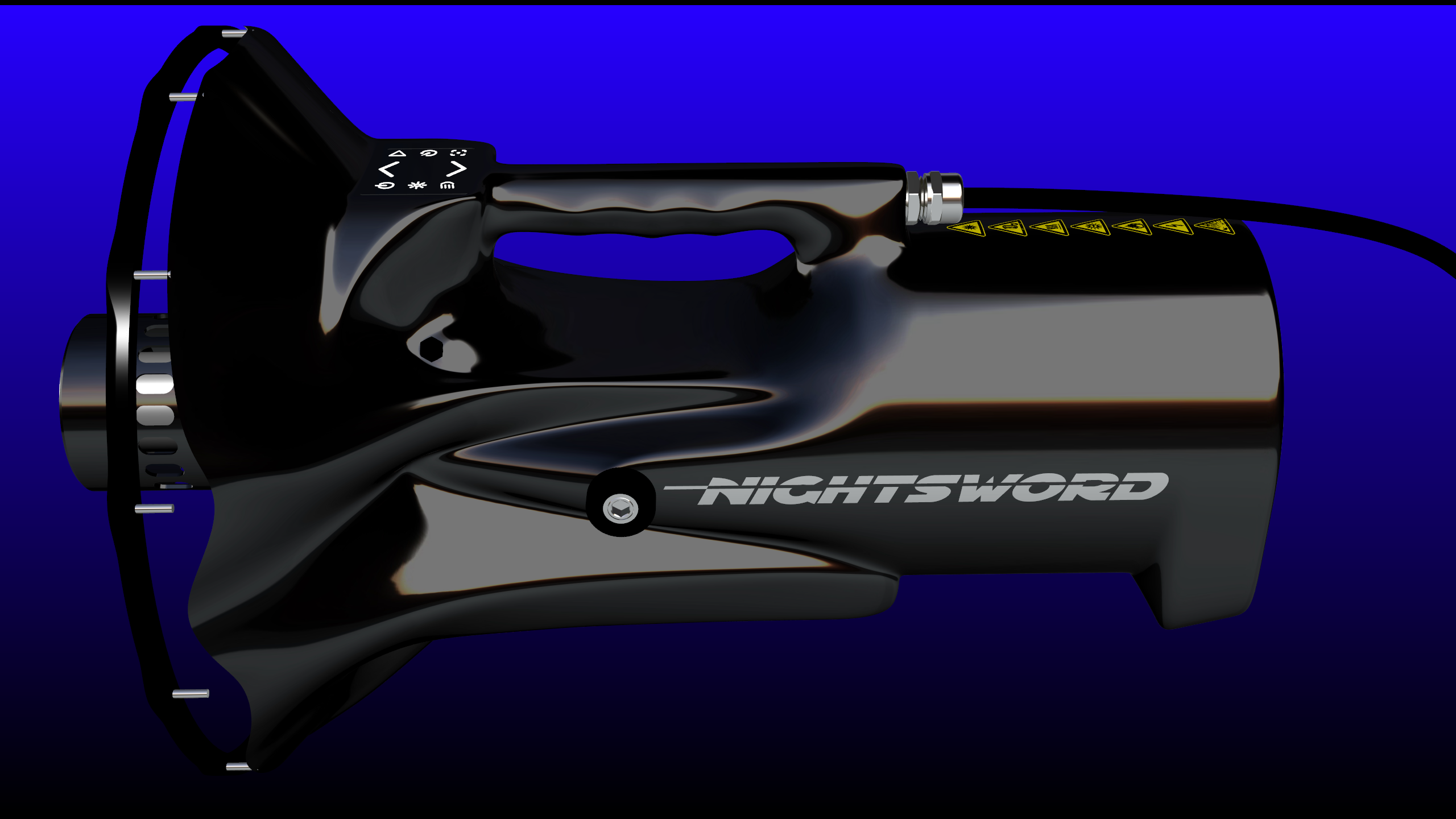

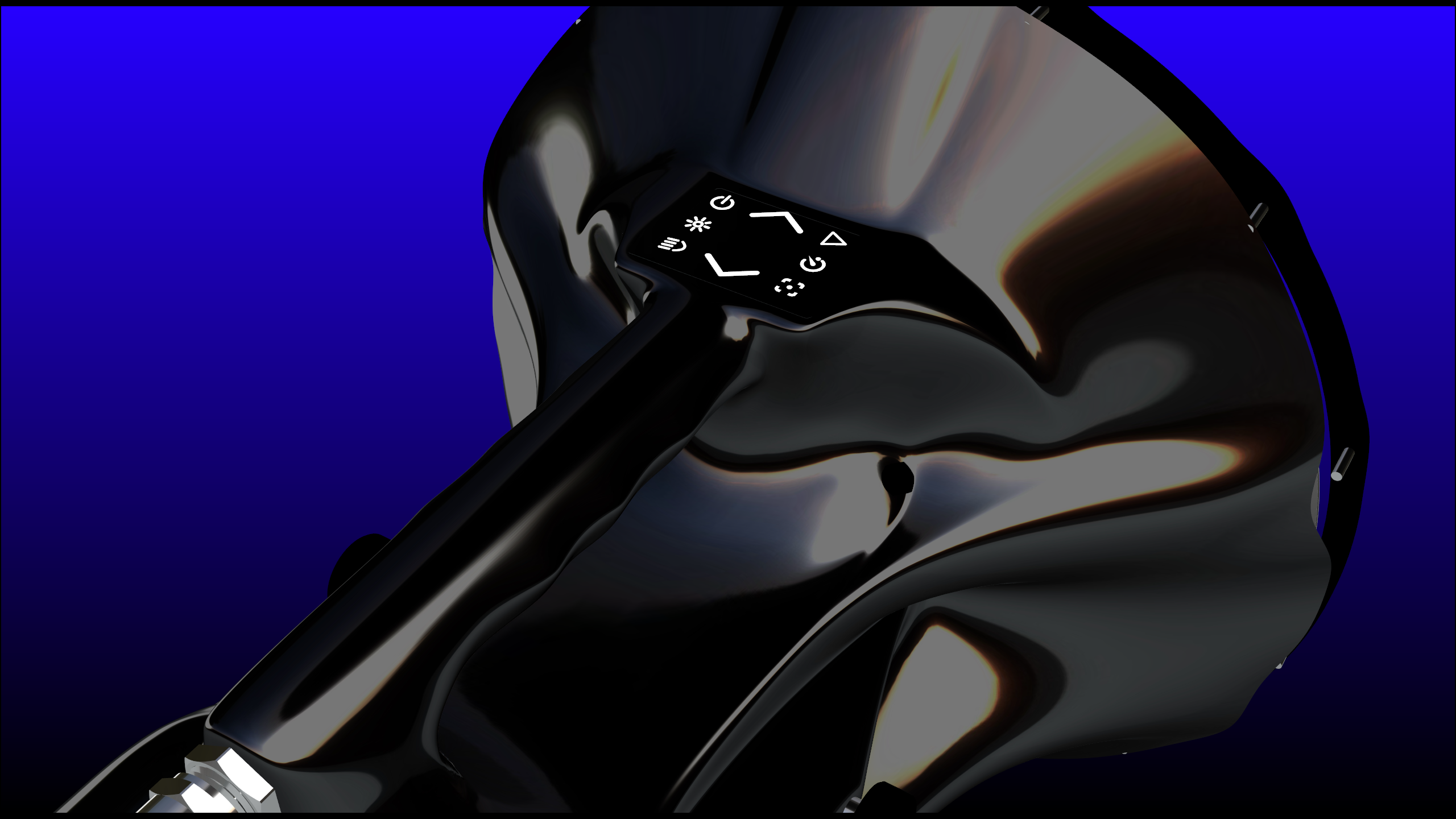

I've ironed out some final touches to the housing before I was able to complete the lens bezel mount, which is the final step of the housing. I've also cleaned up some cosmetic lines. I've also tested stiffness and strength of composites and found that I can easily reduce the housing thickness by 25% while remaining very durable.
Sorry guys, I'm forgoing the digital display. These models reach end of life too frequently and I don't want it to become an issue. I'd also like to reduce electronic complexity. Instead will be a static LED backlit touch screen, with serial connection for the extended non-essential functions.
The static LED backlit display will have left and right columns of buttons, centered with up/down adjustment.
Left side (top to bottom): power, strobe, low power
Right side: play, timer, focus end stop adjust
Play simply repeatedly cycles the beam from spot to wide and return.
The center up/down will serve to adjust beam pattern, focus end stop, timer, and play speed.
Feedback will be via LED back light flashes. For instance an LED flash pattern would notify end of lamp life. Holding down a button could be used to reset lamp.

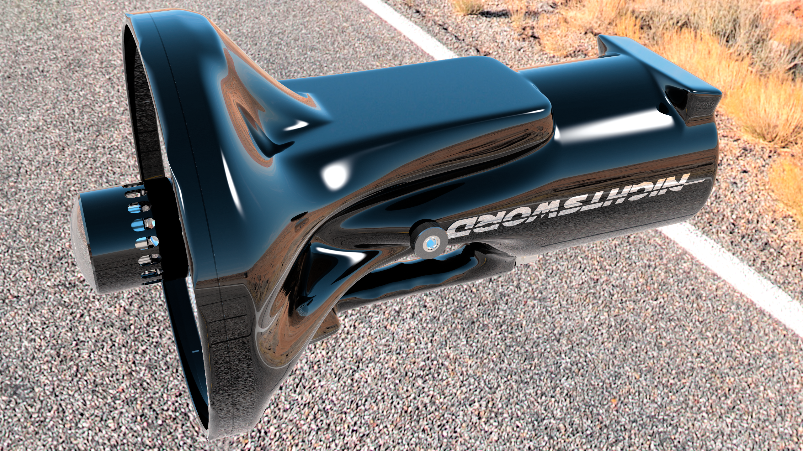

(Click for Large)
(Click for Large)

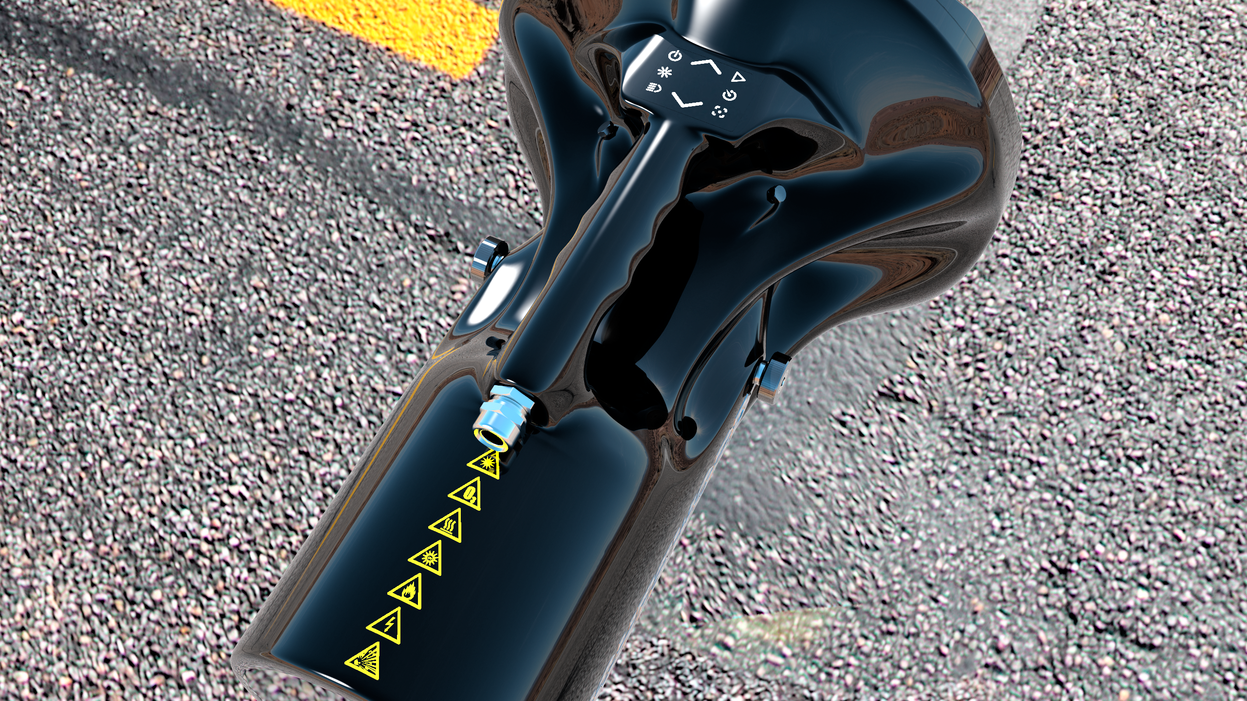

BTW, warning labels are ANSI symbols for bright light warning, ozone warning, hot surface warning, UV warning, fire warning, high voltage/shock warning, and explosion warning. (EDITED)
Regarding the lengthy discussion of graphic decals, at some point in that discussion I realized I preferred to go light on decals and instead enhance the form of the housing. Probably the only decals will be silver mirror logos embedded into the clear coat on the sides of the housing (as shown), and removable warning labels (as shown). I will include a small "CFP edition" emblem embedded into the clear coat as well (not yet shown), but otherwise not likely going nuts with graphic decals.
I also tend to prefer the cleaner look of the black bezel over the touch screen, instead of the stainless steel display bezel.
Taking a break for a few days and will then finish off the lens bezel mount to complete the housing.

That has to be one of the sexiest lights I have ever seen! The smooth flowing lines and the shiny ebony color just scream out, "Eat your hearts out, regular lights!" If nothing else, I am sure you could make a living as a graphics artist/designer. Glad to hear that the end of the process may be in sight. Really want to see some beam shots once it becomes a reality. I don't think I will ever be able to afford one, but I can dream.

I think everything you changed above is a very practical and efficient move. Still looks fabulous! When can I pre-order????

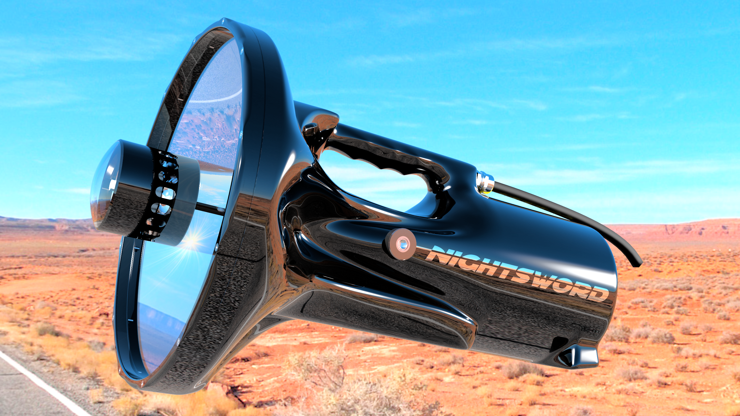

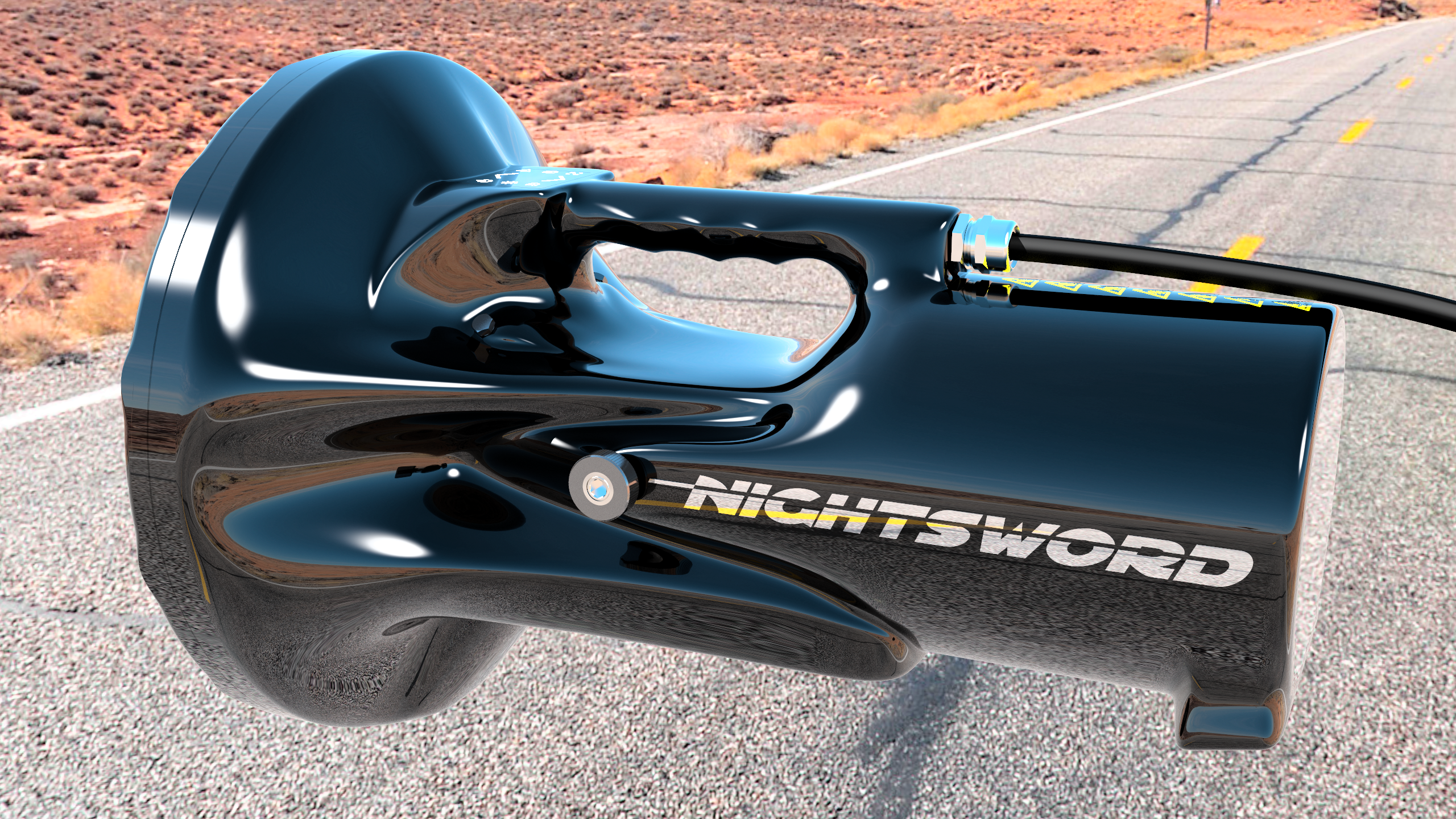

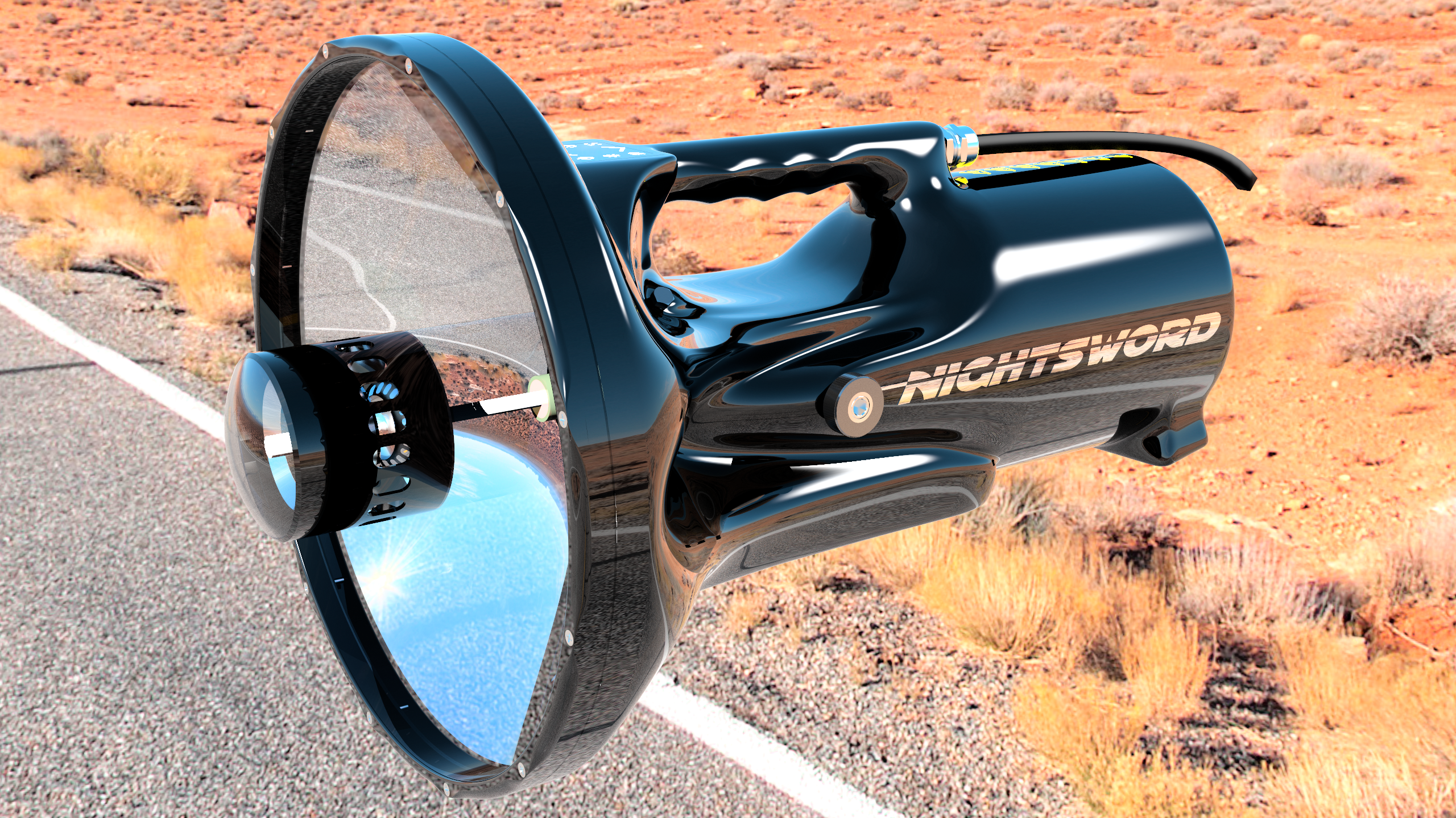

Thanks Lad. Here's proper renders, the others were in editing mode..
(Click for large)
I will update these when the bezel mount is complete.
Edit: bezel mount complete. Renderings updated.

Wow, you have designed a true masterpiece!
VERY impressive work.

I've completed the housing bezel mount and updated the renderings.
Yes thanks Bluenight, this has been covered. Adhesive pads will be used.
Edit - Renders updated. I cleaned up some lines to better blend with the bezel mount. I've also made the bezel deeper, changed up the rear feet, and made a flat ground contact area under the bezel, which is sloped to the rear feet. These can be seen in the upside-down render.
