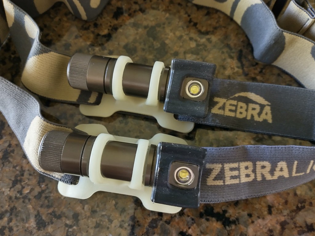

I'm doing inventory of a couple of my bugout bags this morning. Here is a quick shot of the H50-Q5 headlamps I keep in them--simple, reliable, and compact.
