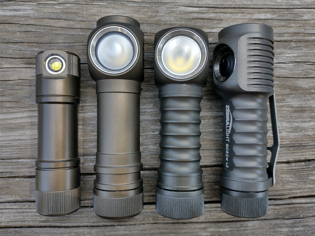

While they're out, a quick comparison of some AA models. Back in 2007 I was shocked at how small the H50 was and, honestly, it's still shocking.
Left to right: H50-Q5, H51fw, H52fw, SC52w L2
Yeah the "w" model is 4500k and lower cri. I had one and didnt like it. The old sc52w was glorious to my eyes. The "c" was I think the xpl2 easywhite in 4000k and higher cri with a 93-95 I think cri 2 step binned emitter. I do have this. They haven't made a "d" model since the sc62 and sc52 I think. I have both. Those were 85ish cri 5000k phillips luxeon t emitters. They also made a sc52 and sc62 "c" model that was also 4000k but I don't remember the emitter, never had one.
Rather than speculate, just go to the comparison spreadsheet on the Zebralight website. All the old models and their specs are there, except for the original H50 and H30.
