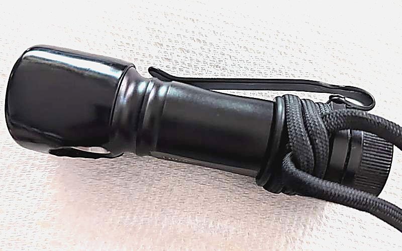

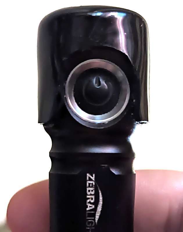

Another advantage to the vinyl cap I've been experimenting with in addition to head drop protection is it also recesses the button further basically eliminating any chance of accidental activation.
There's an o-ring between the cap lip and light rim for added shock absorbtion..

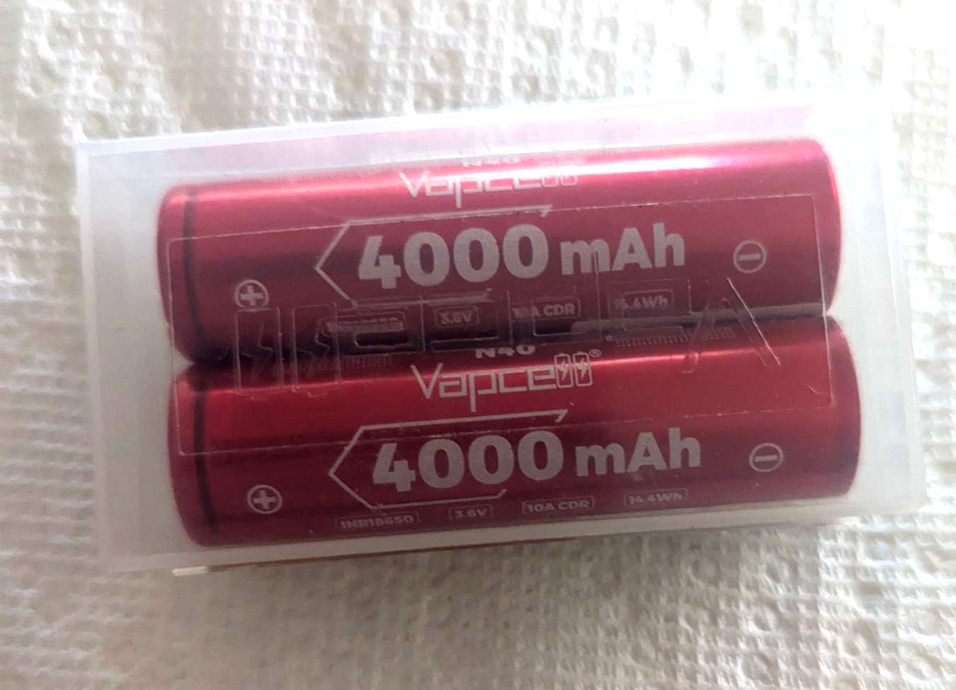

Zebralight 18650 travel charger and spare battery carrier idea:
The Wk03 works to charge flat top 18650. The host comes w a button top that is not intended for the Zebra.

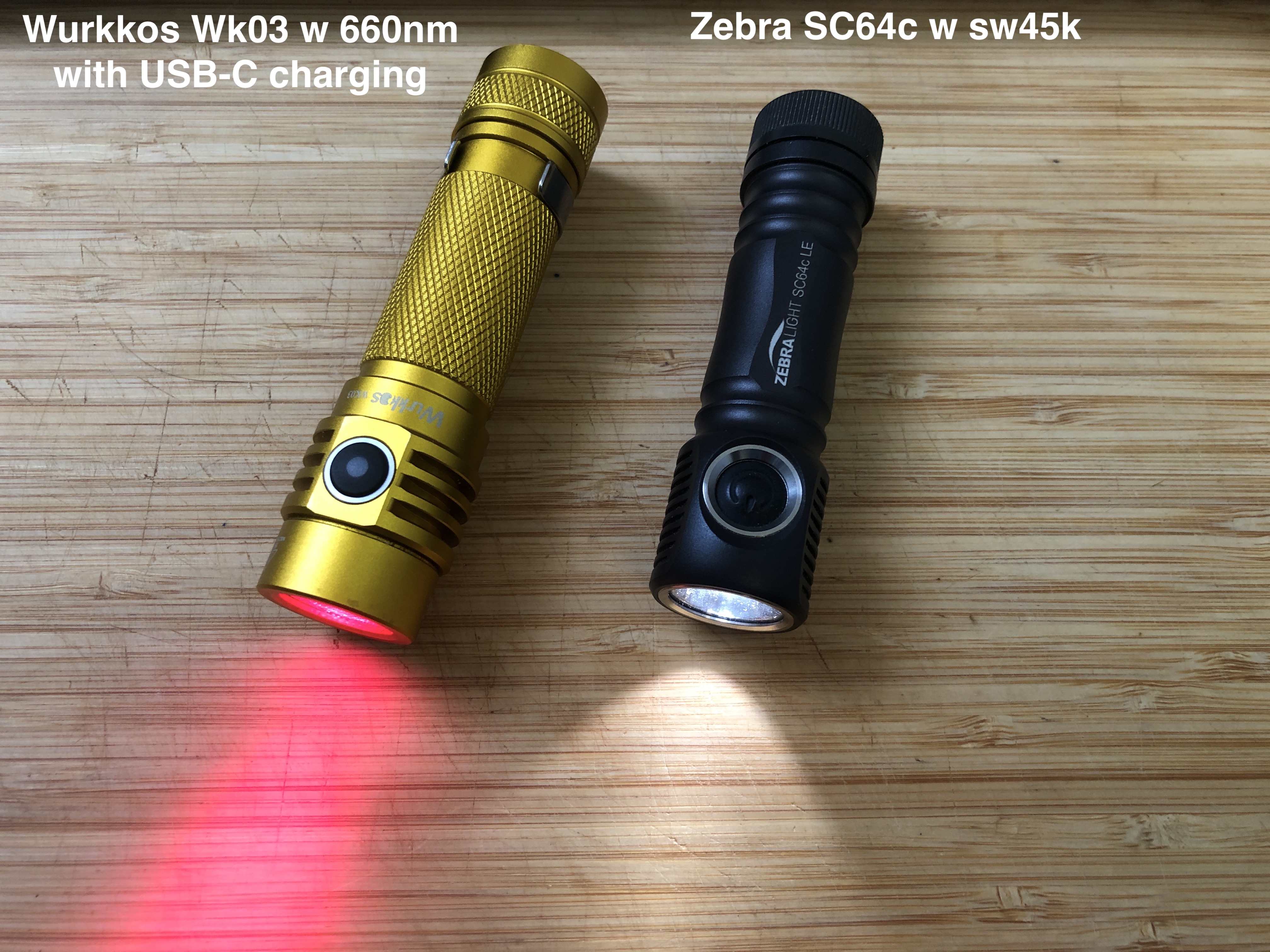

otoh, in cases where I would have to otherwise bring a charger, I would prefer to bring a spare light, that incorporates USB charging, and a Red light channel ;-)

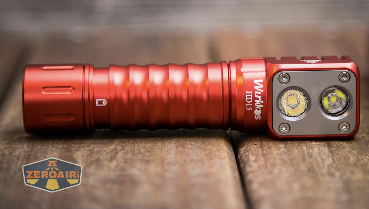

The Wurkkos HD15 has USB and the ability to charge Zebra batteries. Plus it has a Red LED, and can serve as a headlamp.
(pic from this review)

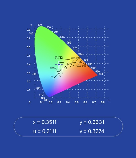

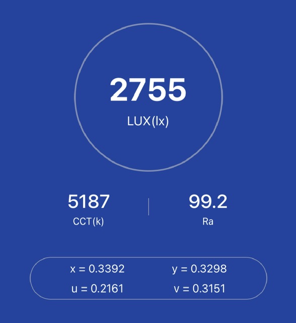

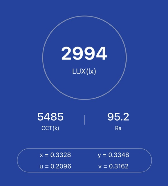

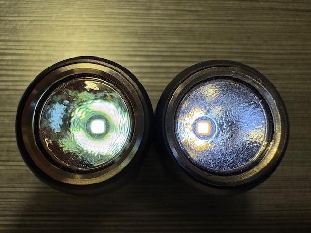

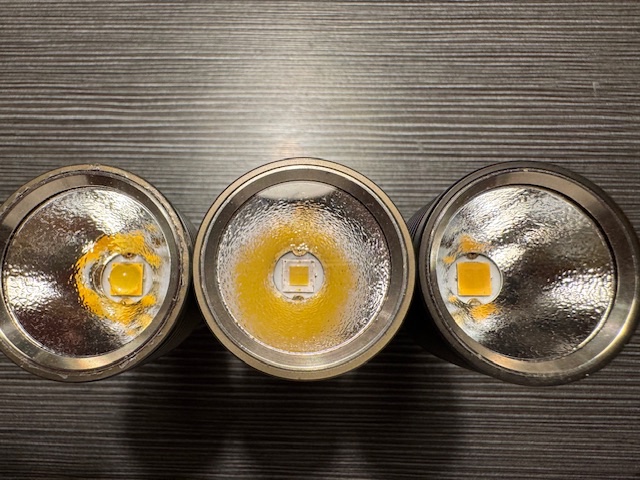

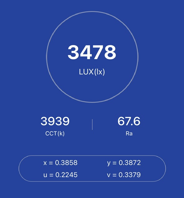

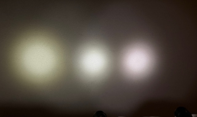

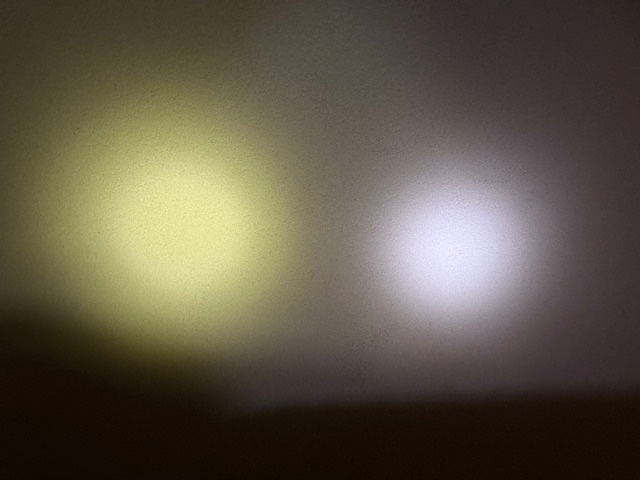

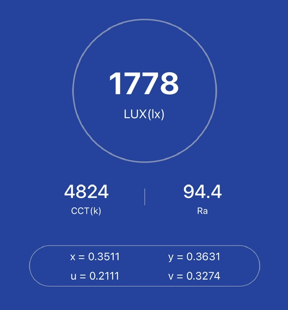

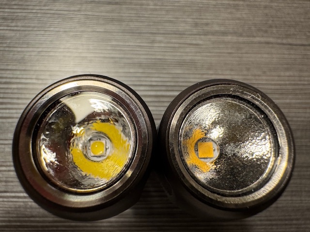

I was testing new emitters made on Fireflies request but not sold by them…
Jackson Lee has some super nice CCT’s
Stock Samsung 351 vs FFL351 “4500”

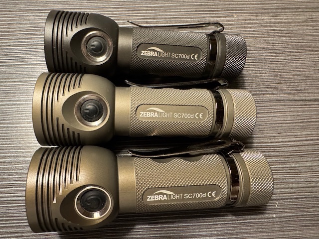

I have had several Zebs modded and my favorite is still the Sc65 with FFL351A. Just ordered the H54 with same. Nice and bright with just the faintest hint of rosey. I think I need to send a few more off................
Thx jon but it was not needed. I can open them without destroying lens. Older models are quite stiff
I admire your modding skills!

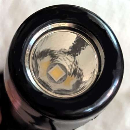

My SC64 is modded by mcbob to sw45k ;-)
he does not offer sapphire, so I ordered that separately
he shipped the light to me with the lens and reflector removed, and I installed a sapphire lens..
(pic of the light w no reflector, before the lens arrived)

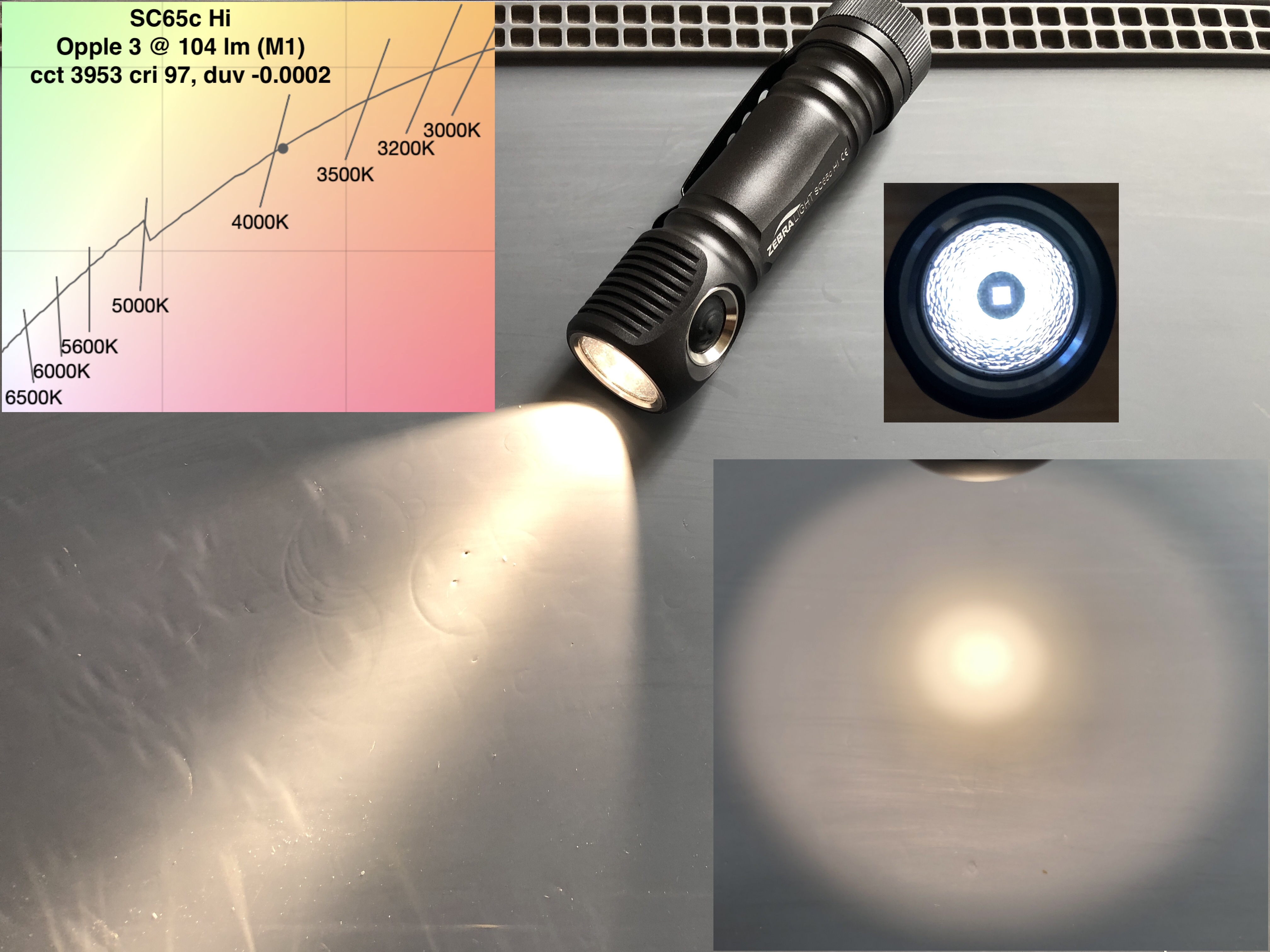

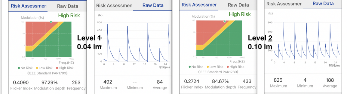

[NLD] Zebralight SC65c Hi

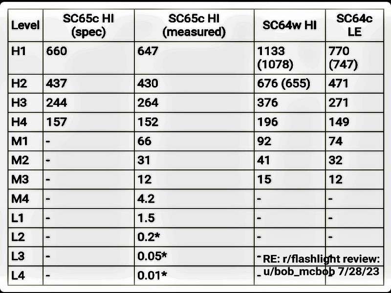

Im happy to say the low mode PWM does not flicker visibly, to my eye. Although the Opple ranks the Flicker Index as High Risk on the two lowest modes:
those two outputs are from my own lumen meter and they match the official specs almost exactly (spec level 1 is 0.03 lm, and level 2 is 0.11 lm)....
Even waving the light on level 1 does not produce discrete dots:
visible flicker was expected based on other peoples reports.. but I dont see it on this one, so I think I won the lottery.. lol

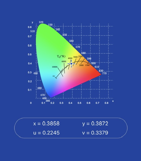

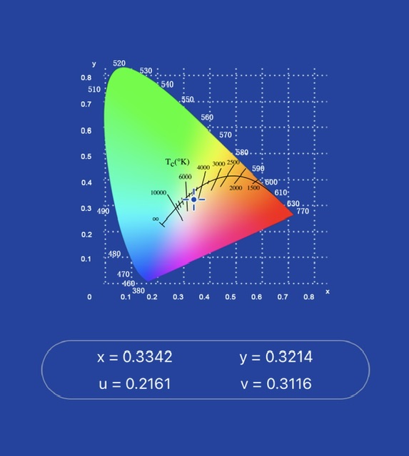

also pleased the Tint DUV is not above the BBL.. looking forward to night time ;-)
outputs on my meter, and my G6 program:
Thanks for the great pics. I believe the vast majority of SC65c HI owners do not see "visible flicker" on the lowest levels, though it may exist on a flicker reading meter. The output on your meter on the highest levels H1-H2 seems somewhat high by most measurements, your readings on lower levels seem about right.

I prefer the SC64c LE driver, it keeps the LED at more Constant Lux, uses a lower Modulation Depth, higher frequency, and lower Flicker Index score, than the SC65:
On Level 1, the SC65c is using slow PWM, at 253Hz, and the Minimum Lux is cycling all the way Off.
Opple 3 Flicker Index tests for all 12 outputs:
agree! ;-)
probably the small LED is overstimulating my light meter sensor

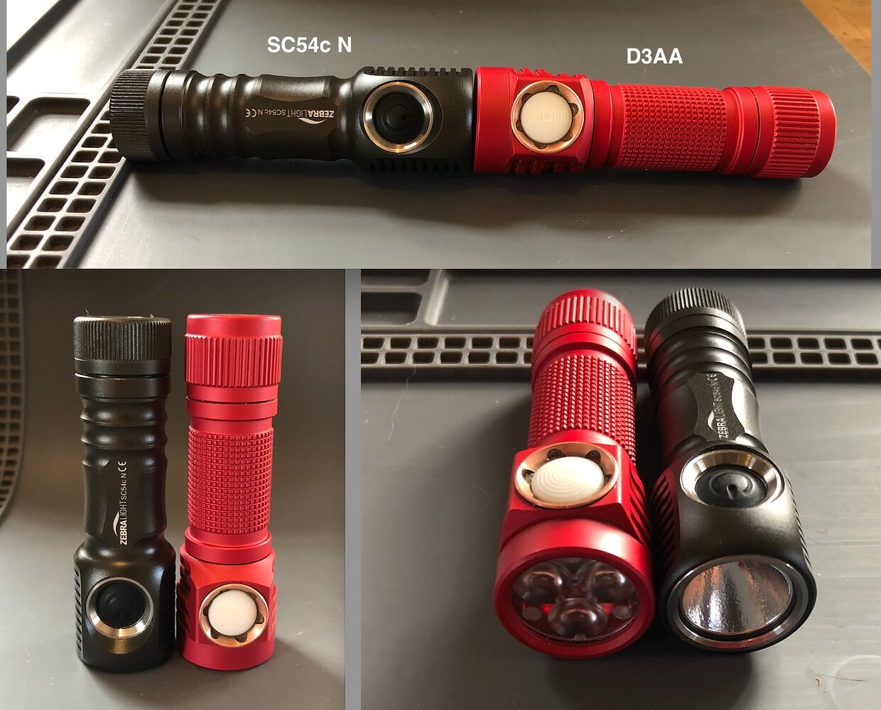

Maybe consider a different brand.. The Skilhunt M150 might be a good alternative. Available with the same LED as the Zebra... and the Skilhunt UI is quite similar to the Zebra, but imo easier to use thanks to last mode memory.
The Skilhunt also has the advantage of being able to use both AA and LiIon (and has built in charging for LiIon).
Another option would be the Emisar D3AA, whose UI is even more flexible. Plus it has Aux lights... but the beam is very floody as it does not use a reflector.
