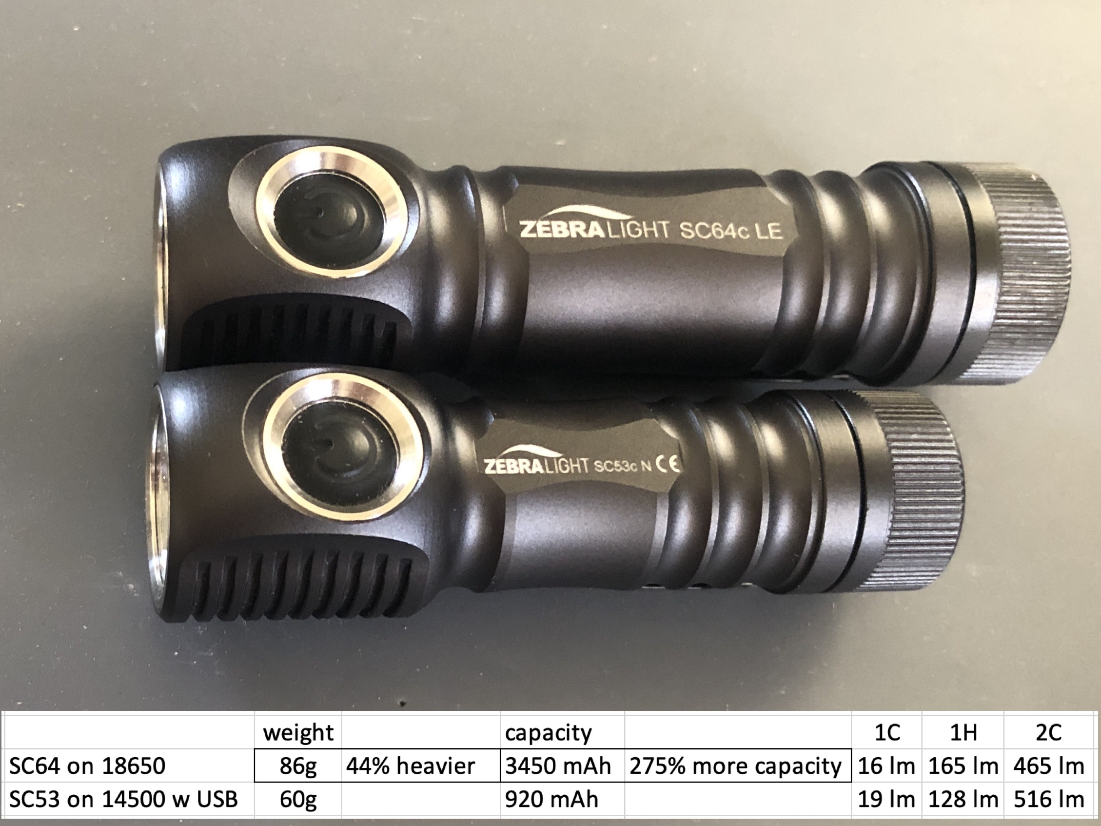

Compare and Contrast SC64 and SC53
SC64 less than 1/2 heavier
SC64 almost 4x runtime
SC53 can use USB-C 14500
G6 Outputs very similar
Both lights use the same lens, reflector, and switch
SC53 head is 0.2mm thinner

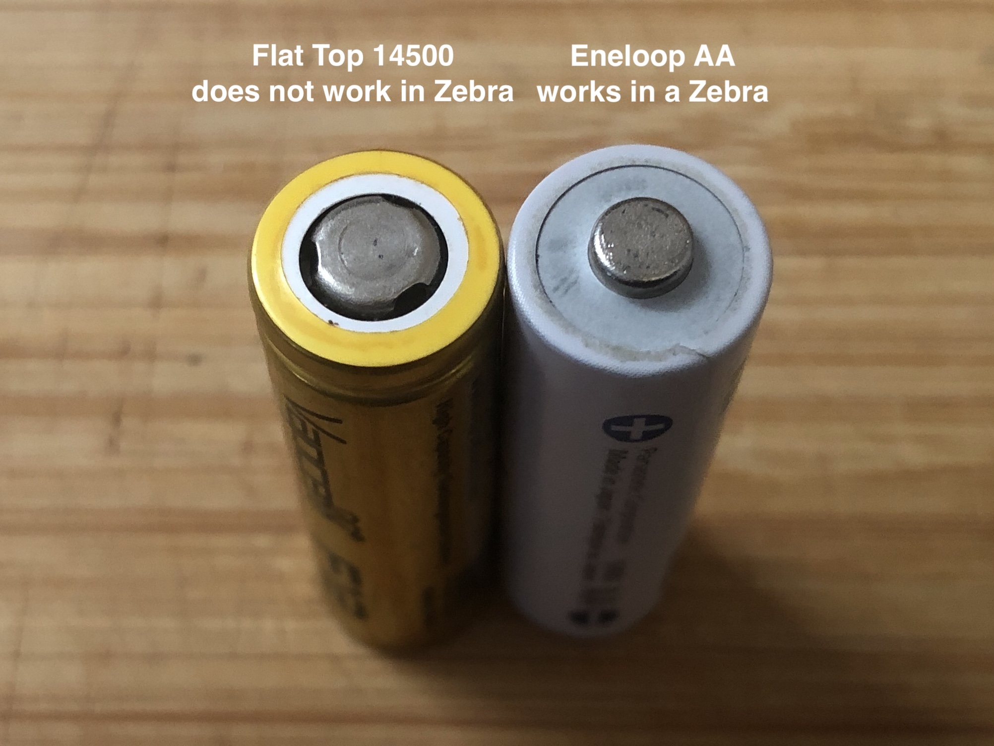

if it is a flat top, it wont work in a Zebra
The Vapcel F12 flat top on left does not work in a Zebra (even though it is shorter than an Eneloop):

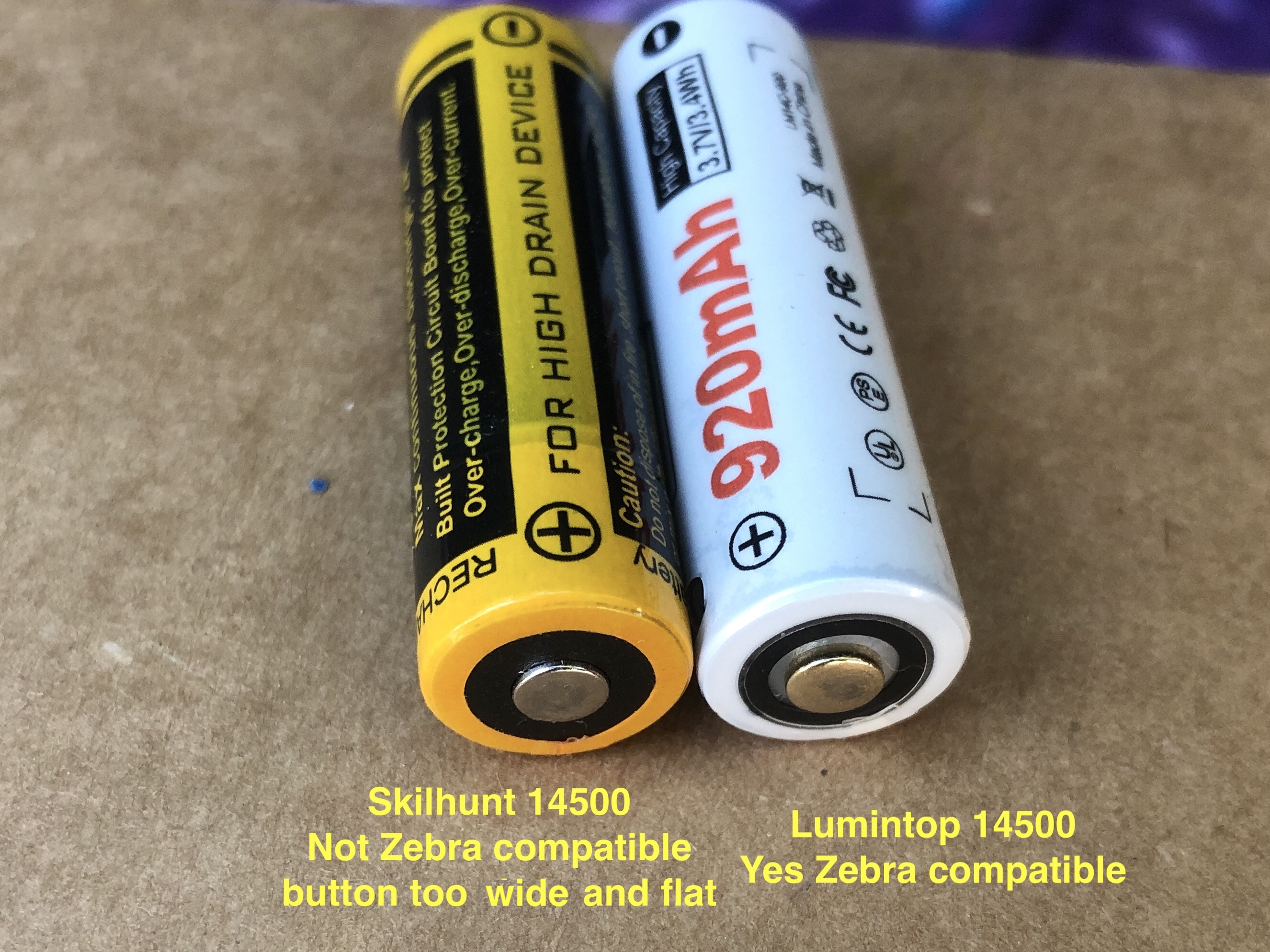

Zebras are also picky about the shape of a button
the Lumintop 14500 button top I use in my 2023 SC53 and H53 are 50.2mm long (same length as an AA Eneloop)
I also have a Skilhunt 14500 button top battery, and though it is the same length, it does not work in a Zebra. The Skilhunt 14500 button is too wide and too flat to get into the positive socket inside the Zebra head:
The Lumintop button is also different than the Eneloop button. The Eneloop fits more reliably. After installing the Lumintop, I sometimes have to reopen the tailcap, jiggle the battery, and reclose, so that the Lumintop button will seat into the Zebra positive socket.

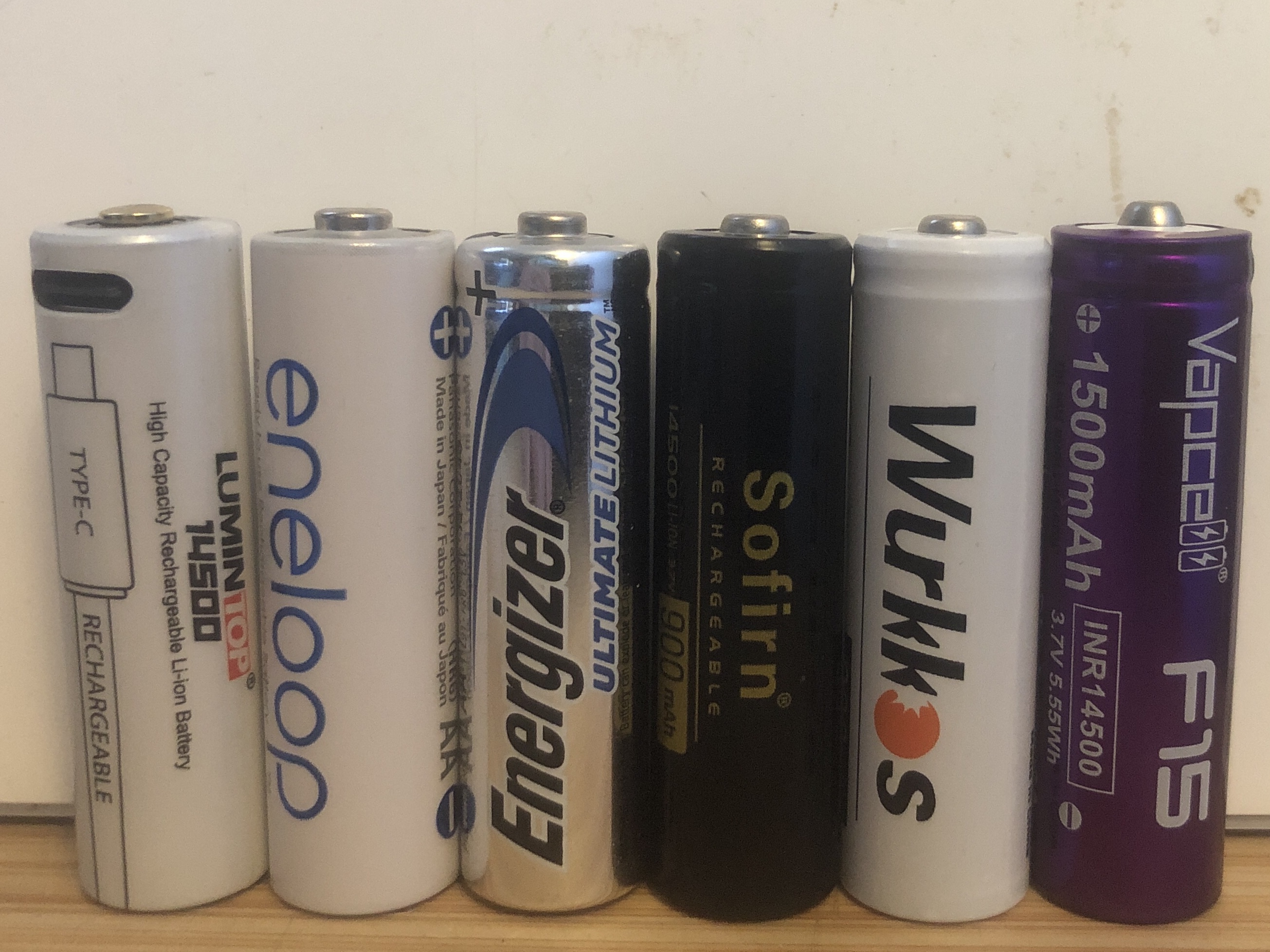

Not a fan of Vapcel button tops, they are longer than an Eneloop.
I think Lips uses button top F12, I have not tried them. I do have F15 button tops, they are a bit long, its a tight fit in my SC53. They can work, but I dont like to use them.

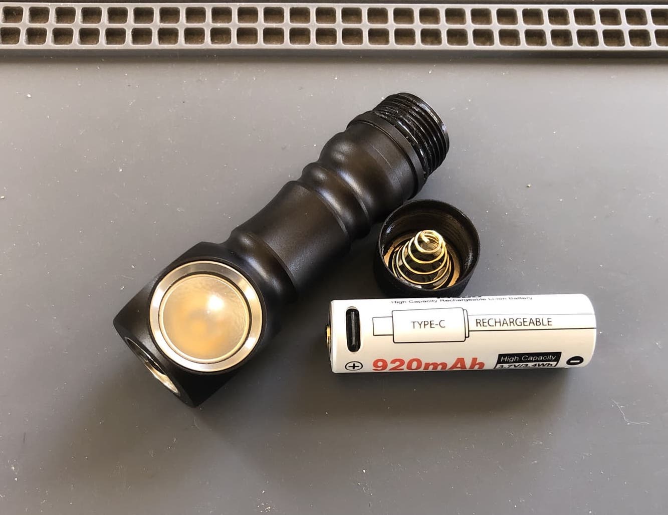

I prefer the standard length of the Lumintop USB 14500 and the convenience of not needing a charger. Ive ordered from lumintoplighting in China.
The USB batteries came inside (free) flashlights, which is legal for mailing. Tariff is paid by buyer at time of purchase, just like a shipping fee.

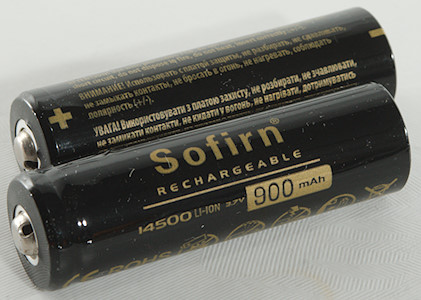

First Sofirn 3A 1000mah button top batteries are almost identical to Eneloops. If you can still find them…
I did not see them online:
