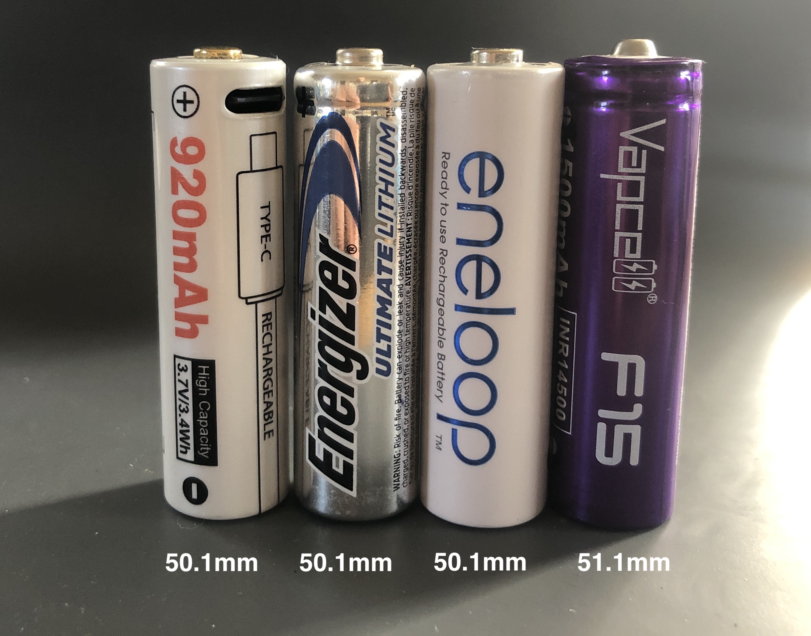

if you want to run a 14500 in it
his H504c model does not support 14500, it uses the new 54 series driver...

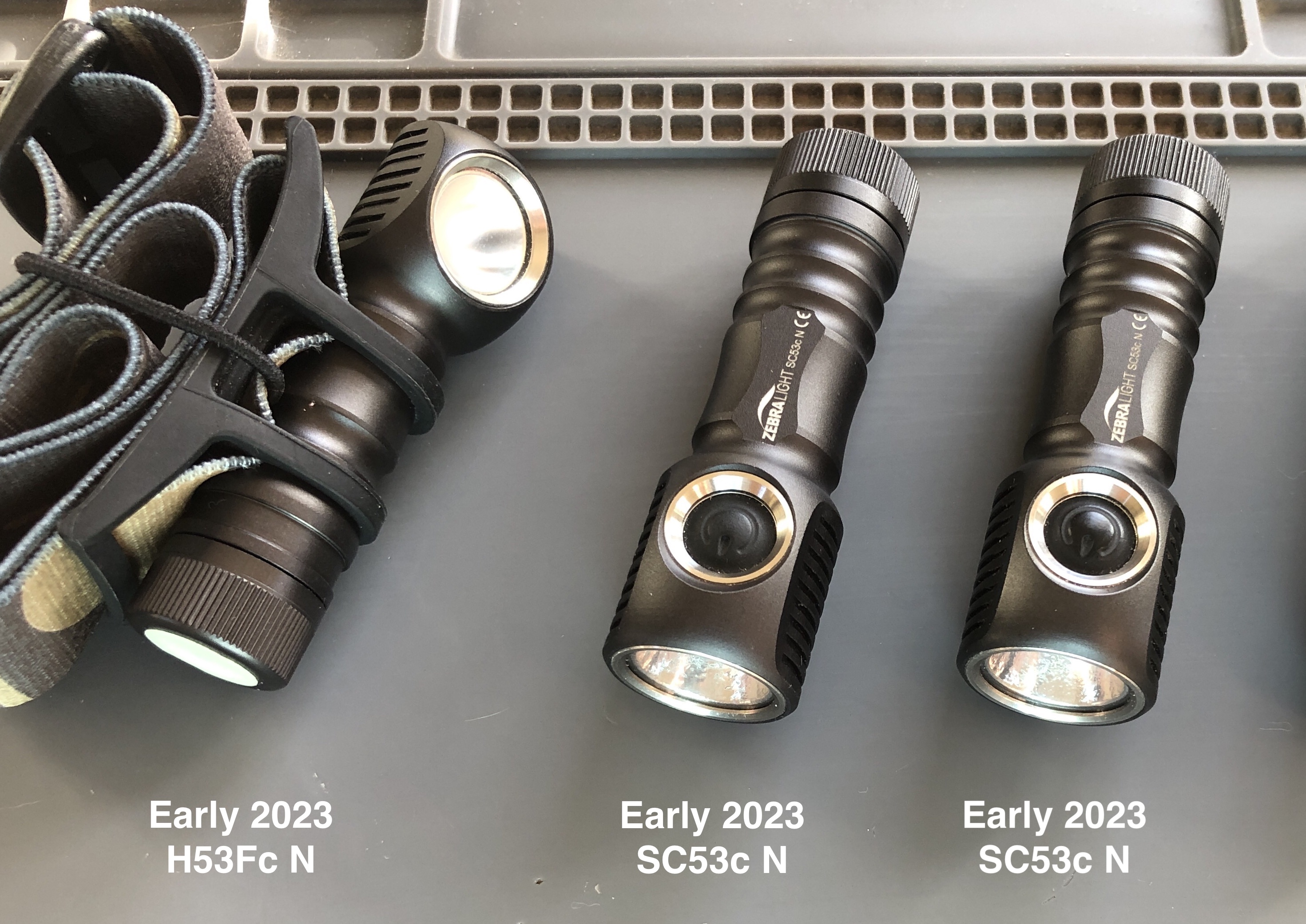

the LiIon option ended with 53 series lights produced in October 2023
Im a fan of the earlier 2023 models, that do work on LiIon:
The Headlamp will work w 50.1mm length button top batteries such as Lumintop 14500 w USB-C, also w
Eneloop which are 50.1mm, as are Energizer Ultimate Lithium
The AA SC models will accept a slightly longer battery such as 51.1mm Vapcel F15 button top

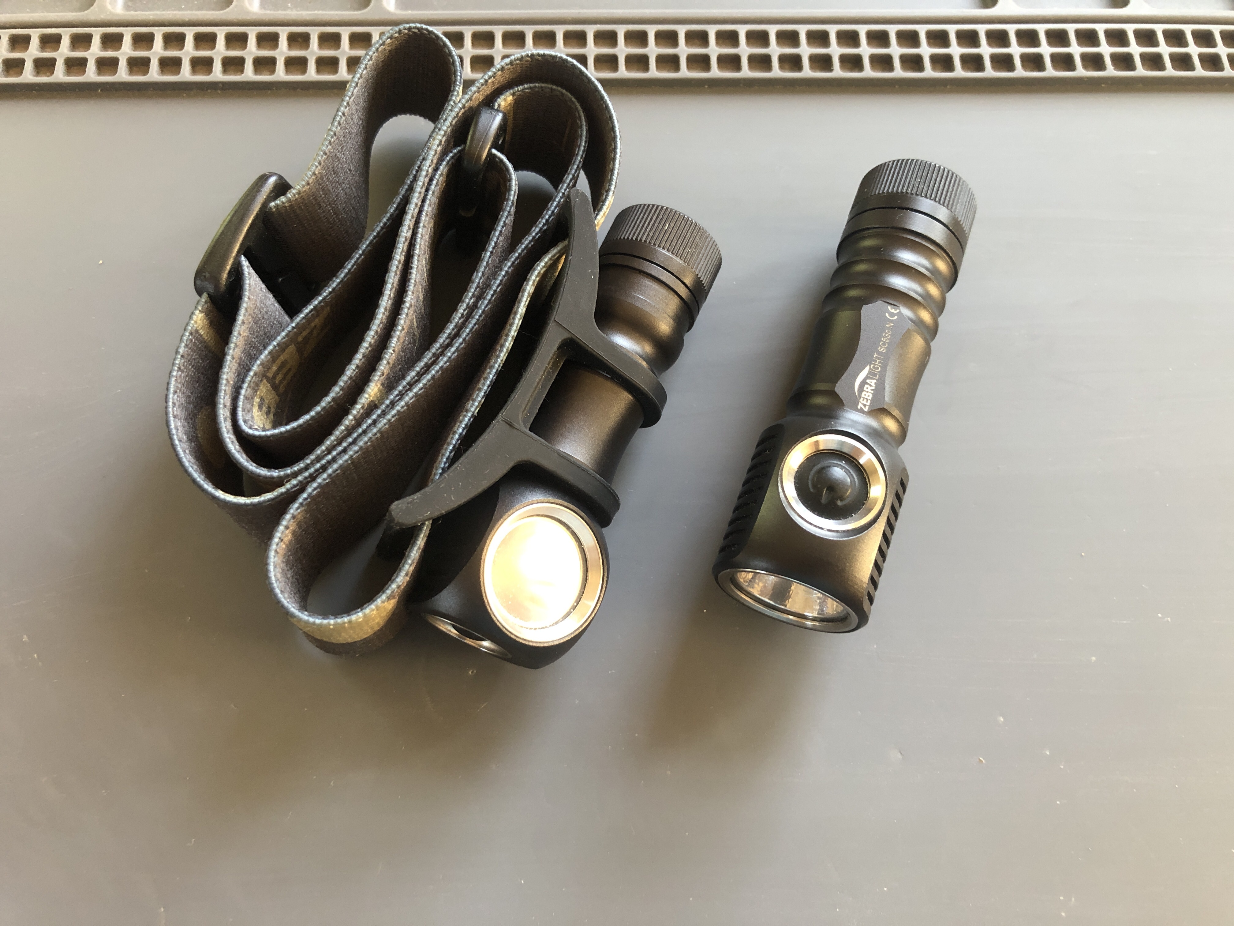

Yeah, I just wanted to point out that the H503/4 series headlamp has an even smaller battery-compartment than the H53/4 series headlamp.
In my H53, I can use the old ZL 14500, which is a full 52mm long. It will not fit into my H503 models -- tailcap just won't thread down all the way.

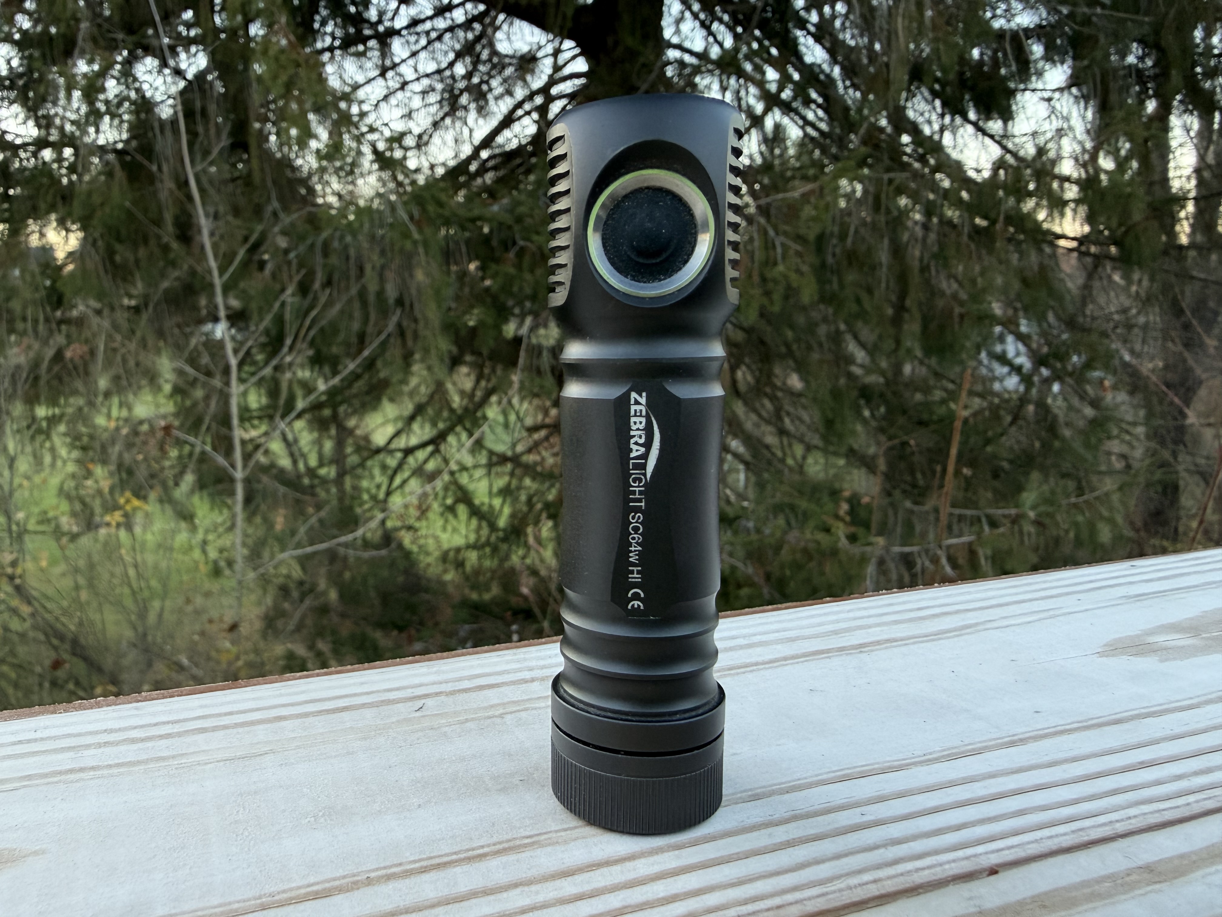

my wonderful SC64w HI
you've definitely got a Stud Stallion there.. enjoy!
Here is a great Video Beam comparison of Zebralight SC64c LE, SC64w HI, and SC65c HI

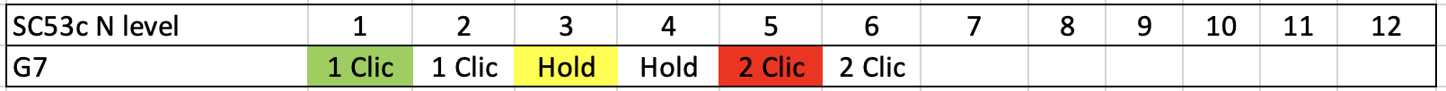

For nightstand use I set up G7 to give me access to the first 6 levels:
I like 1 Clic for Lowest mode first ;-)
