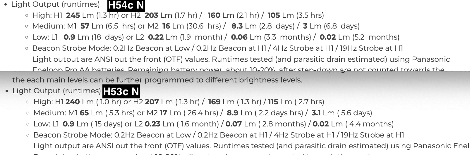

Long review.....I returned it. Ended up feeling like something was being left on the table with the light having absolutely zero throw. Loved the size and great for up close, but the light dropped off so fast at any distance that I decided to return it. Now I'm contemplating an H54C N or trying to source another H53C N. The newer ones are supposedly more efficient no?
yes, the specs show longer runtime for the H54c N:

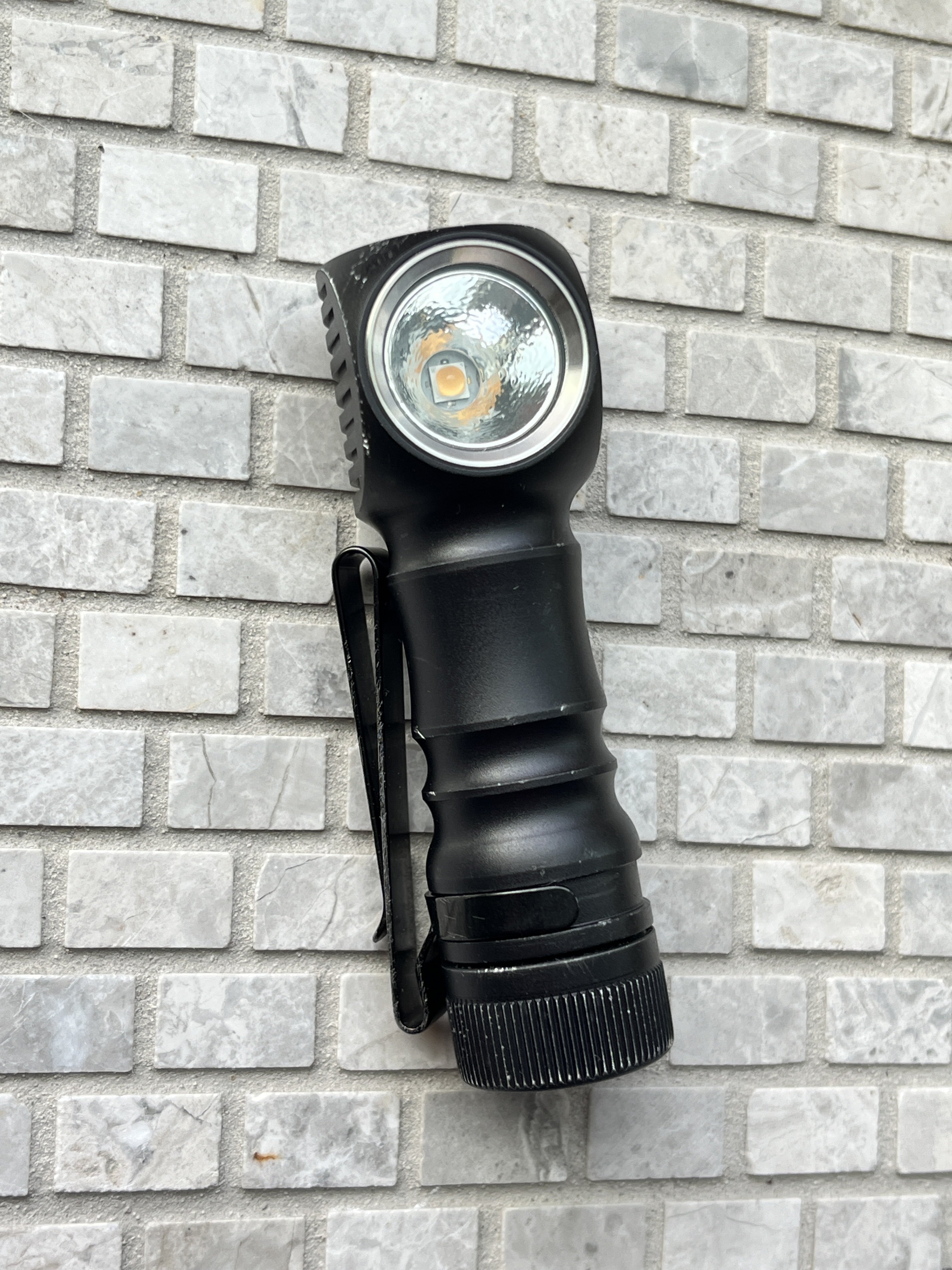

I’m back riding a zebra. Found a good deal on an h54 user. Looks like it was dropped into a garbage disposal but functions perfectly. Now I will re-secure a standard straight AA model zebra and all will be right in the world. Until I have another fit of insanity and sell off my lights. Looking for the SC5C II LE that I used to have. Chunkier yes, but the knurling on the little Zebras is neat. I asked Zebralight a little while back if they had plans to bring back the knurled bodies on the smaller lights and they said no. I cried a little.

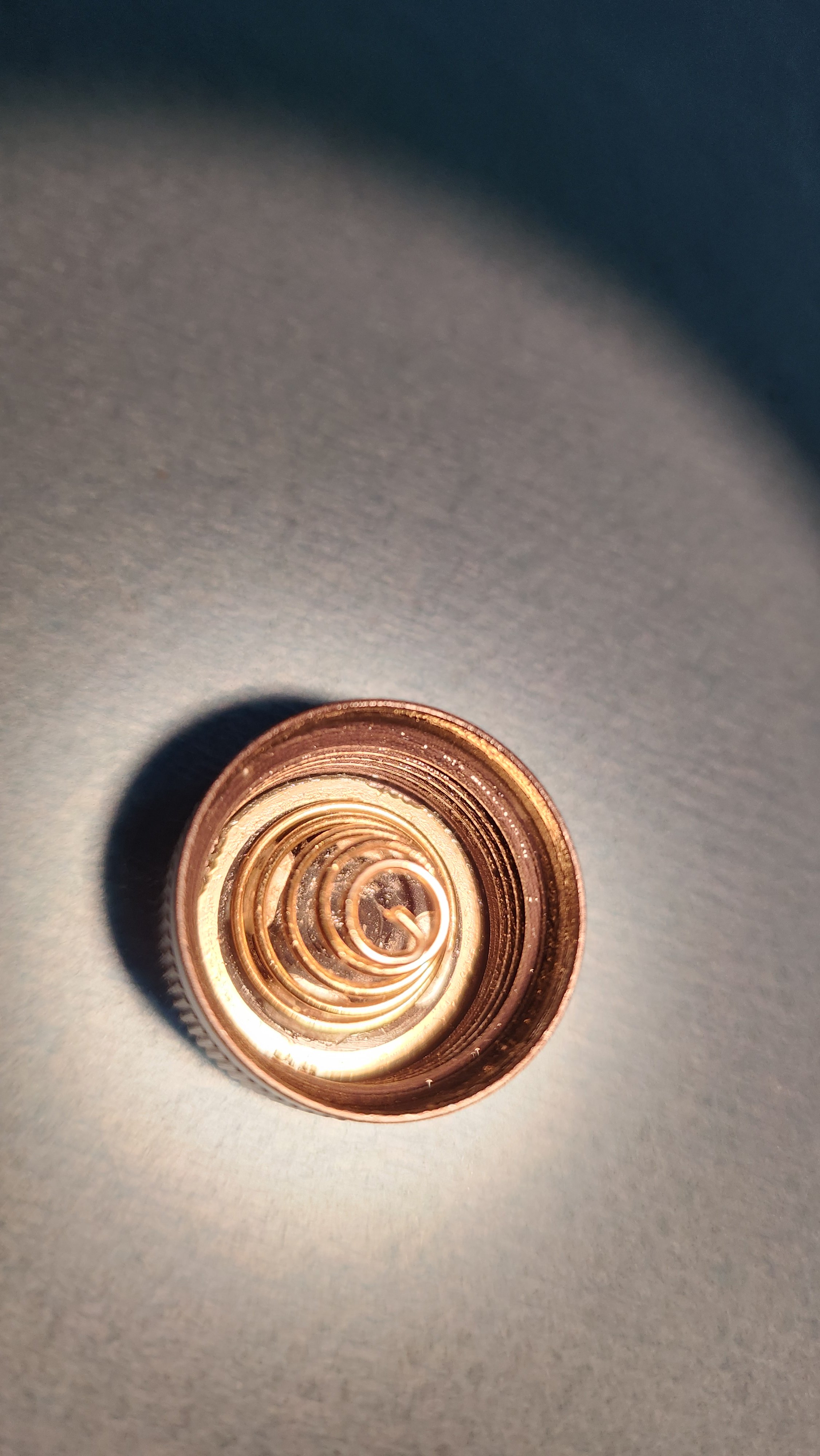

I've considered adding a magnet to my H53. I'm not sure if there's a PCB at the bottom? I tried adding a magnet through the spring, and it didn't really seem to do much through the metal, and possibly a PCB if there is one.
The magnet might not be powerful enough...what size/strength did you use?

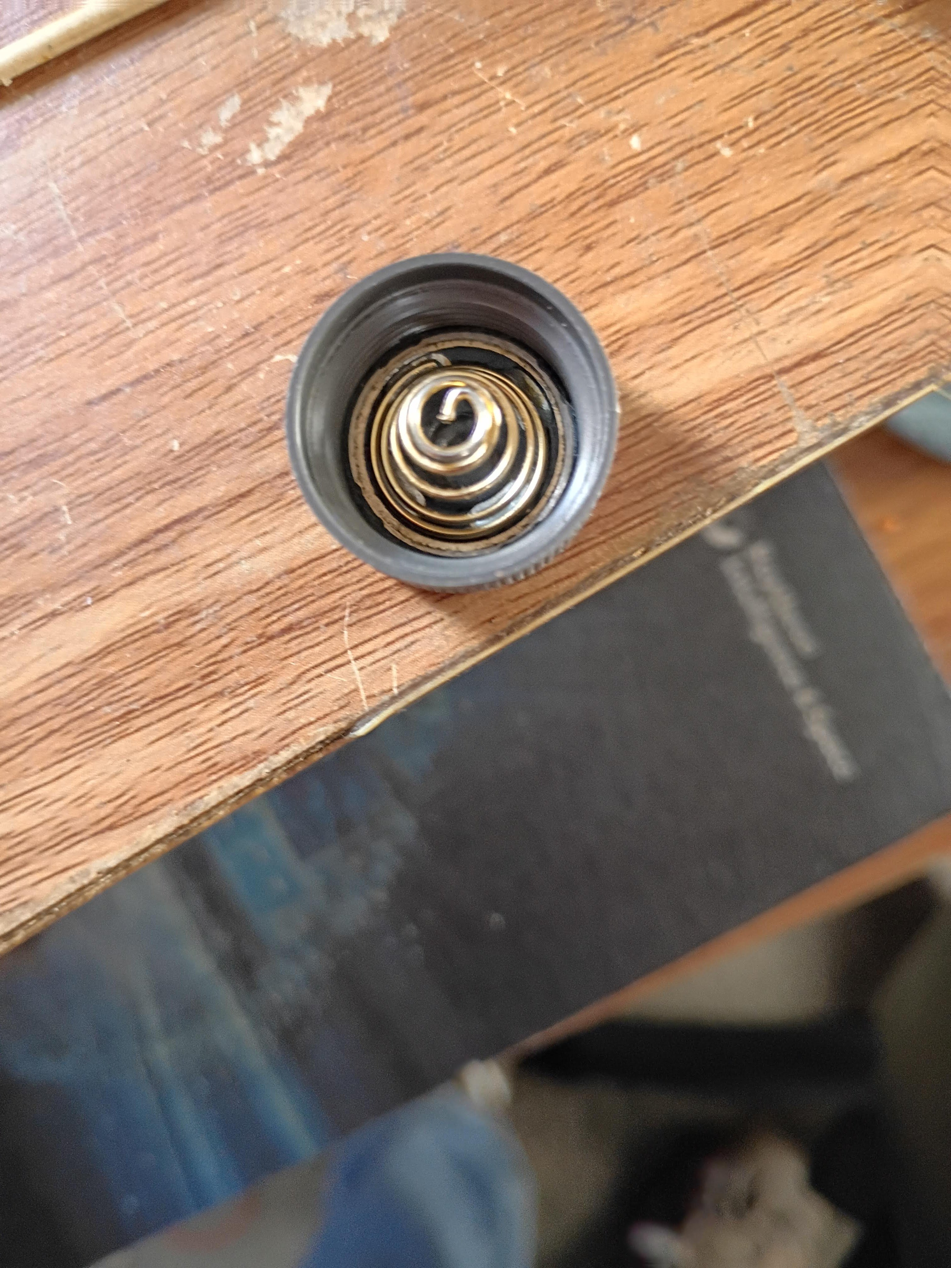

Something interesting to note...while there isn't a stock magnet in my h53fcn, there's something in the tailcap that magnetizes when another magnet is applied to it.
From the looks of the "pcb", it looks glued on. Might be necessary to remove it in order to stick a larger magnet in there...
What diameter and thickness of magnet did you use?
Its a neodymium 4mm on a side cube. Not ideal, but I just was fooling around.
from the looks of the "pcb", it looks glued on. Might be necessary to remove it in order to stick a larger magnet in there...
Hmm, sounds like too much work. I also have another round magnet almost the diameter of the tailcap. Would definitely need to be glued on the outside. Not quite ready to try that yet . . .
