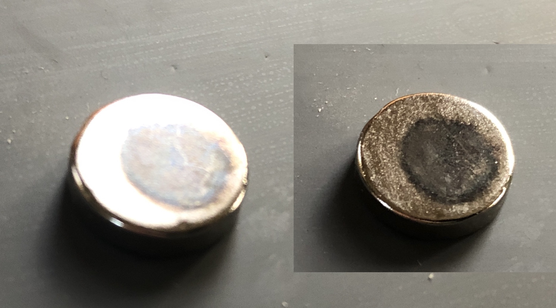

Its a neodymium 4mm on a side cube. Not ideal, but I just was fooling around.
Hmm, sounds like too much work. I also have another round magnet almost the diameter of the tailcap. Would definitely need to be glued on the outside. Not quite ready to try that yet . . .
Well, if you do, you could always use shrink wrapping/tubing. It wouldn't be permanent, and allow some bumper action.
**put a layer of kapton tape to prevent scratching, then the magnet, and slide the enclosed shrink tubing over and heat it up
I'm not so worried about scratching the tailcap, it's a bit worn already. but I do appreciate the plan for future reference. I suppose if I put the tape, glue, magnet, I could just peel the magnet off if I changed my mind. Hmm, now you got me thinking . . .

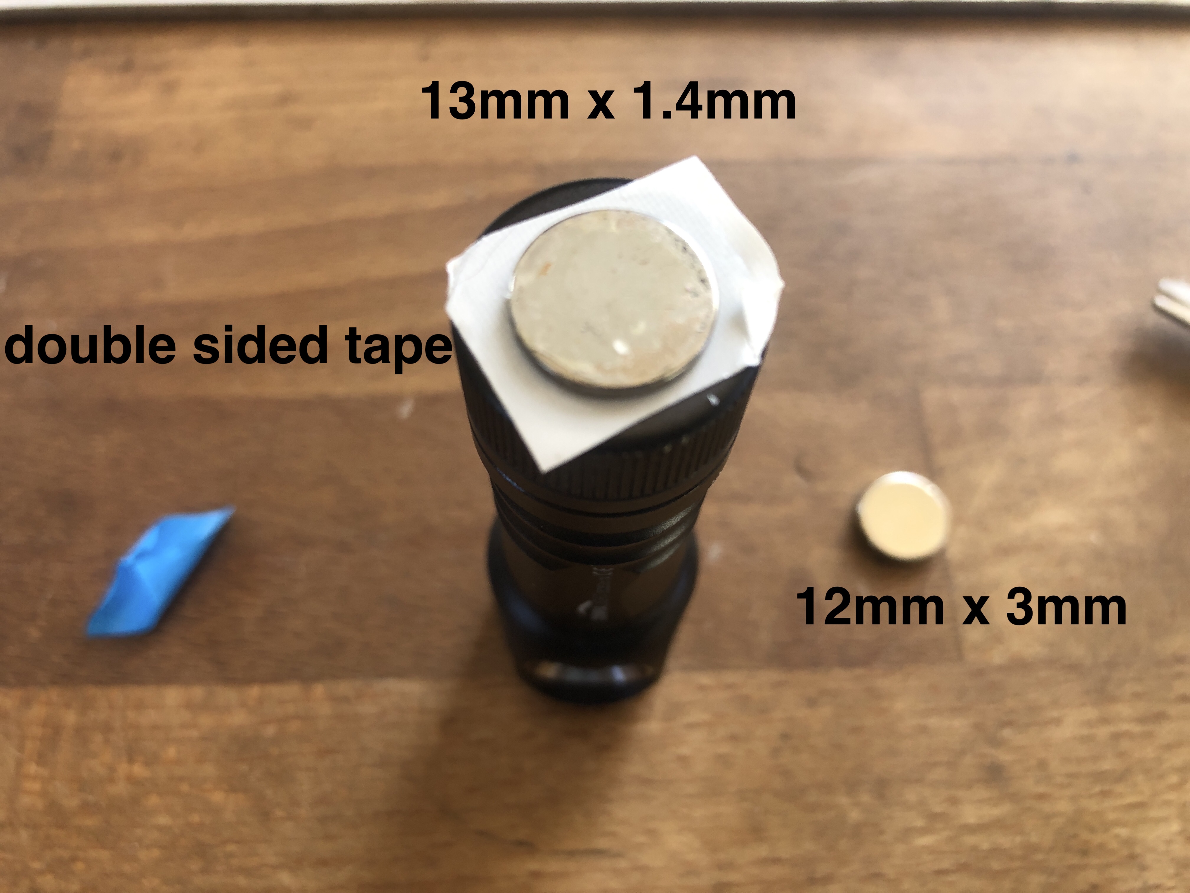

double sided foam tape will hold a magnet to the outside, and is still easily removable if you change your mind.
both magnets are strong enough to hold the light but too big to fit in the spring
or if you prefer to use a magnet inside the spring, you could buy some of these 10mm x 1mm magnets.. (I measured the base of the spring and I think they fit.. you should confirm, or buy smaller), you could double up to make stronger..

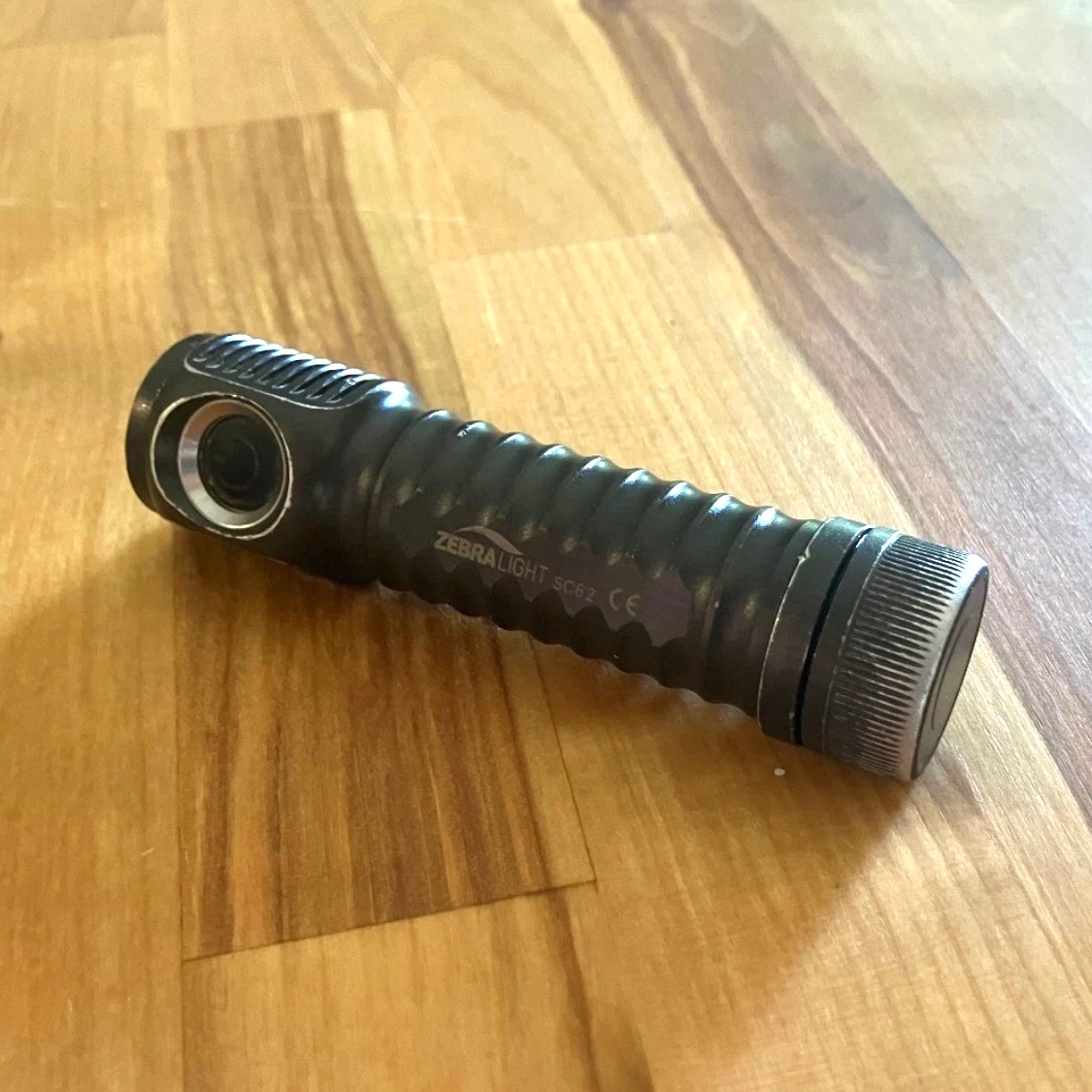

Well….in a spontaneous fit of flashaholiscism, I hit buy it now on an old Zebralight sc62. For $40 I thought what the heck. Now I’m in need of a charger and battery. Is it true that that SC62 can fit protected 18650 batteries, and if so which ones do you recommend I try to buy. Was looking at these and an Xtar X2 charger.

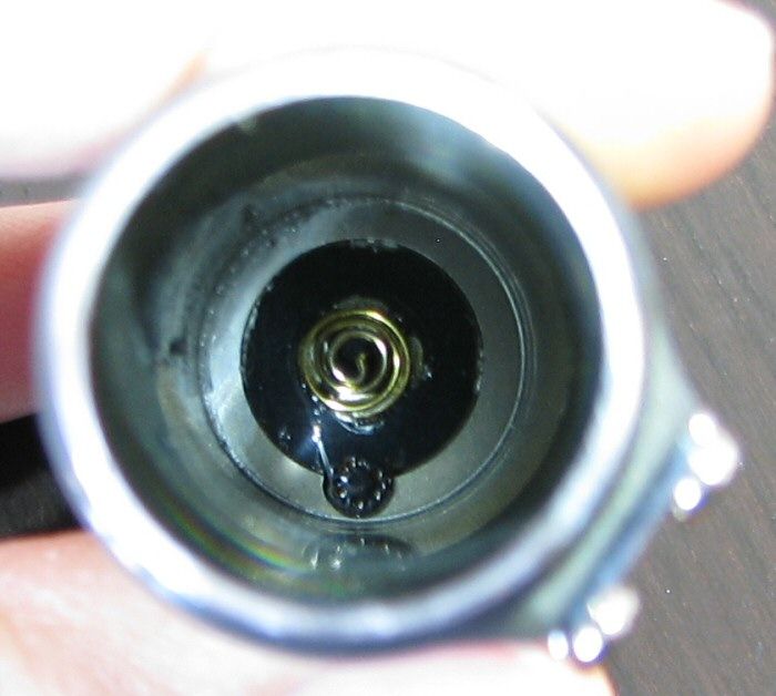

there Is a spring in the head, so that should work for a Button Top:

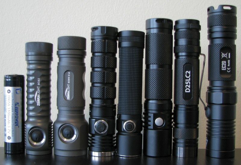

the selfbuilt review says:
"Battery: One 18650 size (up to 69mm long)"
and he shows a photo of a button top:
(same brand, and also a protected button top, but less capacity so maybe shorter than the one you linked)
then he says:
"As with the SC600-II, there is a small spring on the positive terminal contact board in the head. All my 18650 cells seem to fit and work inside the light (although really long or thick protected high capacity batteries may have issues)."
(the battery you linked is high capacity and may be too long)

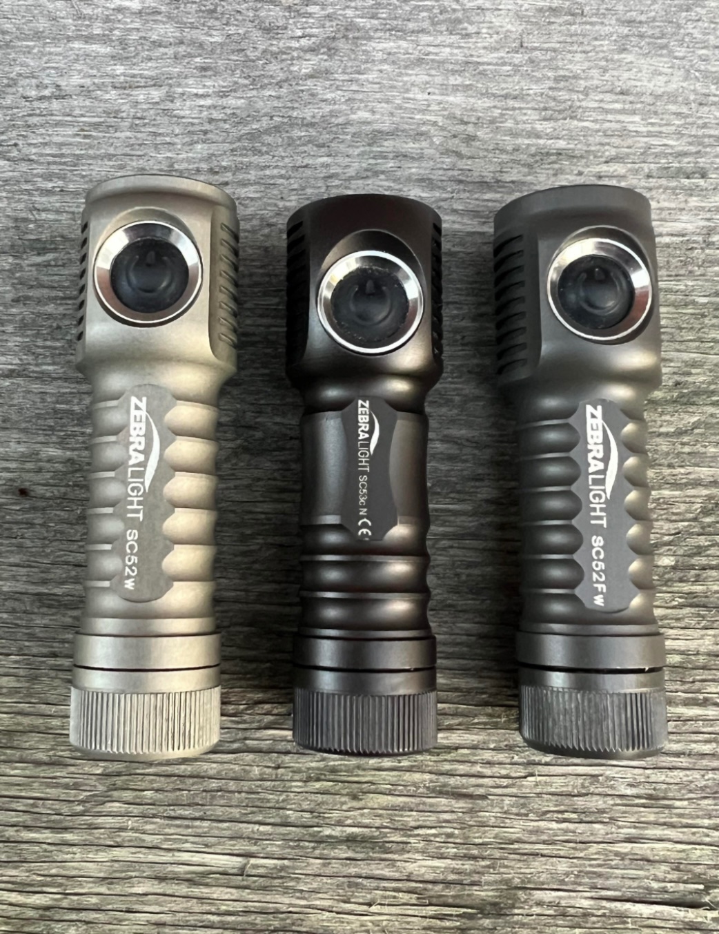

What’s your favorite anodizing that Zebralight has done. I only have one currently and it’s the dark, basically black, like the middle one in this photo. I think I prefer the medium one on the right.

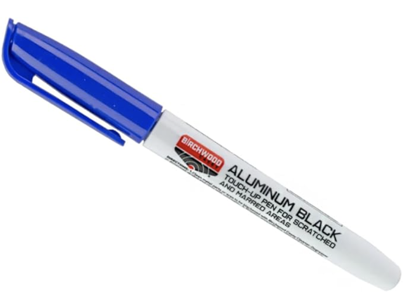

otoh, the reason Im replying is to share an alternative for covering the scrapes. I have used an Anodizing pen with good success in turning scrapes black. (after sanding them smooth if needed).
This is an actual chemical anodizing liquid. It is a clear liquid, not just a black paint.

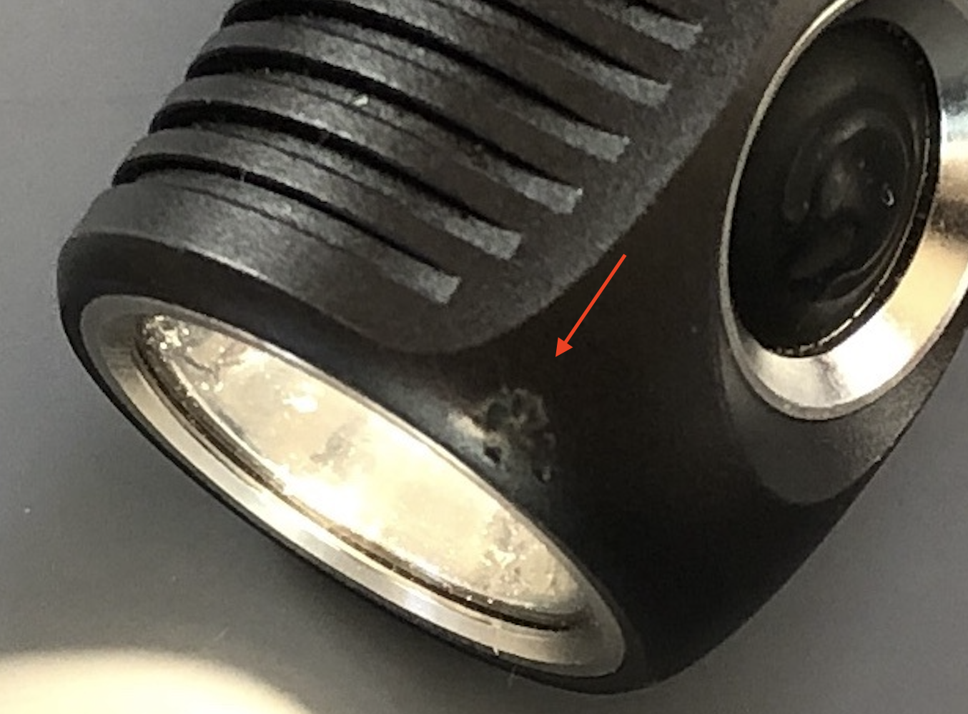

Here is an example of a ding on an SC65, that I smoothed with emery boards (for fingernails) to remove any raised burrs, and then used the Anodizing pen to make the exposed aluminum black again:
you can see the marks are black, the light color near the bezel is just a light reflection
the nice thing about this product is it does not matter if some of it gets on the undamaged anodizing, it remains unchanged. The treated area ends up being a good color match for the stock anodizing, and the color does not rub off.. recommended for minor touchups. I dont know how badly scratched your light is, but it may be worth considering.

Thanks for that Jon I may give it a try on other torches- I bought this sc65 which really is not bad at all specifically for a tester to "unanodize"
