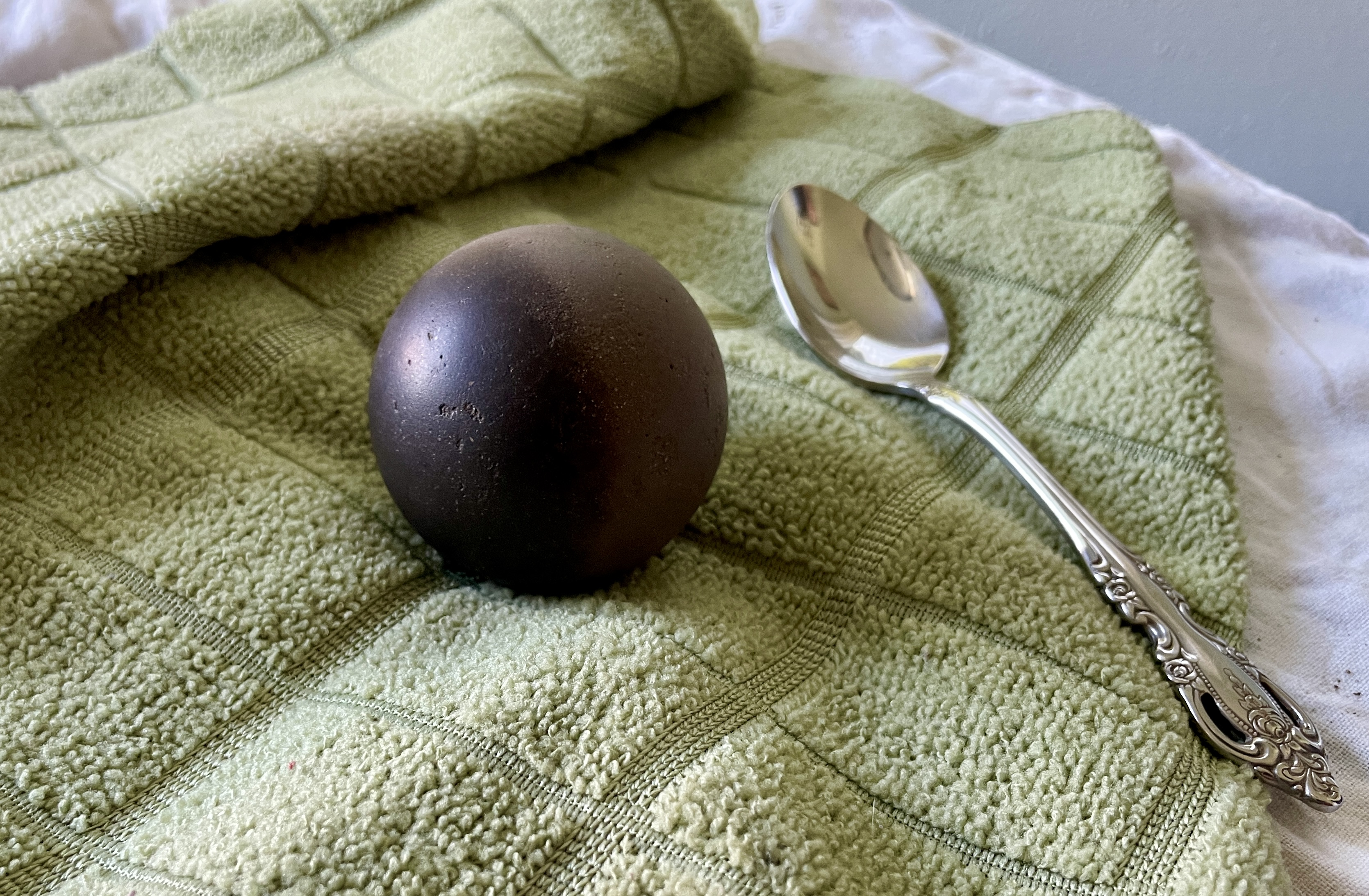

Once again, it's time to play - What The Hell Is That!?
I found this on our kitchen table.
