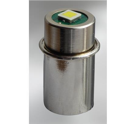

1. Simple LED bulb drop-in. Here in the UK you can get an XHP35 PR base drop-in.
It's really quite cheap here. Sure they will ship to the USA or you might be able to find similar more local.
I have this one and it's the best of this kind I've tried. You really need to do nothing else to make it a very usable torch.

Simple PR-base dropin is a great upgrade. The Lumencraft one in @hsa's post is well made.
I m' looking at those, thanks

There is no need for rechargeable for pr drop ins, they do not pull enough power to justify their use. if you had a drop in that needs 3+ amps, then yes, but with pr drawing less that stock bulb, regular alkalines will work just fine, not to mention you need an adapter for AA. leaking cells are different story, but if you were using alkaline cells before, then you already know the risks.
I have moded several dozen of maglites, with probably any combination possible, i found 95% pr drop ins are worse performers than stock bulb, i have several laying around that i tried, but was disappointed, i can send you them for free. you only cover shipping, i think i still have original maglite pr drop in, and another one that i forgot the name of, as well as showerhead 5mm leds drop ins, however that one is for 4 cells, you can use 4 c cells in 3d light, if you remove the spring, and use a smaller one, so the last cell goes into the tailcap. you'll need to put a 1 inch pvc pipe so c cells can be centered. However i have little doubts you'll be disappointed as i was.
However i would try lumencraft pr that is 300+lm, that one is a lot brighter than any pr i tried, thou all my pr are 10+ years old.
