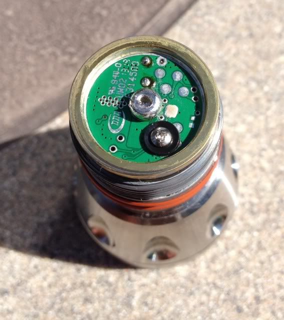

Ok - I did it. Bought a "Circuit Writer" pen from radio shack (for twice the price it is on Amazon because I couldn't wait) and colored my solder gap silver:).
Level changes definitely exercised my mind but once I got the hang of the blink codes and the level changing - it became fun. I haven't set presets yet but I did zoom straight to level 16 and bumped it up to 2200:):):). It will take some time to come up with the other settings only due to the fact I don't know what preferences I have yet. I can't compare the output until dark but lumen charts suggest 700ish lumen numbers for 2200ma - in a McGizmo!:)!:)!
If your on the fence here's what I think: It's actually not too easy to accidentally engage the setup mode so no worries there. One tip that I didn't pick up on: start with the light ON to enter setup mode. I started with it on High(brightness level#4) for my personal reference. Follow the directions in the manual or try it this way:
1)start on High(#4 brightness level)
2)turn light off and on to keep the light on #4 brightness level (a.k.a - long toggle)
3)repeat step 2
4)change brightness level to #1 (a.k.a - short toggle)
5)change brightness level to #2
6)change brightness level to #3
7)change brightness level to #4
8)repeat step 2
9)repeat step 2
...and your in level one, setting one, of the setup menu as is indicated by the triple blink.
To get your feet wet, give yourself about 30 minutes to play with the blinks, compare the light's actions with the verbage in the manual, and adjust basic settings. Then... Have fun:)

Mattp- the pen was super easy - a little high priced in my opinion but super easy.
Ok. It's dark. I'm having fun. Bridging the gap is worth it.
It's not that helpful but all I really have to compare it to is a makai 6v xm-l and a zebralight sc600 mII. The Makai still out-throws the Aqua Ram on 2200mA but the beam on the Aqua is so much larger that it makes it more useful and the throw advantage of the Makai is not as extreme as I thought it might be for distance. The Aqua Ram has more throw than the sc600 but covers almost as much flood area. The Aqua just doesn't have as smooth or wide of a flood beam as the sc600. So the Aqua beam at 2200 is a nice balance between the two lights I can compare it to... for what that's worth.
Boosting the max current to 2200 has another plus. Brightness level three seems to be about as bright as brightness level 4 was on the stock setup. So it's almost like I have a three speed converter with an additional mode - TURBO! If only I could put a turbo on my Makai and Haiku!
