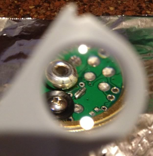

Jumper has been filled. :D
Going to try and program later.

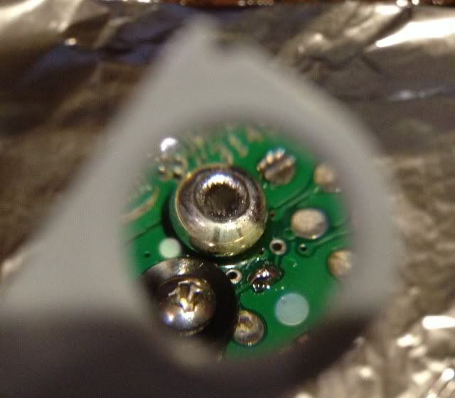

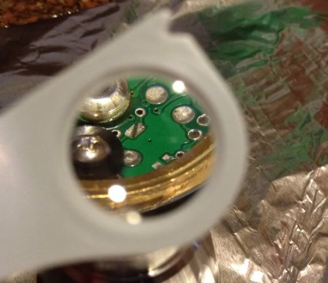

Yep - Caig labs circuit writer precision conductive ink dispenser.
mine looks a little more silver than yours though. Dumb question but did you shake your pen enough? It took a lot of shaking for the ball in my pen to move and mix up the ink. I practiced with the pen a little before touching the converter, made a puddle on a piece of paper, and dabbed the solder gap after dipping the pen tip in the puddle. It looks like a very thin layer of solder/ silver ink.

Redid mine. Basically looks just like yours now Calflash. Still no beans. Lol.
A few times (out of at least 75 tries) I saw it triple blink after the sequence but then nothing happened afterwards.
