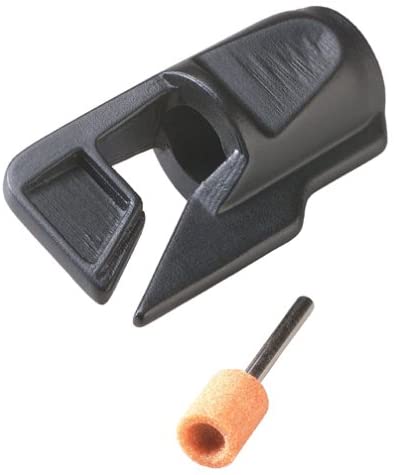

I use a dremel bit that is basically a jig with a hardened sanding drum attached, you guide up and down the blade with it still attached to the mower.
If you use it a few times a season it works well. If you use it each Spring, it's faster to use the bench method described above.
Ear plugs and goggles reccomended. I also keep a bucket of water nearby in case sparks cause a fire.
Same here, sometimes I use an angle grinder at the end of the season to get it cut to where it needs to be and then use the Dremel attachment during the season to keep it sharp.
