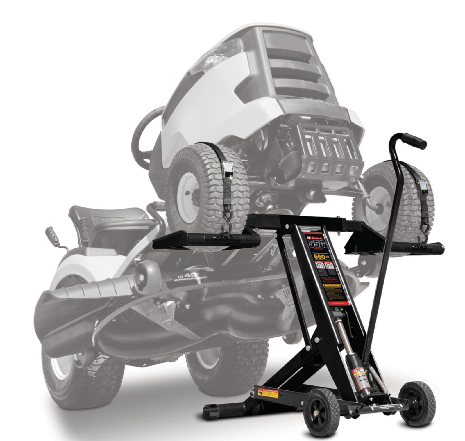

...He said that he doesn't remove his deck.
Mower lifts leave the deck atatched.

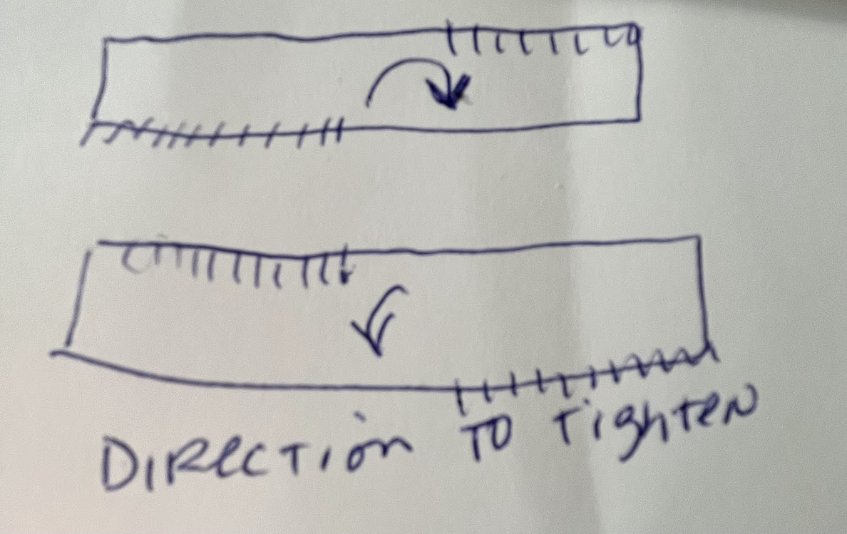

Trying to think this through, I know that in Ford's, the idler pully is usually a left handed thread. One can look at the direction that the pully rotates when the engine is running. If the fan belt turns it counter clockwise, that would be the direction that would tighten the bolt (if it is a left hand thread), and vice versa.
I believe the picture below is accurate. And if so, then in order to loosen the retaining bolt, one would need to keep the blade from rotating in the cutting direction, while trying to loosen the bolt.
If you've got a single blade push mower, it's normal threading. Don't overthink it.
All my mowers, single blade, dual blade, and tri blade are all normal threading. This applies to blade bolts, idler pullies, and so on.
They are not going to sell a consumer device w/ reverse threading. Everyone would break off the bolts, creating a warranty return nightmare. Additionally... it's not needed.
Disconnect spark plug, wedge your tennis shoe into the blade/deck gap, and unscrew the bolt. Pull handles are handy...

Mine is a 30 inch Honda ride on. It has right hand threading. I used a 1/2 inch drive breaker bar and a good amount of muscle to break it free. I tried it last year, with enough force to make me consider that it might be a left hand thread.
So, blade in hand, with some light cleaning up against a fine grit grind wheel. It cuts, once again, like it should.
