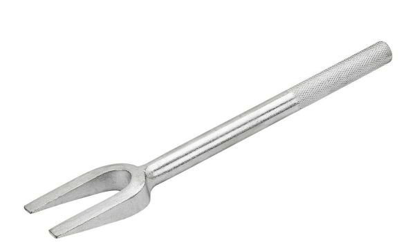

IIRC, I used a pickle fork. Hence the banging in a confined space.
