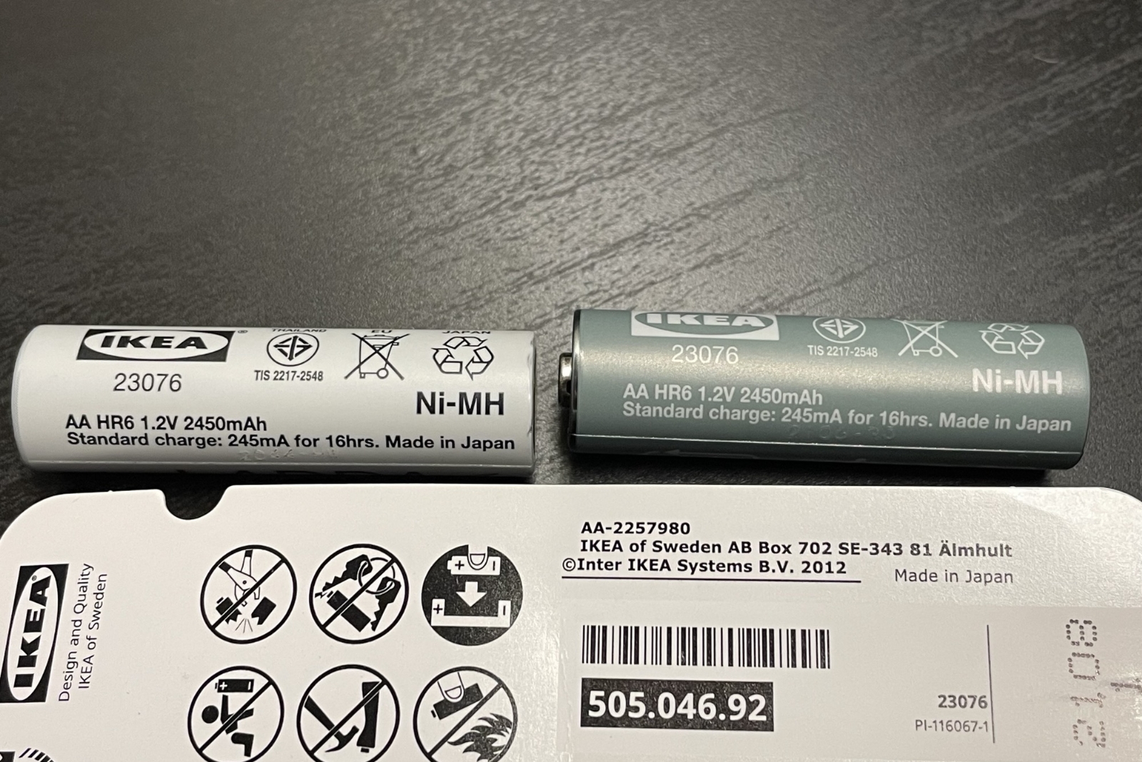

Picked up a pack of the rewrapped LADDA 2450s (gray) today at IKEA and found that they're still made in Japan! The only change seems to be that there's now a game controller graphic on the wrapper.
