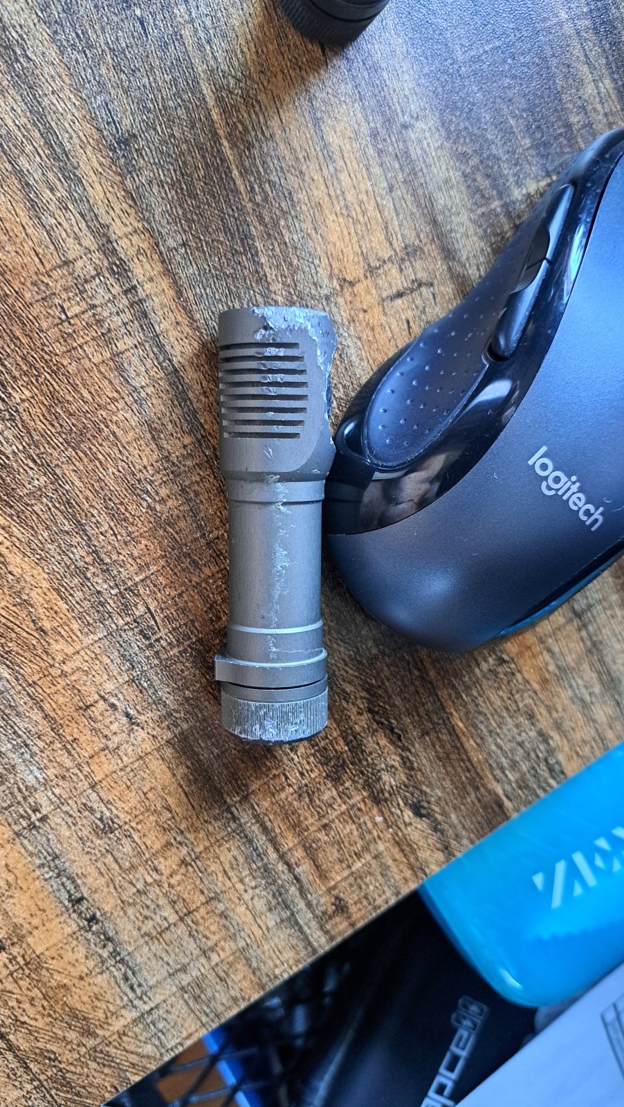

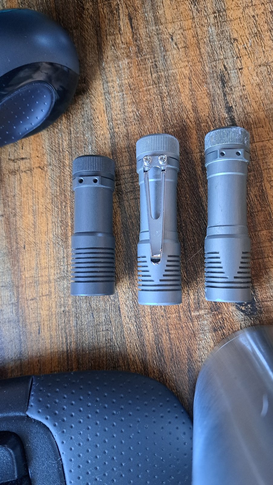

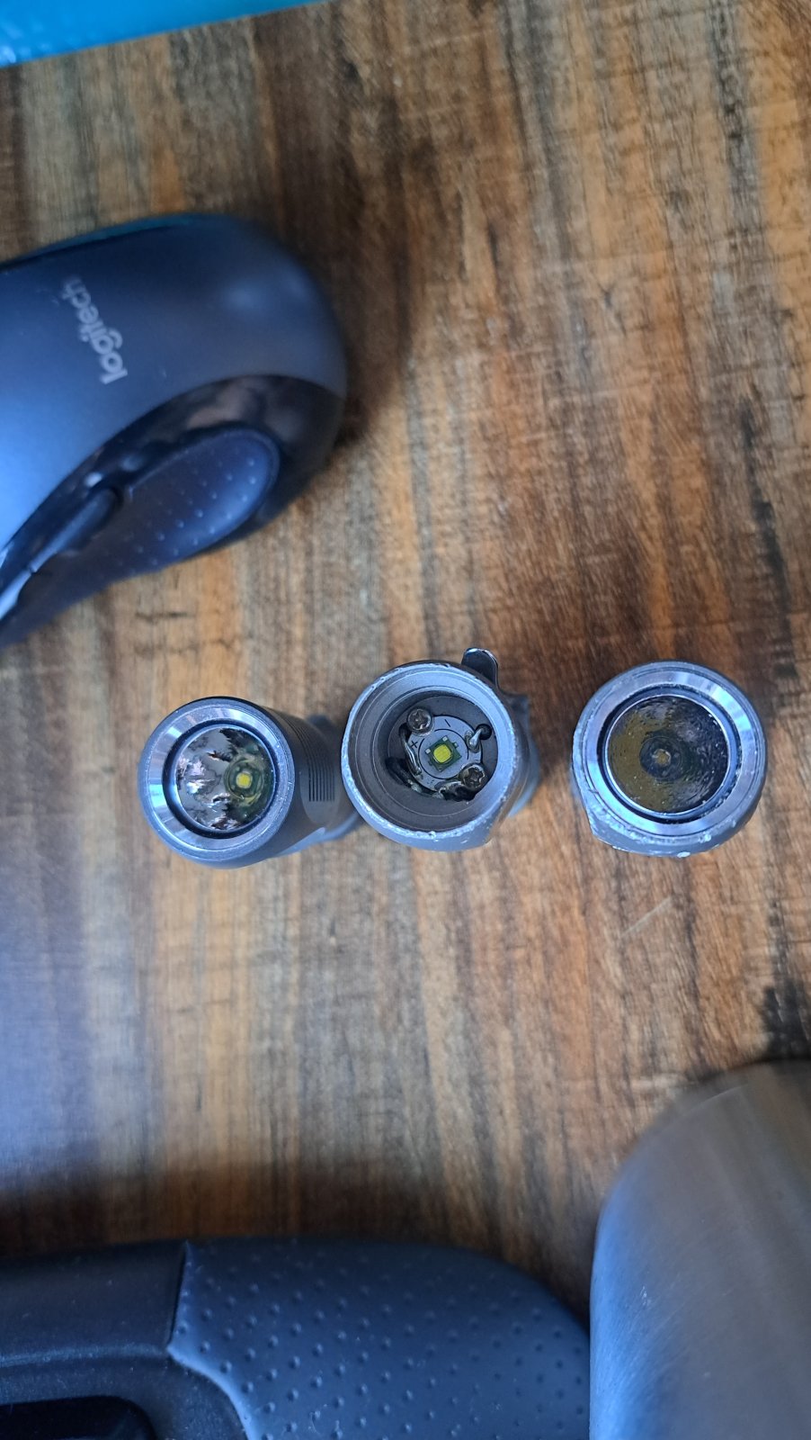

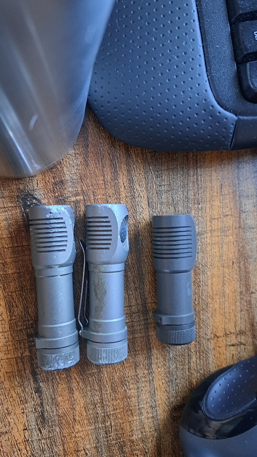

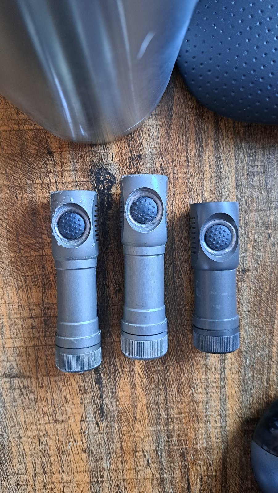

Can anyone tell me what models these are. I still have the boxes but I have almost twenty zebras.
