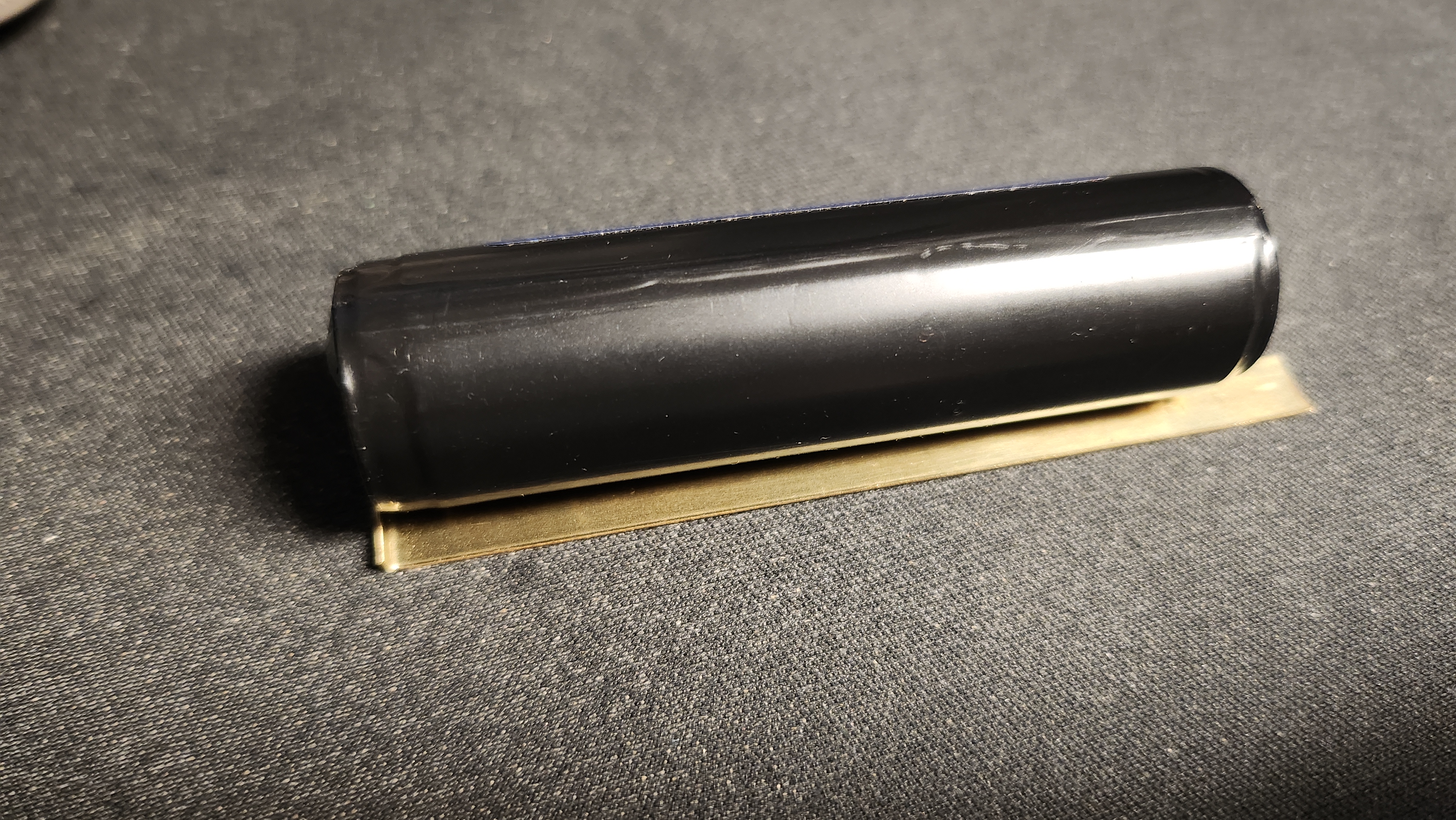

It'll pop into reconnect mode, constant on higher modes with button inoperability, etc, so it's probably of a mix of contact issues due to impact. A 16650 is not snug in the tube, so it has about 1mm of lateral play when using the spring, it rattles in the 17670 tube. Looking at the brass mod with 18650, there is substantially less play, so it should be less likely for the battery or switch to disconnect.

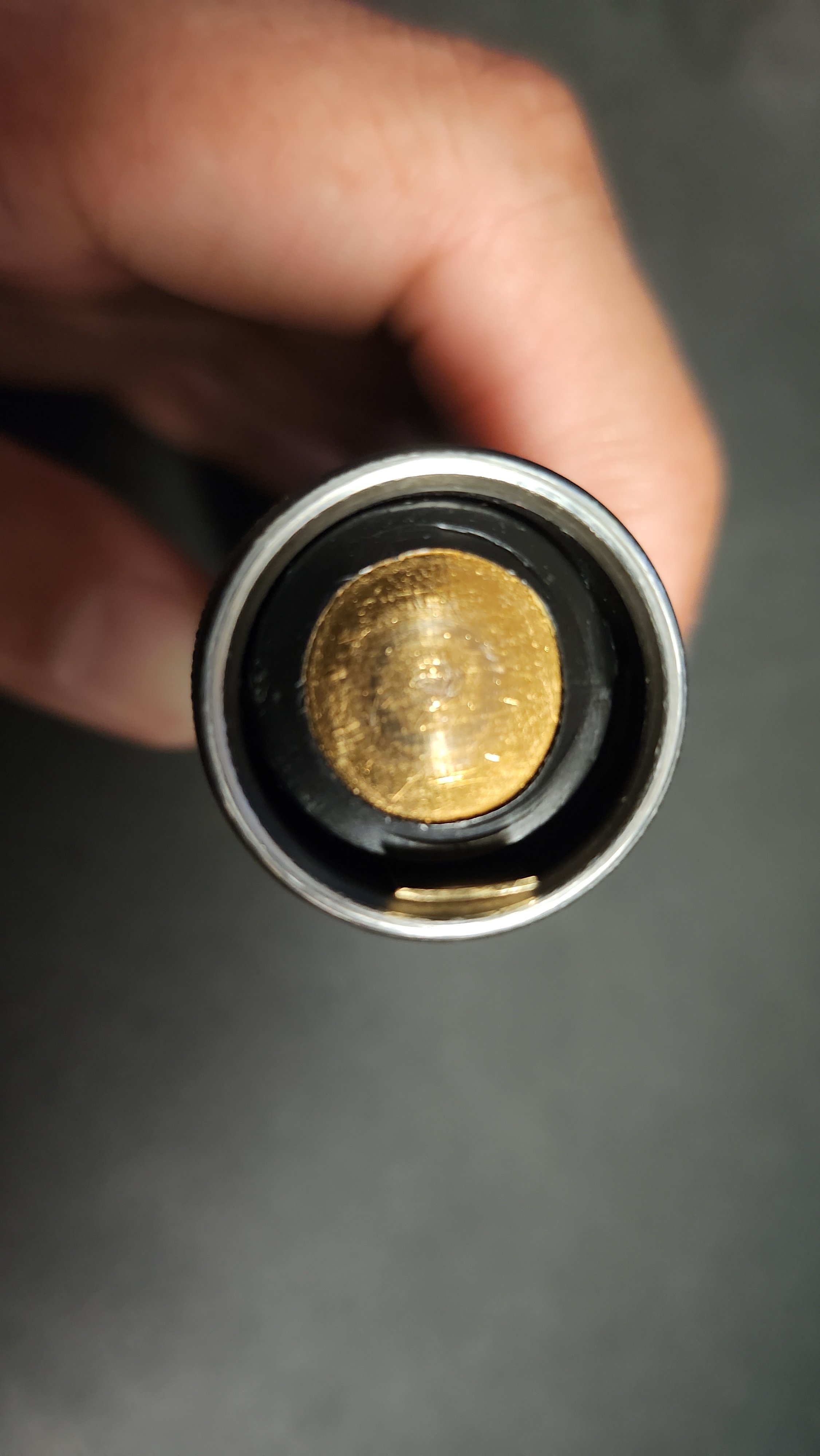

That aside, the only thing I would imagine helping is to solder a contact plate or blob to either or both springs to fill in any space left by the ~2 mm's worth of length difference between a 16(65)0 (or 18(65)0) and 17(67)0. That's another thing I should probably do to the tail spring, the end isn't bent in, so it's ridiculously sharp and is gouging a small circle in my cells...

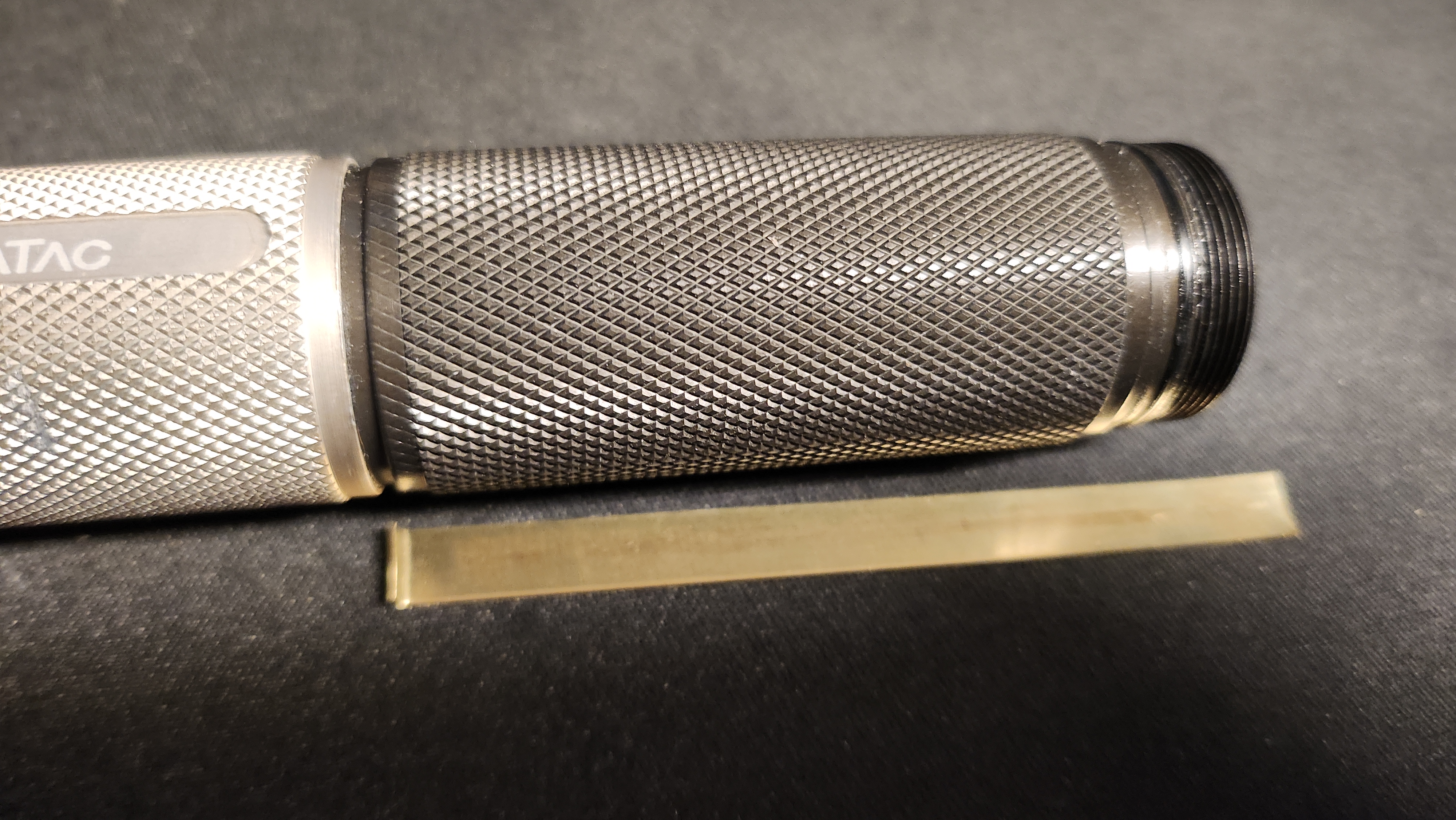

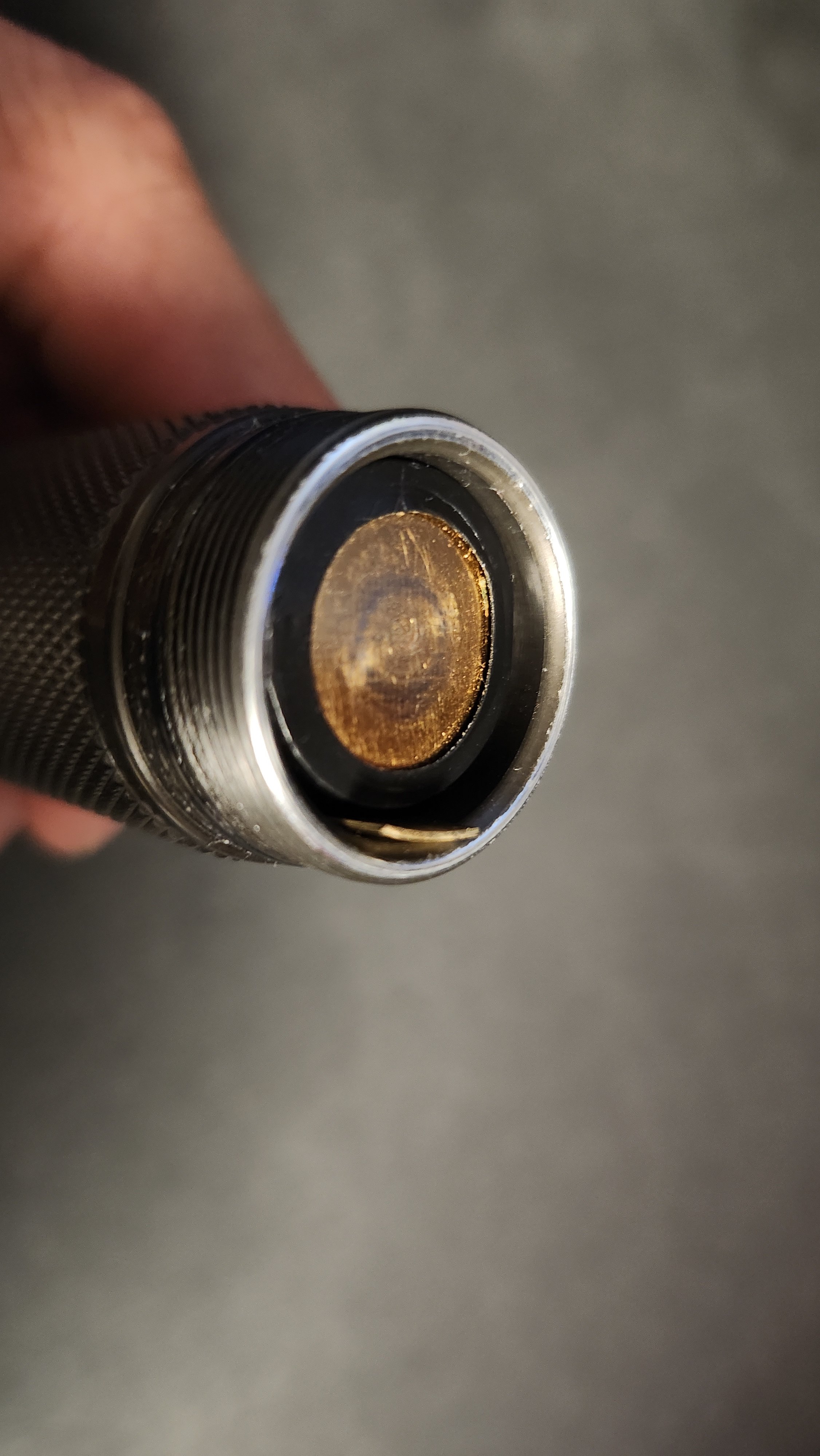

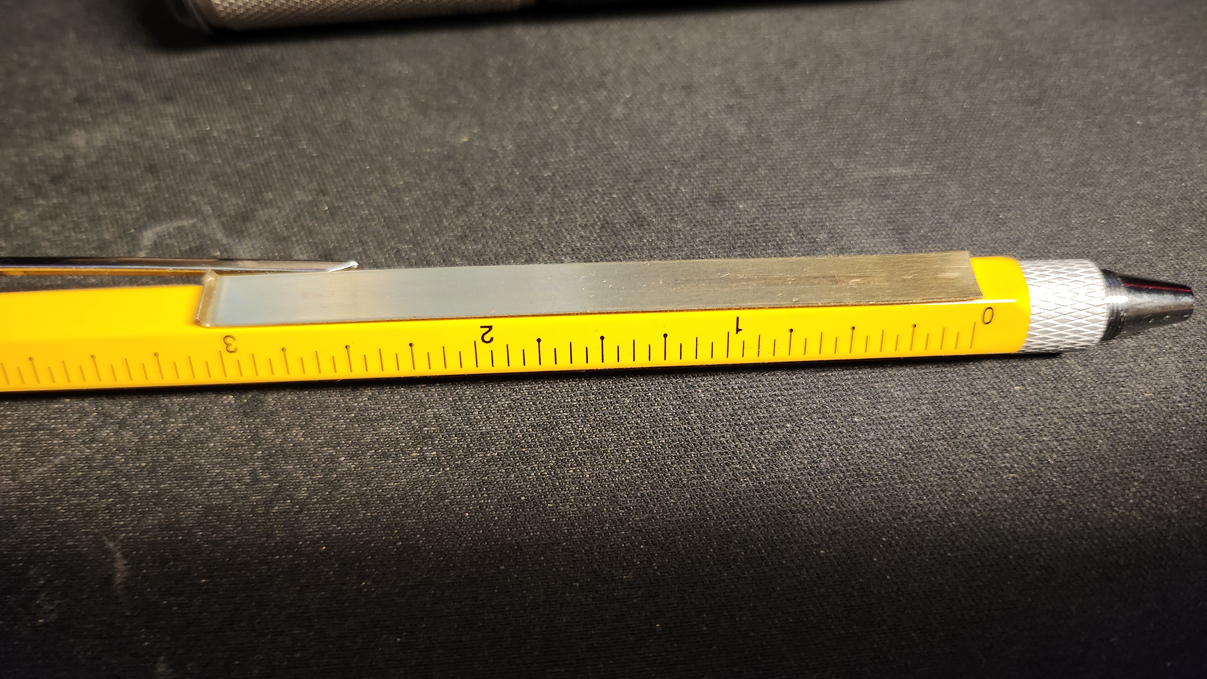

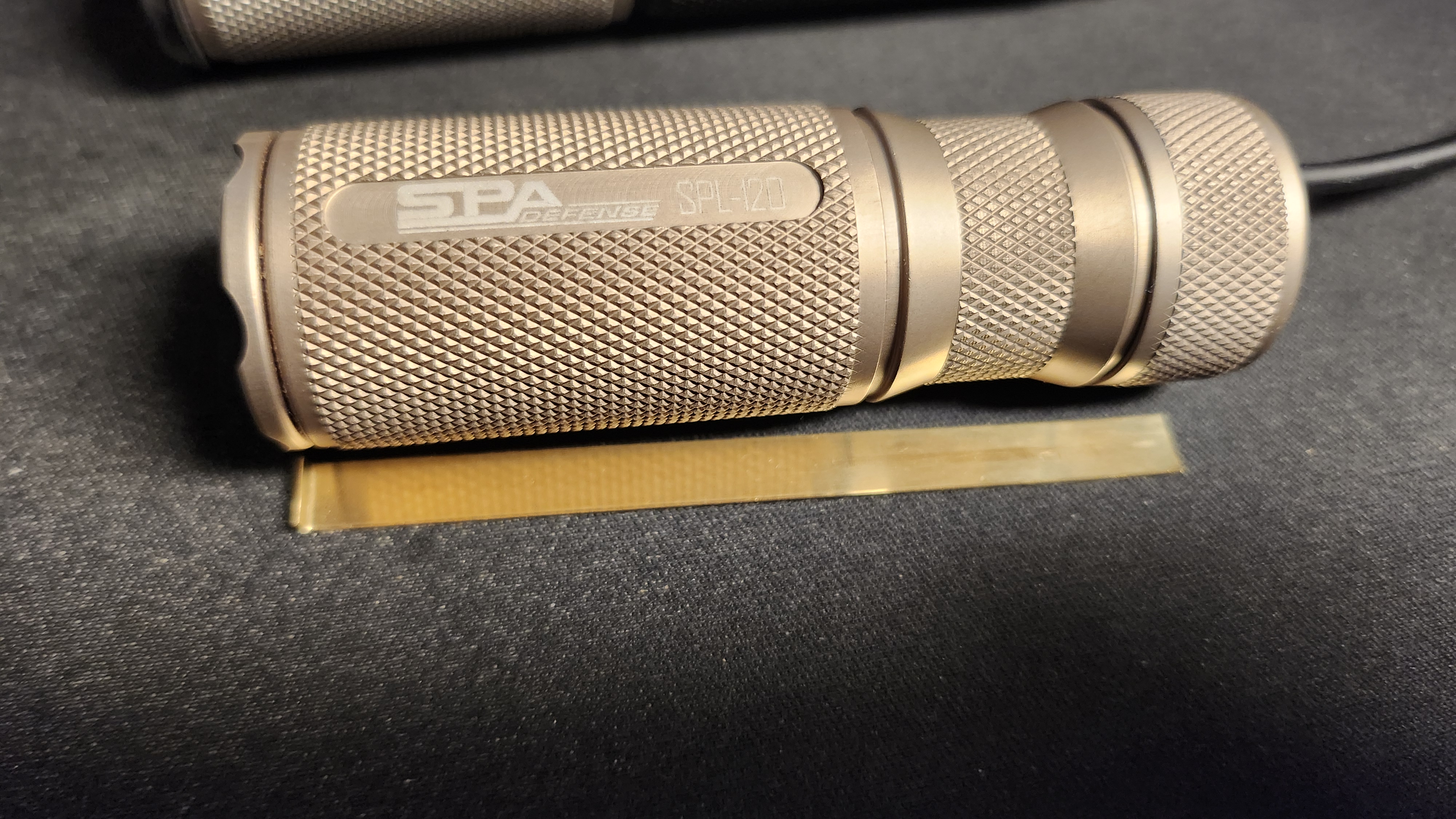

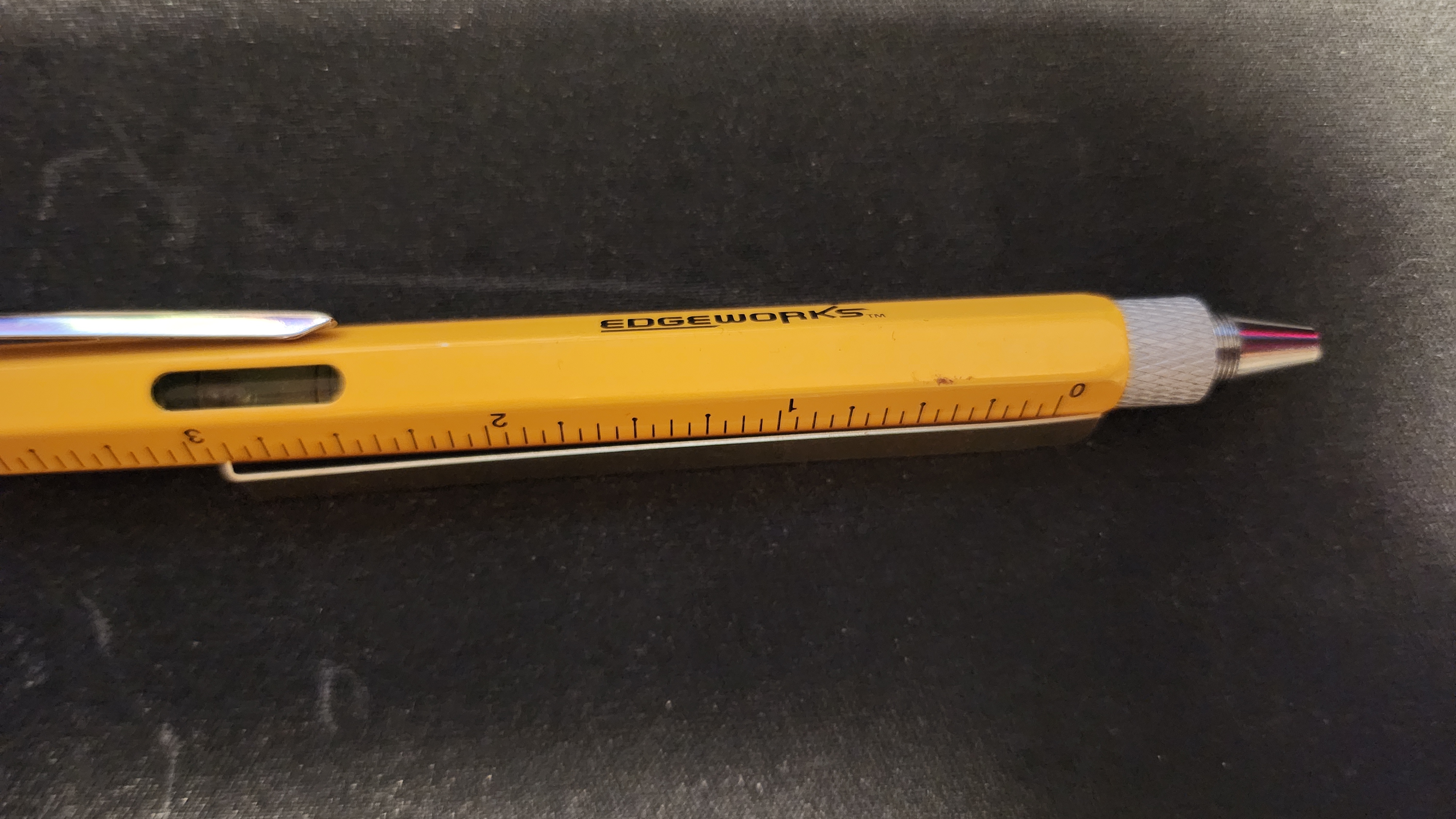

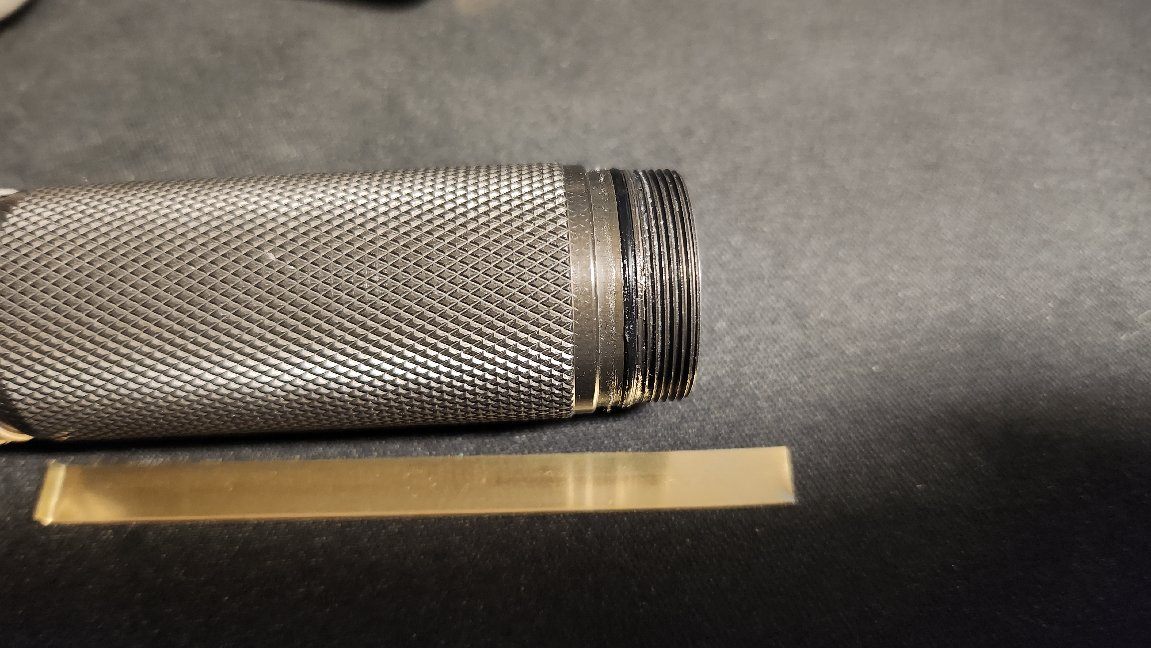

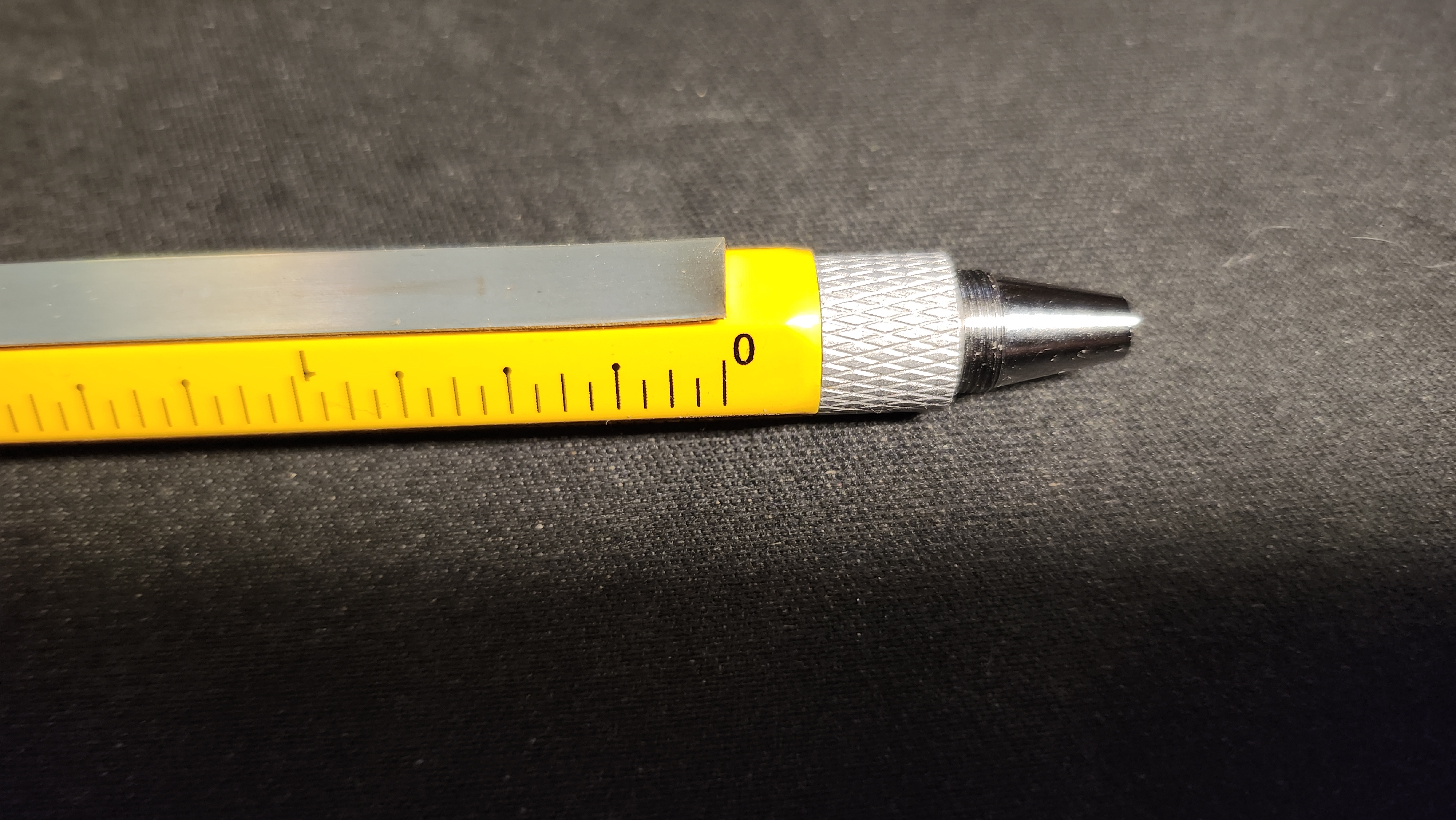

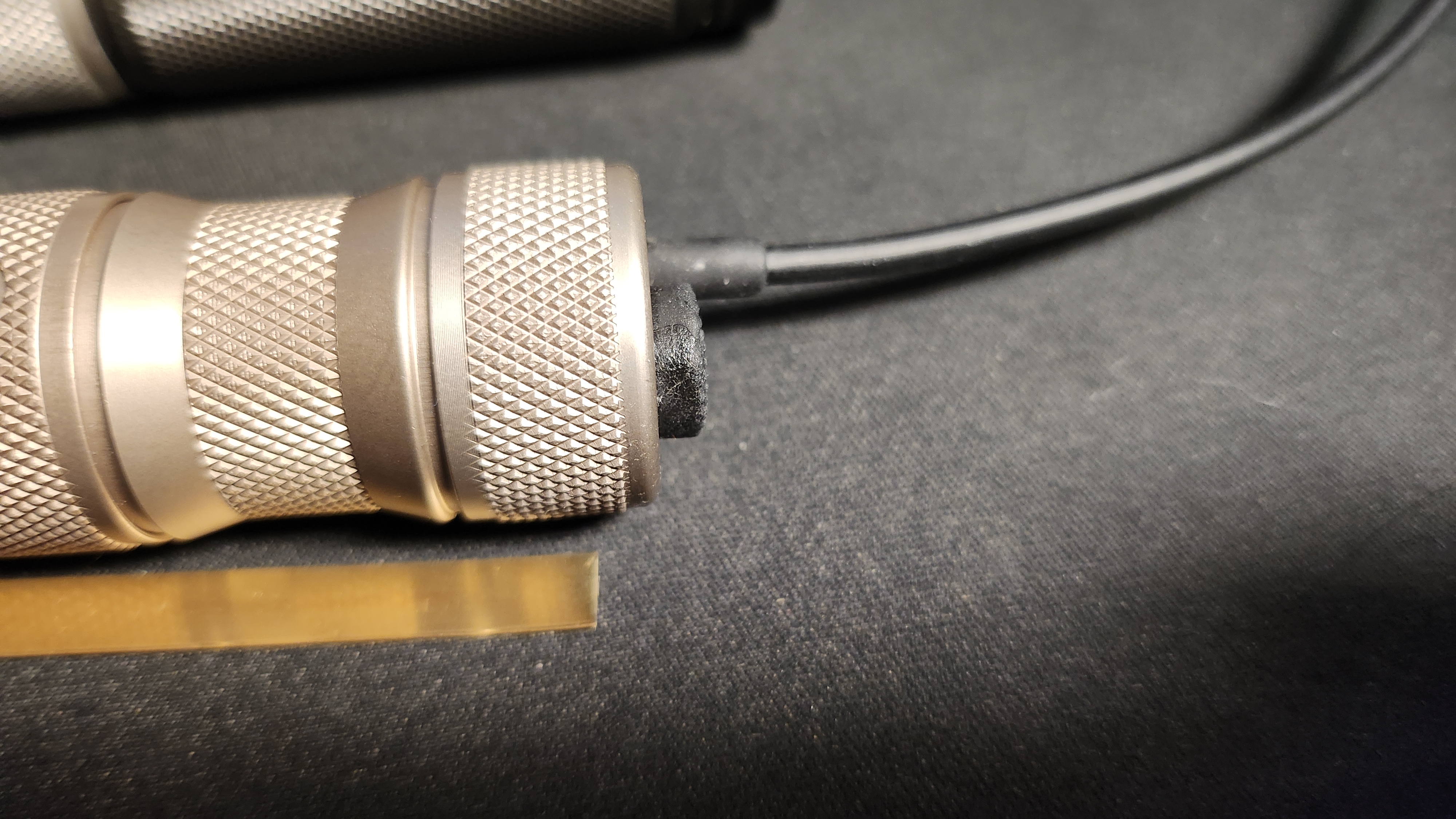

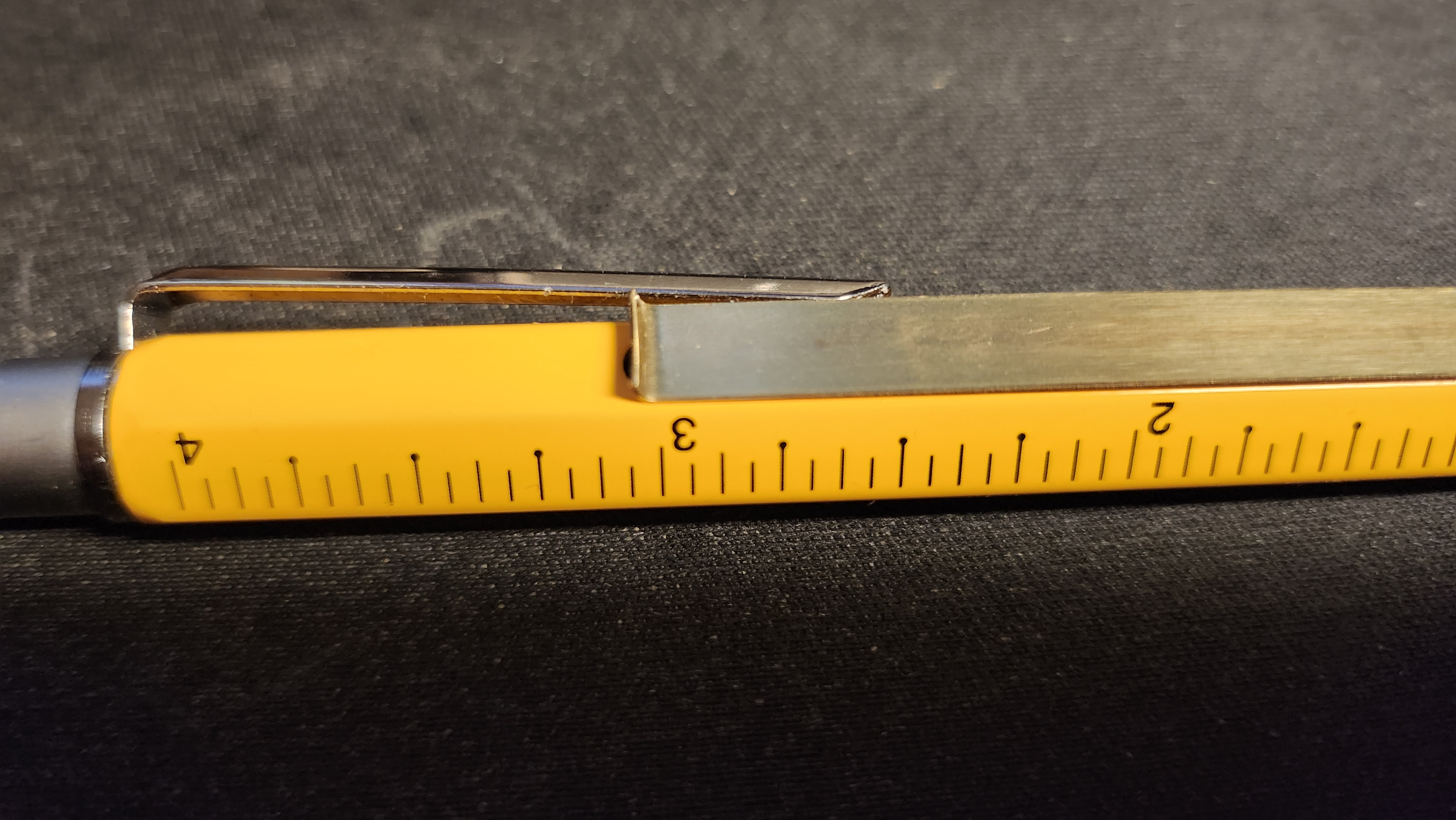

So...I went ahead and did the brass strip mod. The closest ACE to me is kinda far, and I couldn't justify driving that far for a $1 brass strip...so I did the next best thing and googled the company that supplies it. KS Metals, 5×36" strips of the 1/4"×0.016" brass for $16, or $3.20 per strip, or roughly $1.07 per foot, basically the same price as Ace. I also added a bag of random metal scraps, as well as a couple threading dies/bits, and they shipped it super quick.
So far the brass strip is working great, but I'm inclined to shove an extra Oring around the tailspring to ensure that the strip never makes contact with the spring. I'm not as worried about the outer retaining ring, as the mechanics of an inward bend SHOULD keep the strip from bending outwards.

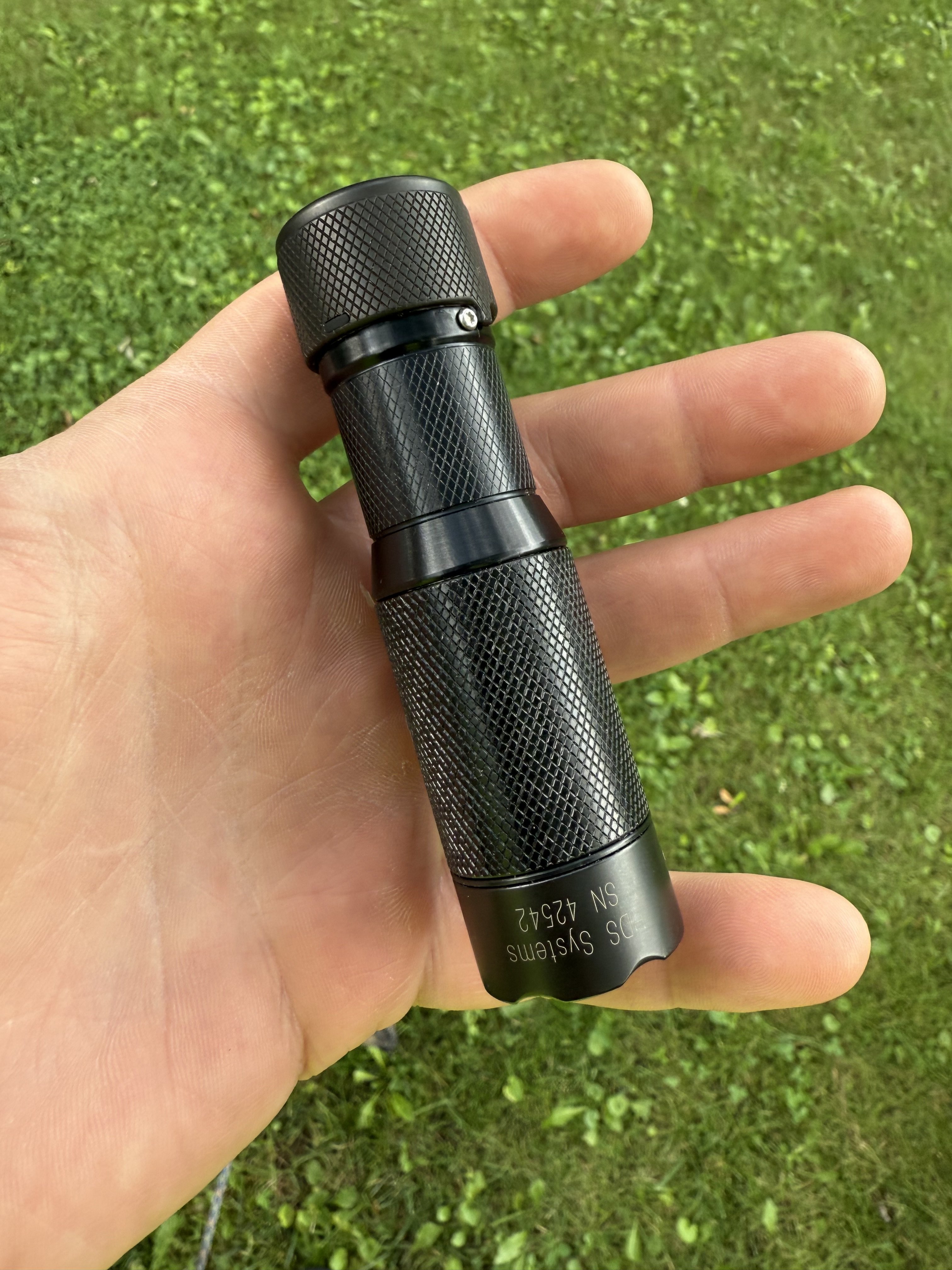

You weren't kidding. Nearly four months later, and I finally have my repaired Rotary back in my hands. Henry said he had to rebuild the head to fix the fault, so it's basically a brand new flashlight.
The Maglite XL200 was a worthy companion, but it's nice to have my trust Rotary back in my pocket.

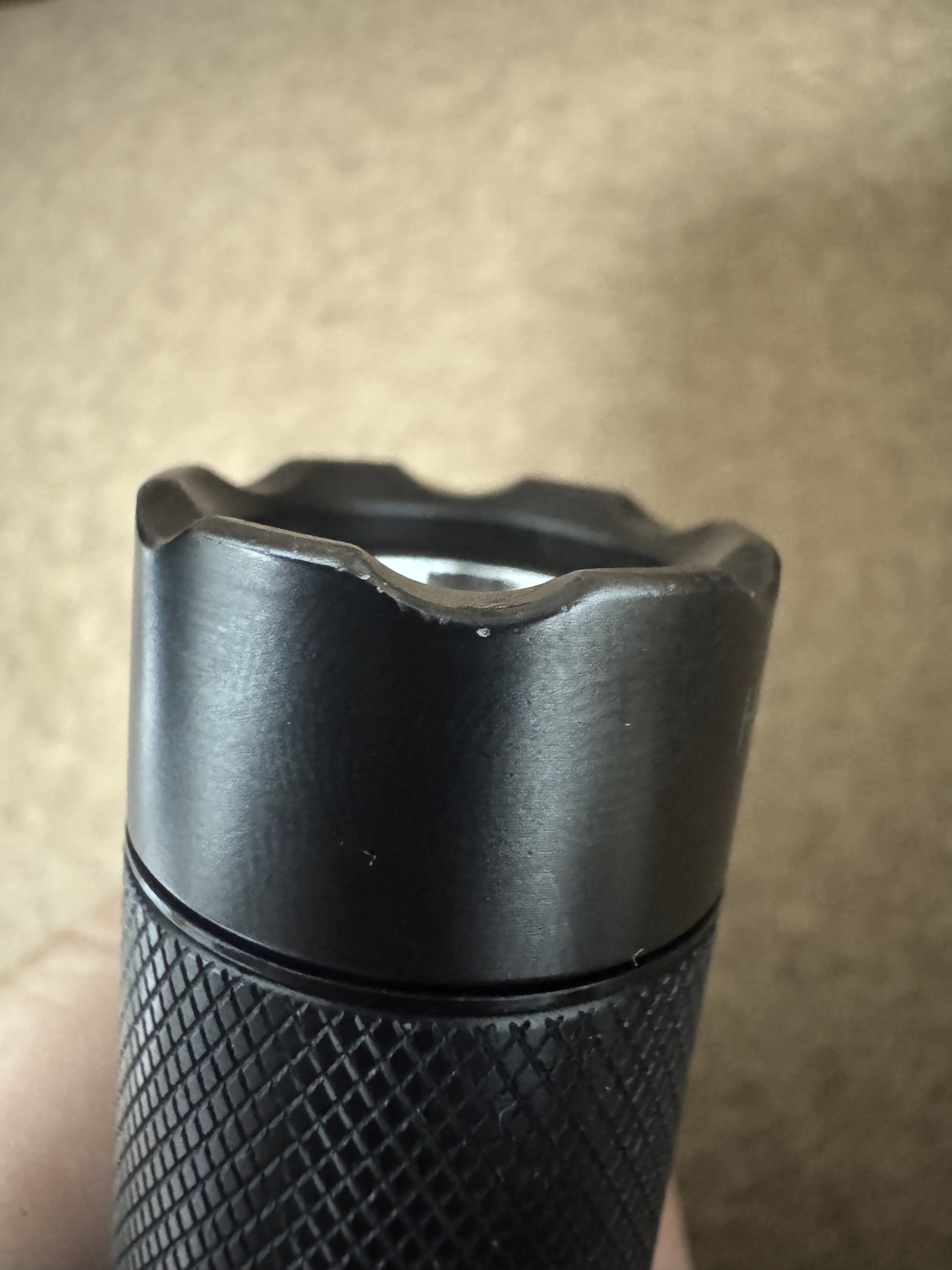

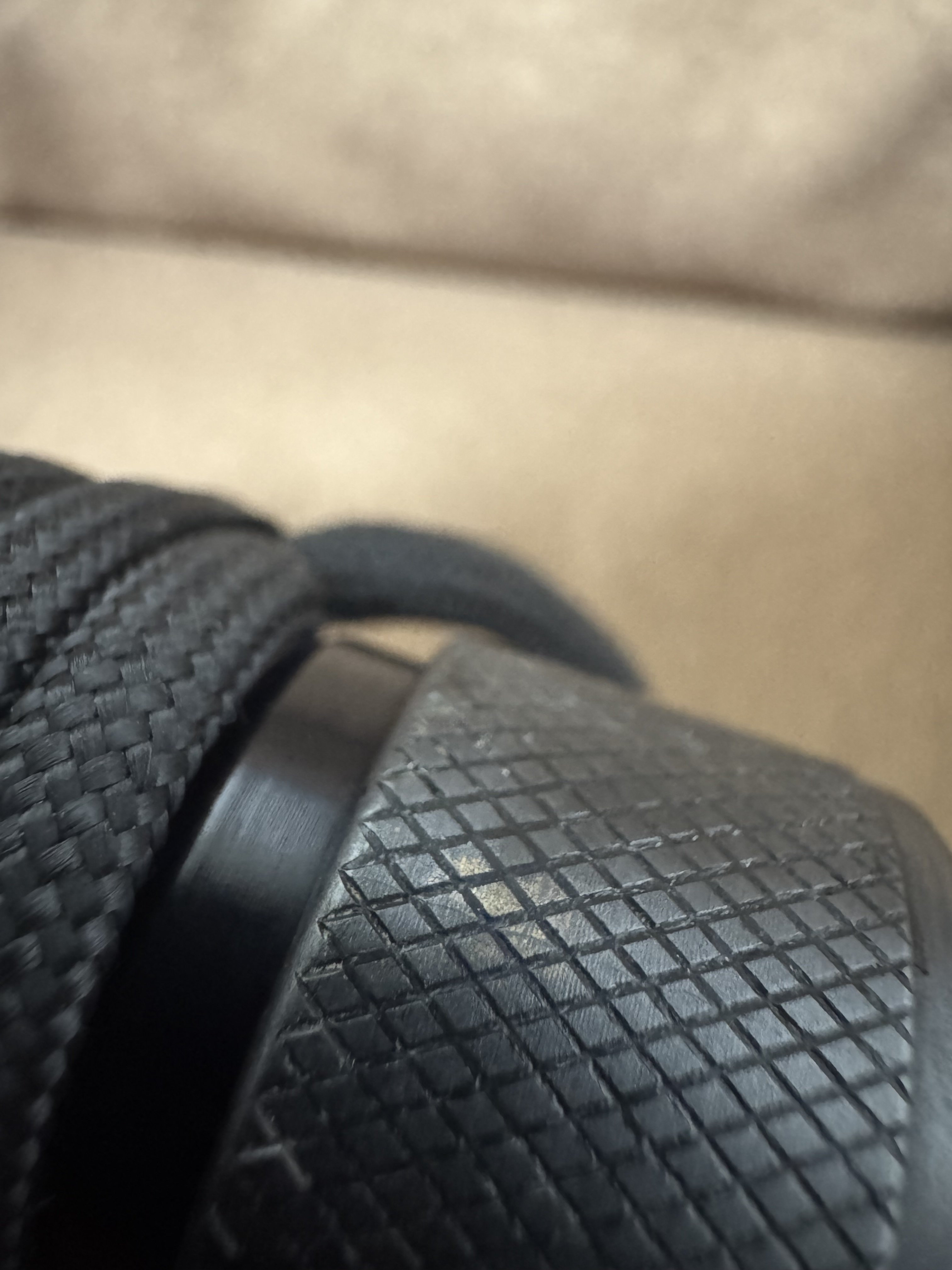

I recently received the NA45 I had ordered, and in my opinion, the beam looks very neutral to my eyes — I'm quite satisfied with it.
However, I noticed a small chip in the black nitride bezel, and there's also a copper-colored mark around the rotary knob, possibly from a clamp or tool used during assembly.
While these don't affect functionality in any way, I'm wondering if I might be being too picky about such cosmetic issues.

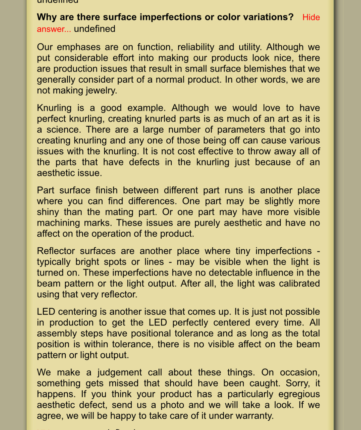

With what they charge? In my opinion, it had better be flawless out of the box. It's not an organic material like wood. Drop the price if you want to send me imperfections.
To be honest, considering the price, I do feel a bit disappointed. However, the light it emits is truly outstanding, so I've decided to treat it not as a shelf queen but as a practical tool for everyday carry.
I'd say those nicks are unacceptable on a $450 light. You are buying a brand new product. The product should be flawless, regardless what the price is.
Think of it this way, say you wanted to immediately sell it, you would now have to list the item as used just because of those marks.
I use my lights, so for me I wouldn’t be worried about it. It’s gonna get marked up anyway. However, does not add to the fact that a light that costs as much as they do should arrive like that.

Yes, you are being too picky.
