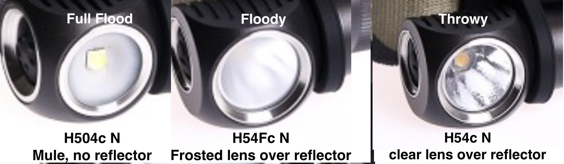

What's the difference between H54Fc and H504c?
Which one is newest?
They are all new, and use the same newest LED, 4000K 519a
H504c N is a Full Flood beam for very close range :
H54Fc N is Floody beam
H54c N is a more Throwy Beam, clear lens over reflector
I will use it for edc, traveling, camping and hiking so I think H54Fc N is the best for me?
I have been thinking about the full flood mule version as a close up light that I would hang off a chest pocket or web gear. I am curious about the difference between the full mule vs floody beam pattern...

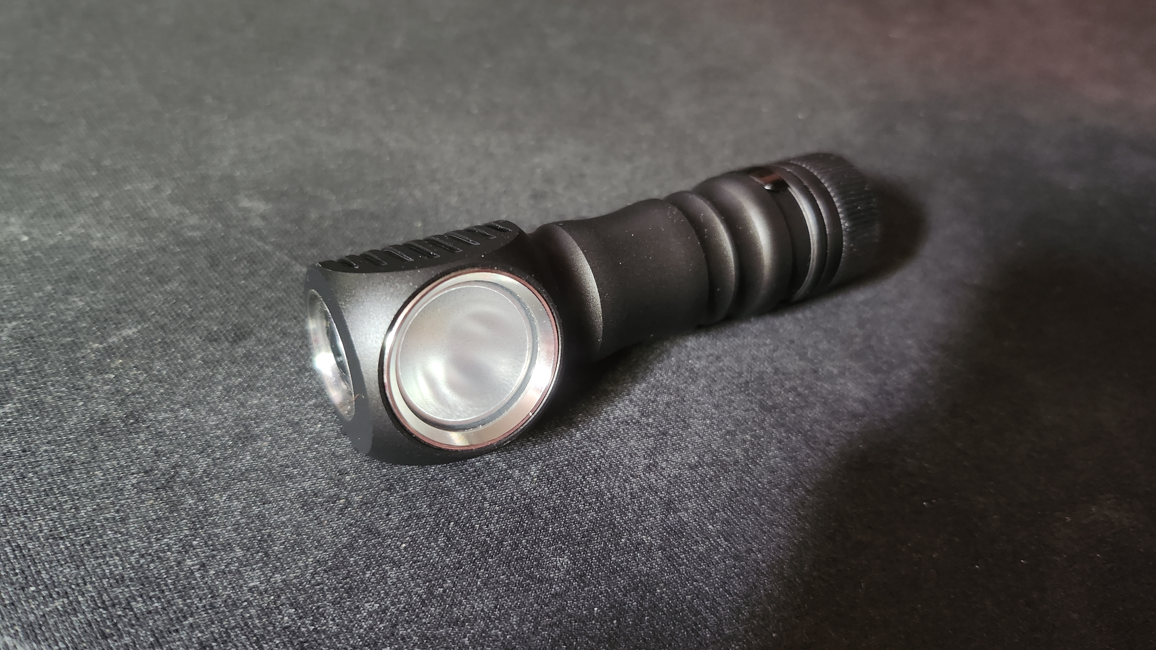

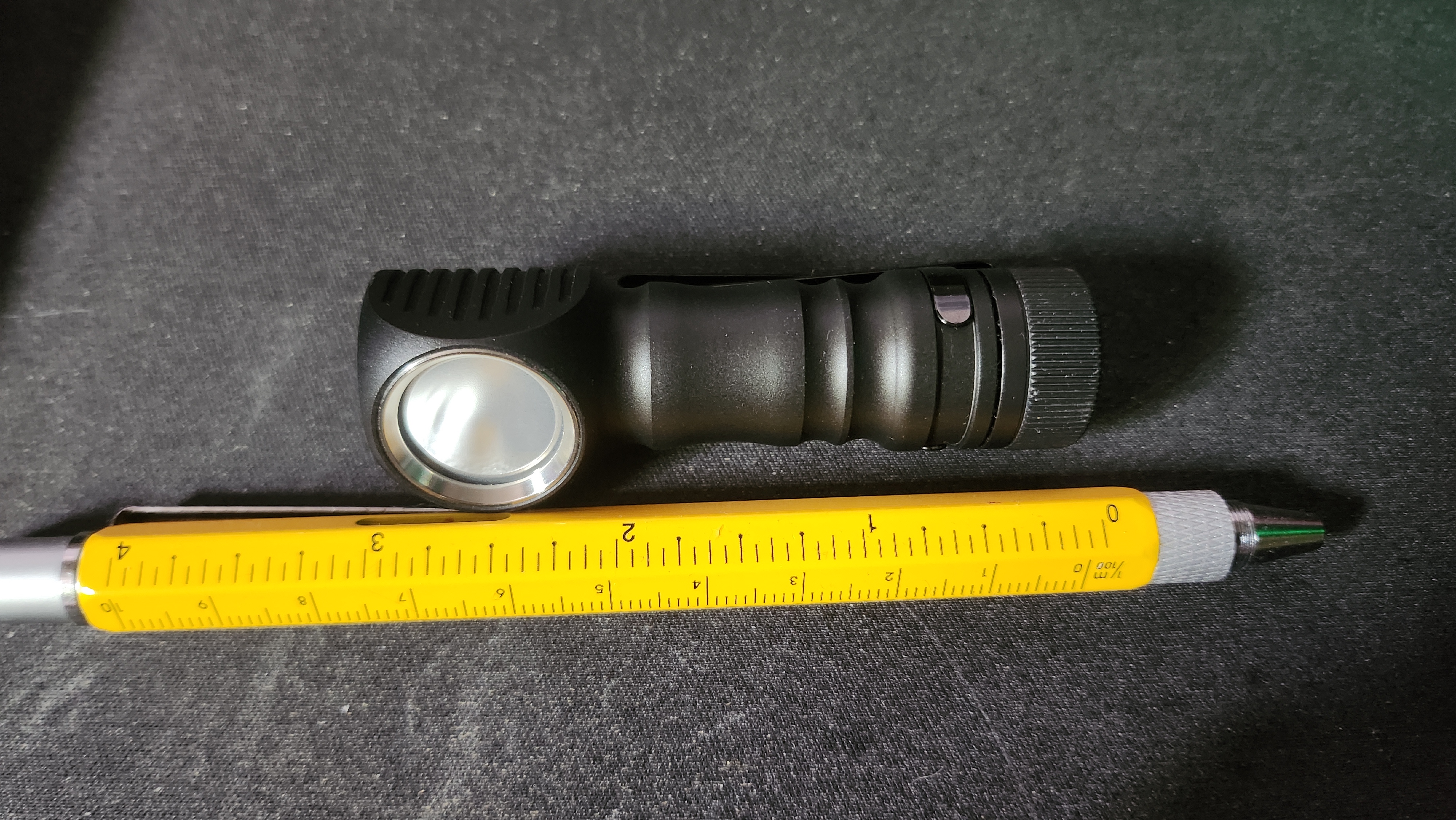

The new aa headlamps are also smaller, length is 6mm shorter and also diameter is smaller. I think the new lights will fell quite a lot smaller.
agree..
And the Zebra weighs less, has 4x the battery capacity, and offers higher maximum output

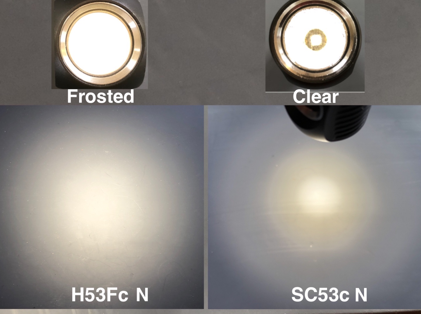

Is the clear lens considered more allround then frosted? Maybe the H54c N is better for me.
I have a strong preference for the clear lens, but it’s a personal thing, and a lot of people like their lenses frosted. Frosted is better for up-close work, no doubt.
But I always figure that it’s easier to come up with a field-expedient diffuser than a field-expedient concentrator. And I often stick a pre-cut disc of DCFix onto the battery before I slide it in, so that I’ll have it if I want it.
