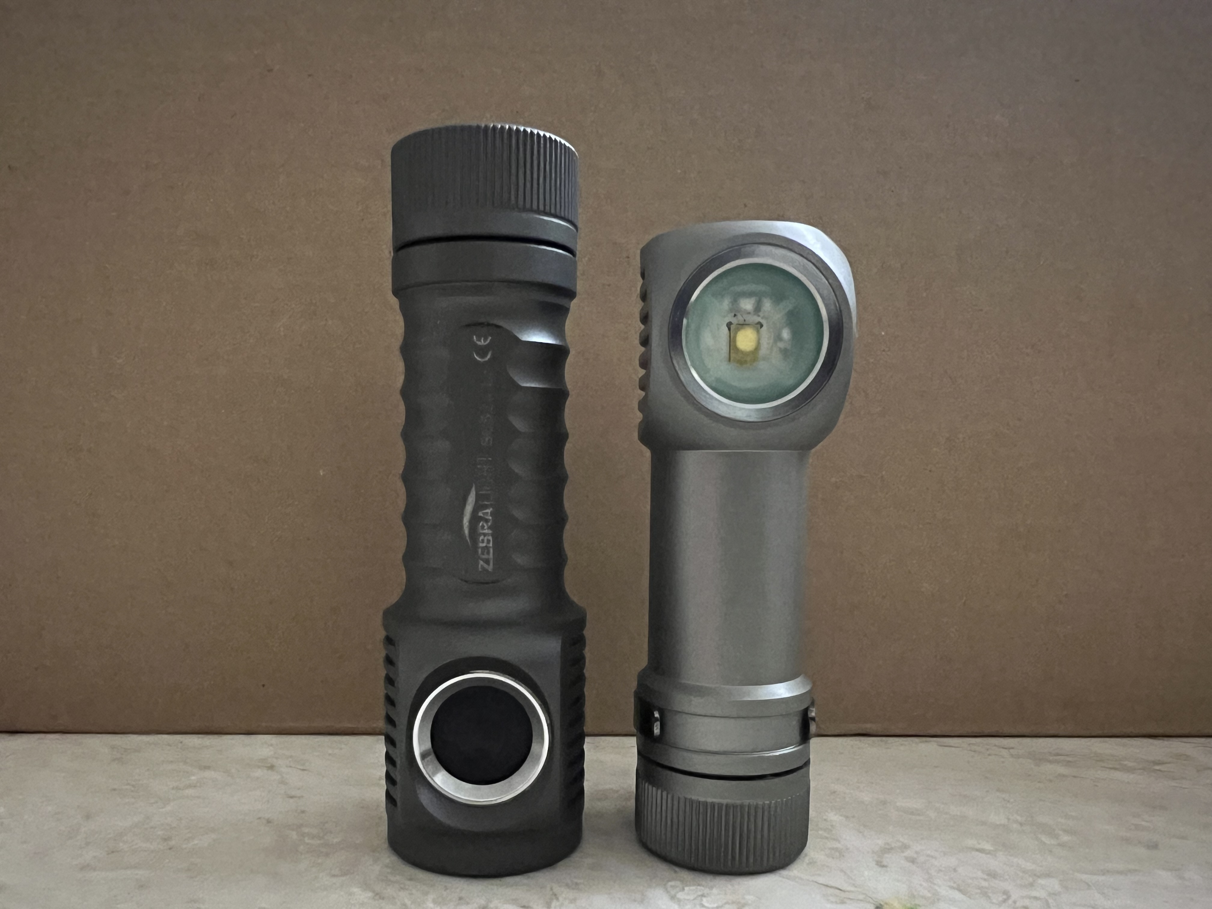

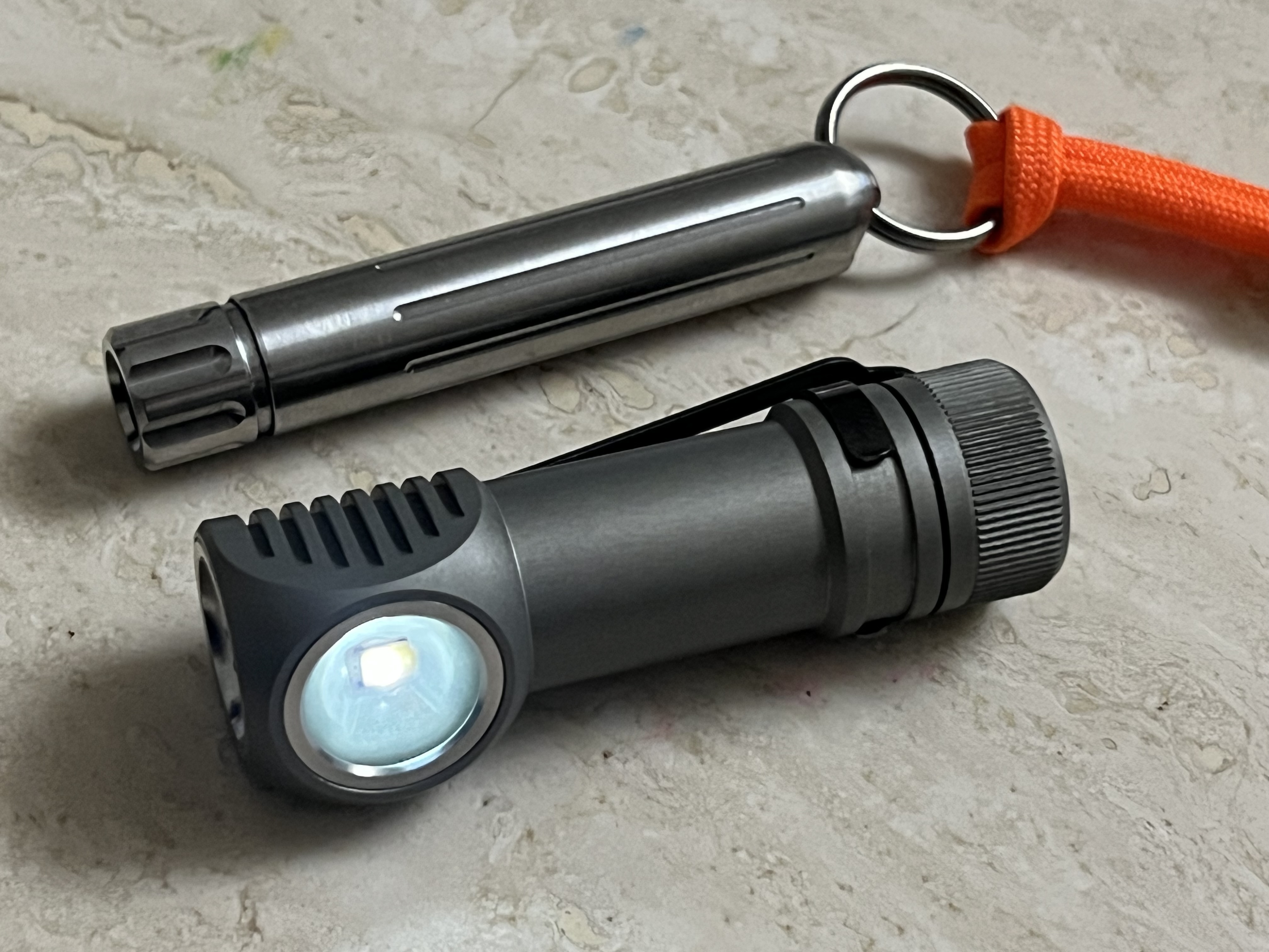

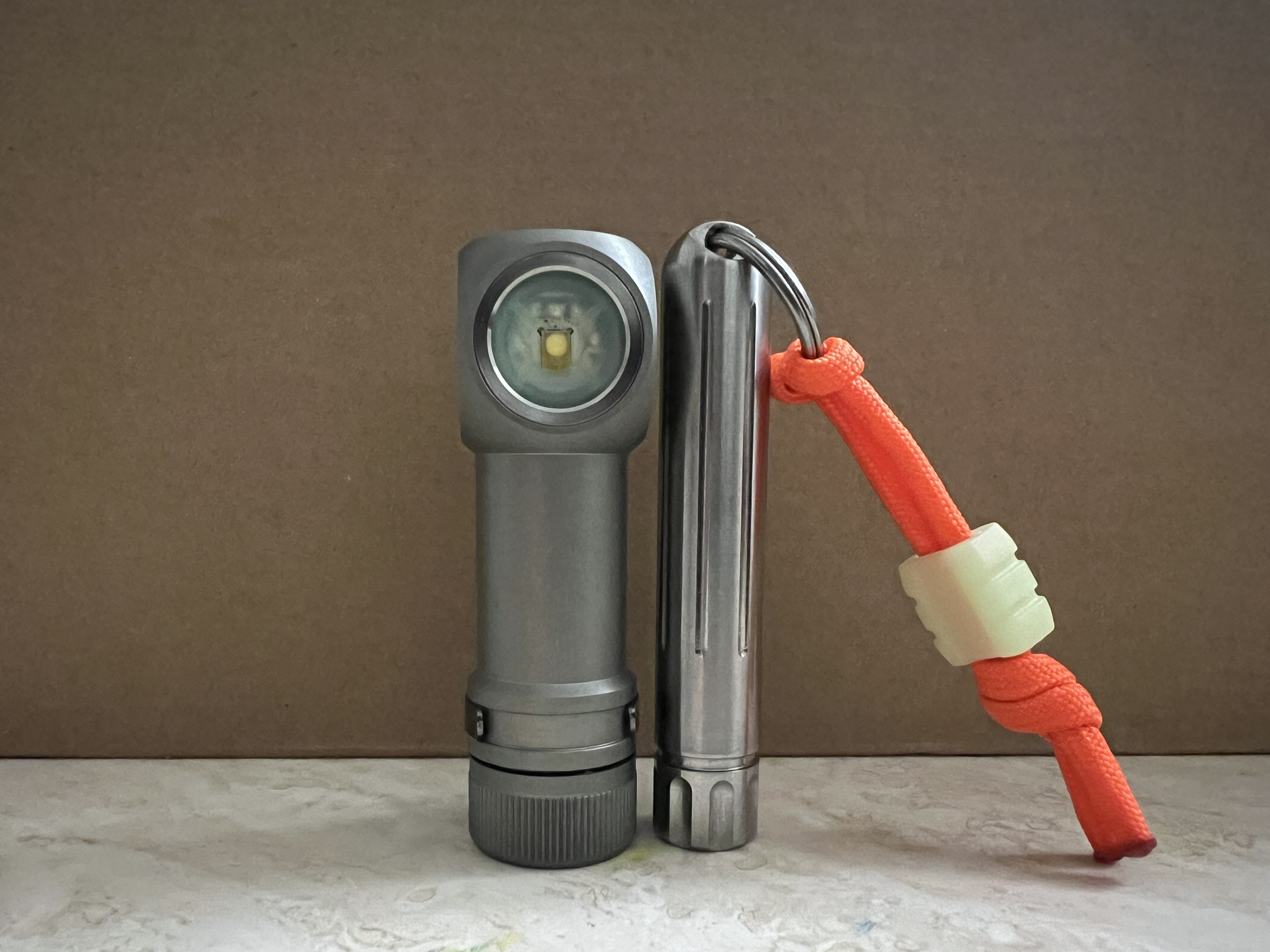

Anyone remember how tiny the AA lights were?
Here’s an H502d (from memory) that I dug out.
Makes the current AA lights look big by comparison.
Beautiful beam and tint and so tiny.

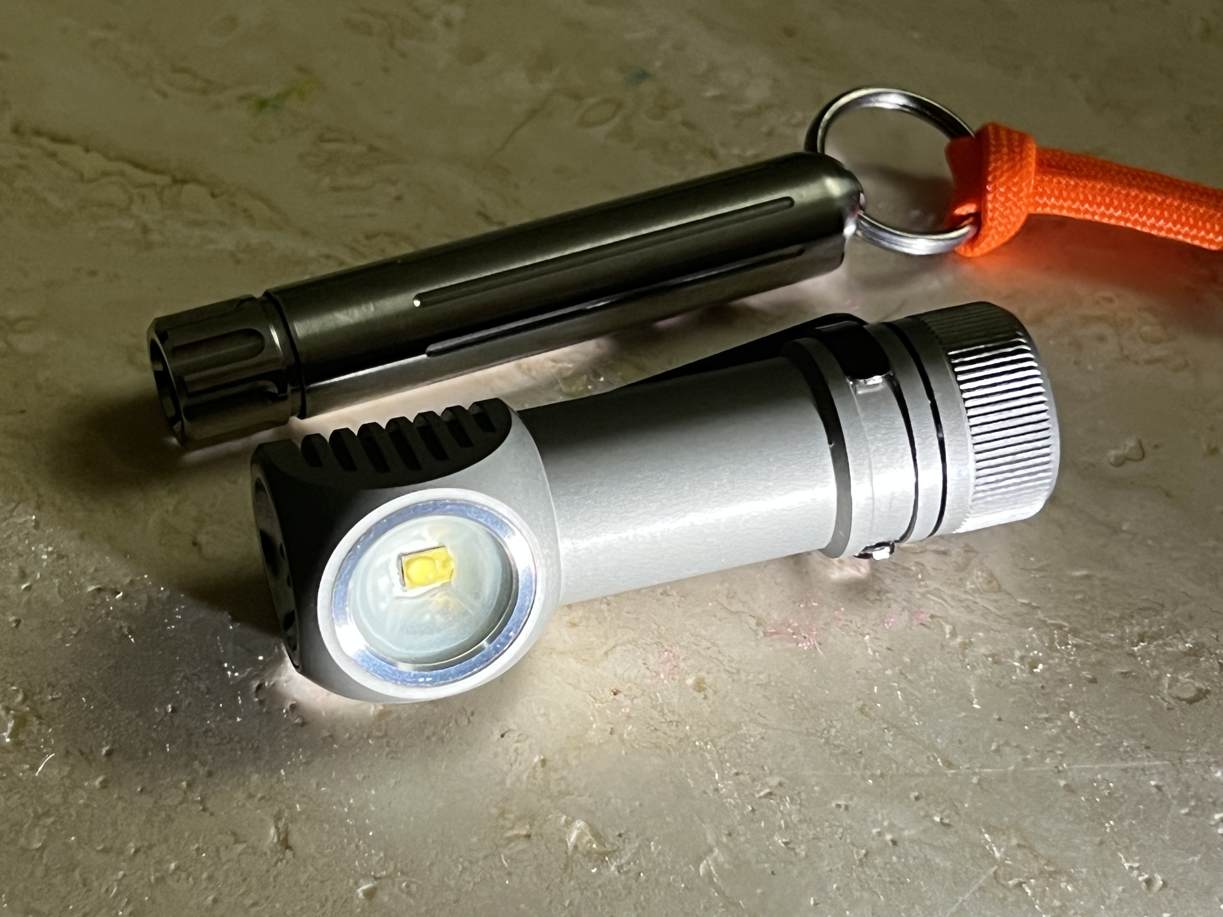

Here's some more emphasis on just how tiny this light is.
Next to McGizmo Sapphire
ZL H52w L2
ZL SC52w L2

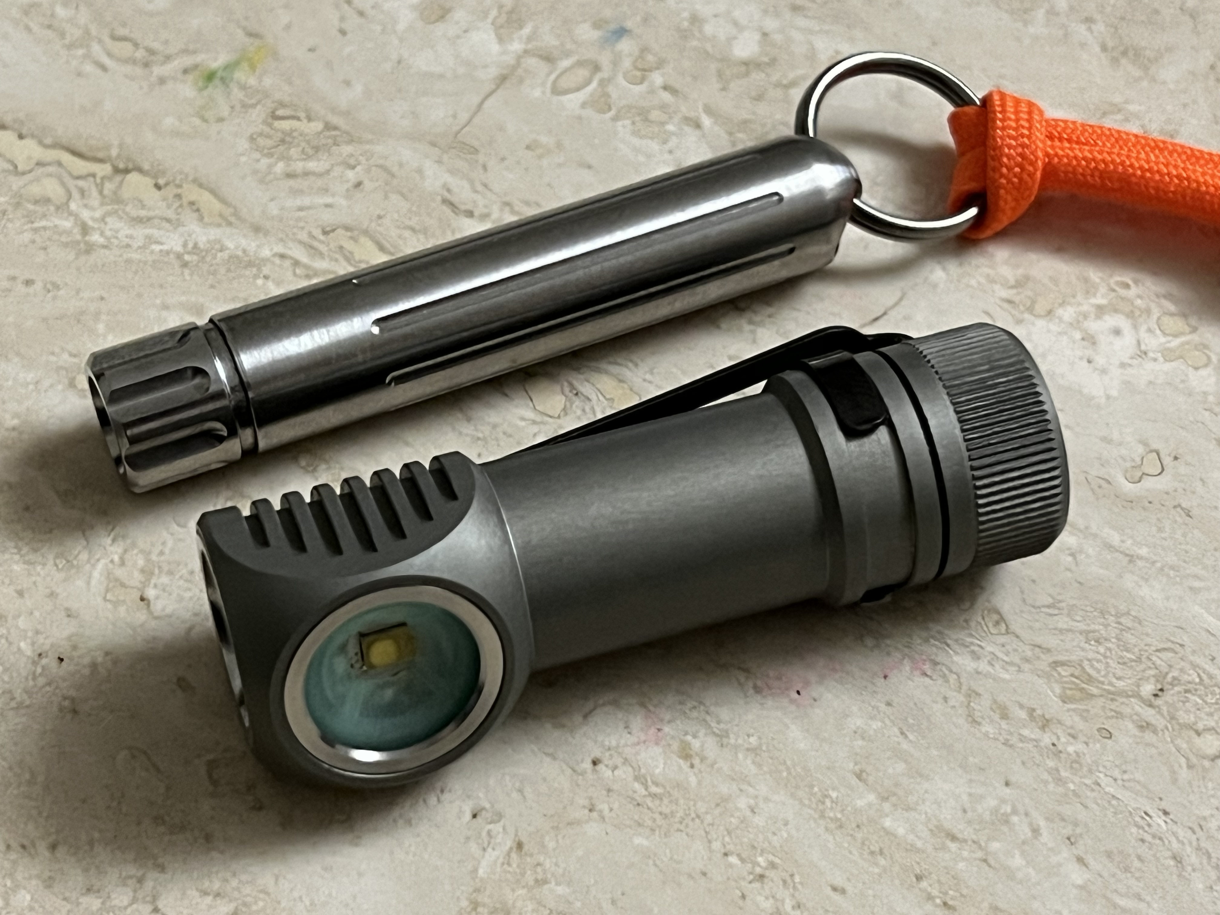

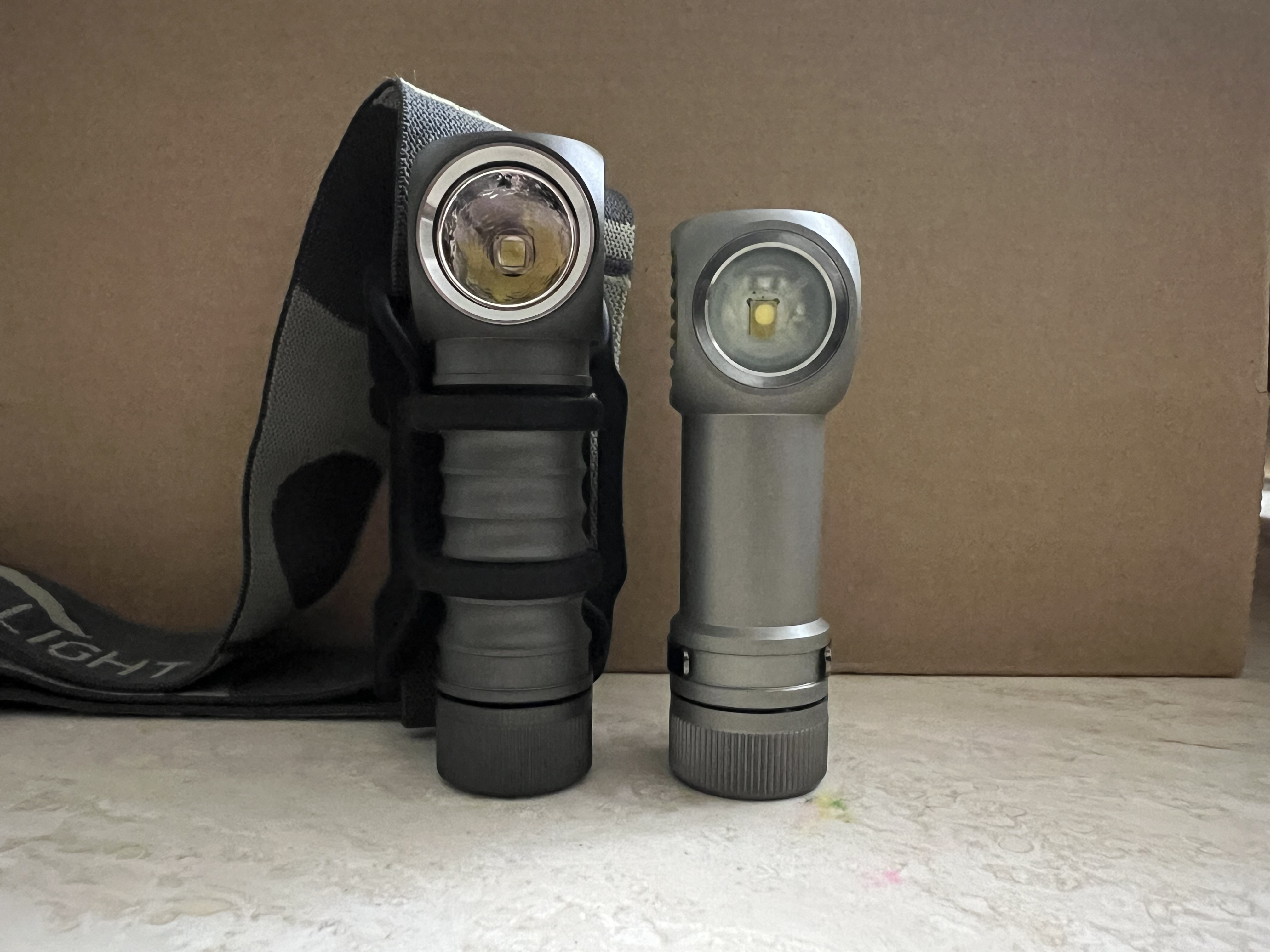

Here's an H502d (from memory) that I dug out.
View attachment 79338View attachment 79339View attachment 79340View attachment 79341View attachment 79342View attachment 79343
They haven't gotten bigger; you're just comparing different models. The mules have always been smaller because they don't need to fit a reflector. Compare yours against the current AA mule and the new one is either the same size or smaller.
Makes sense. This one even fits loosely in the head band holder as the tube is so thin with no ribbing or moulding.
If the new ones are actually smaller then they're extra tiny.
Haven't bought a ZL since the H52w L2. The beam shots of the new 519a models (with reflector) look disappointing. The XML2 in the SC52w and H are actually really nice. I hadn't taken the 502d out in ages and was reminded how nice it is, and tiny of course.
Just looked up the same specs. They’re the same length as the new one but have a skinnier body.

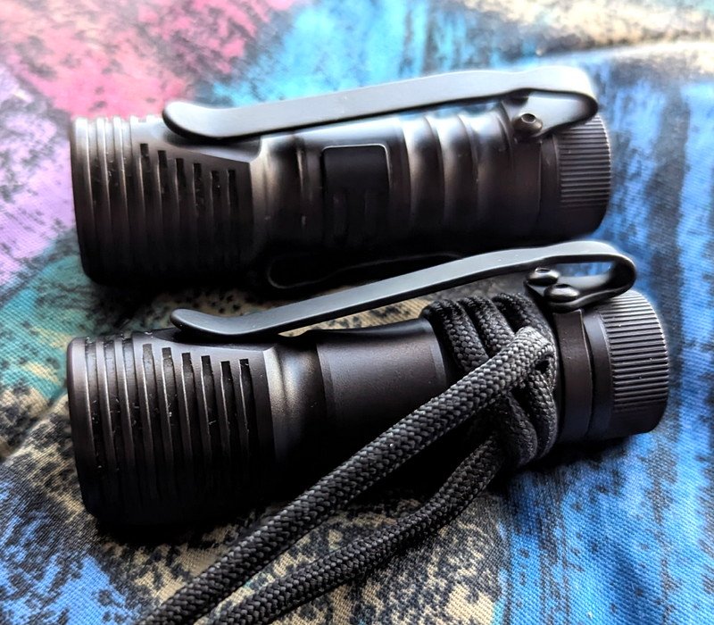

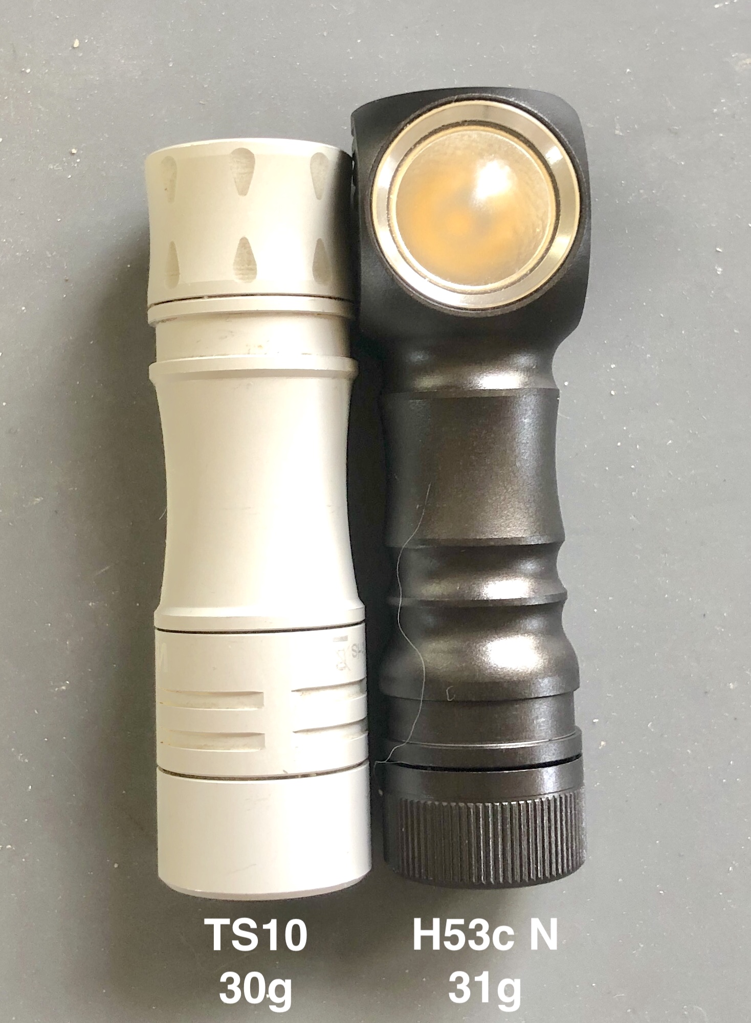

My clip weighs 3g. The tailcap looks to be from another model, so but that's not likely a 5g difference. Of course my scale isn't calibrated either. Pretty light flashlight for a AA model.
It totally is! With a lithium primary, I'm scared to pocket carry it because the slightest bump might cause it to float away
you can check by using a known weight, such as a US Nickel coin, which is 5 grams..
My H53c N weighs 6 nickels and 2g with no cell installed or clip on my scale. My scale doesn't have tenths of a gram. I did see that 10 nickels weigh 50g, but 11 nickels weigh 54g . . .

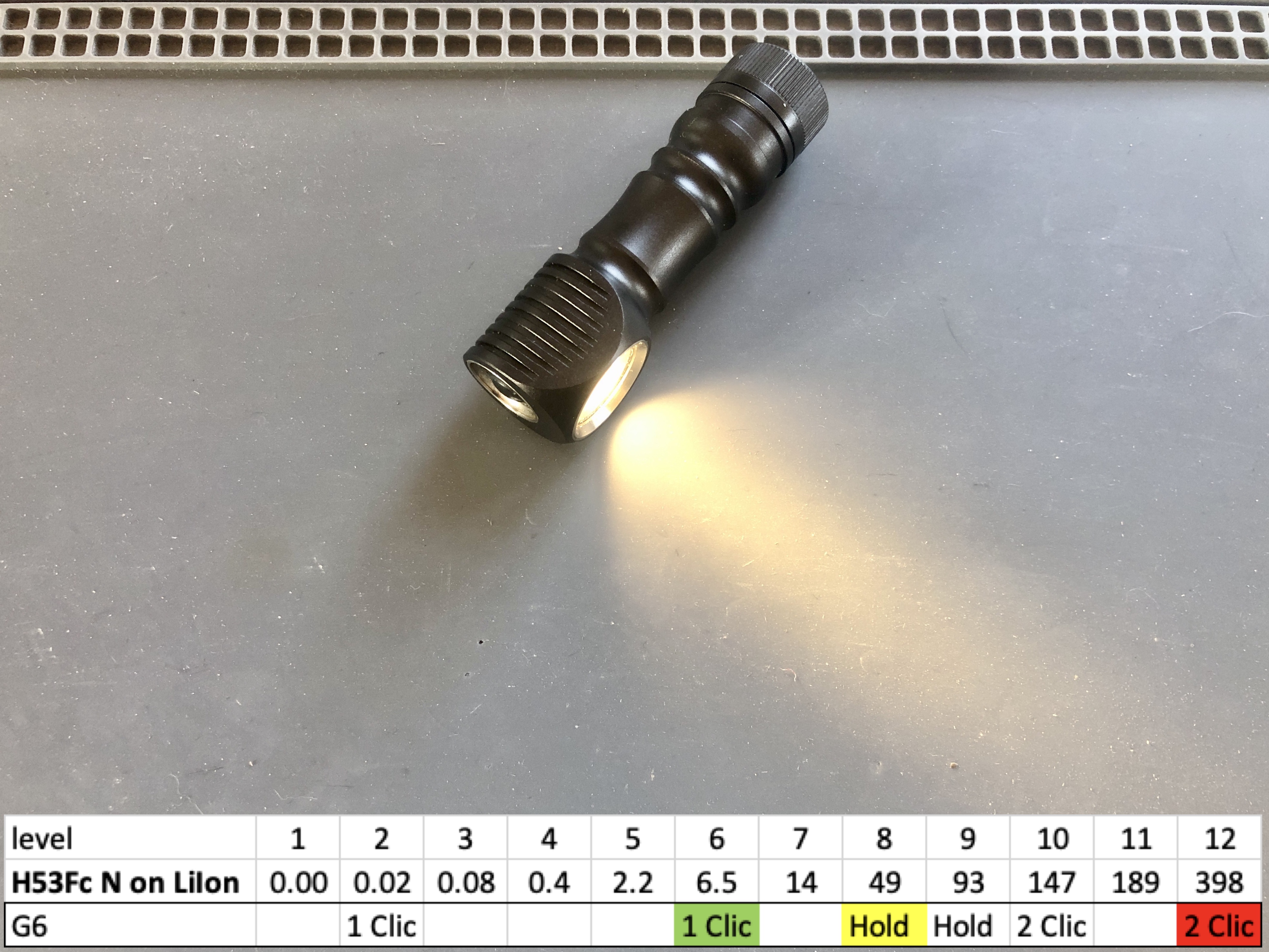

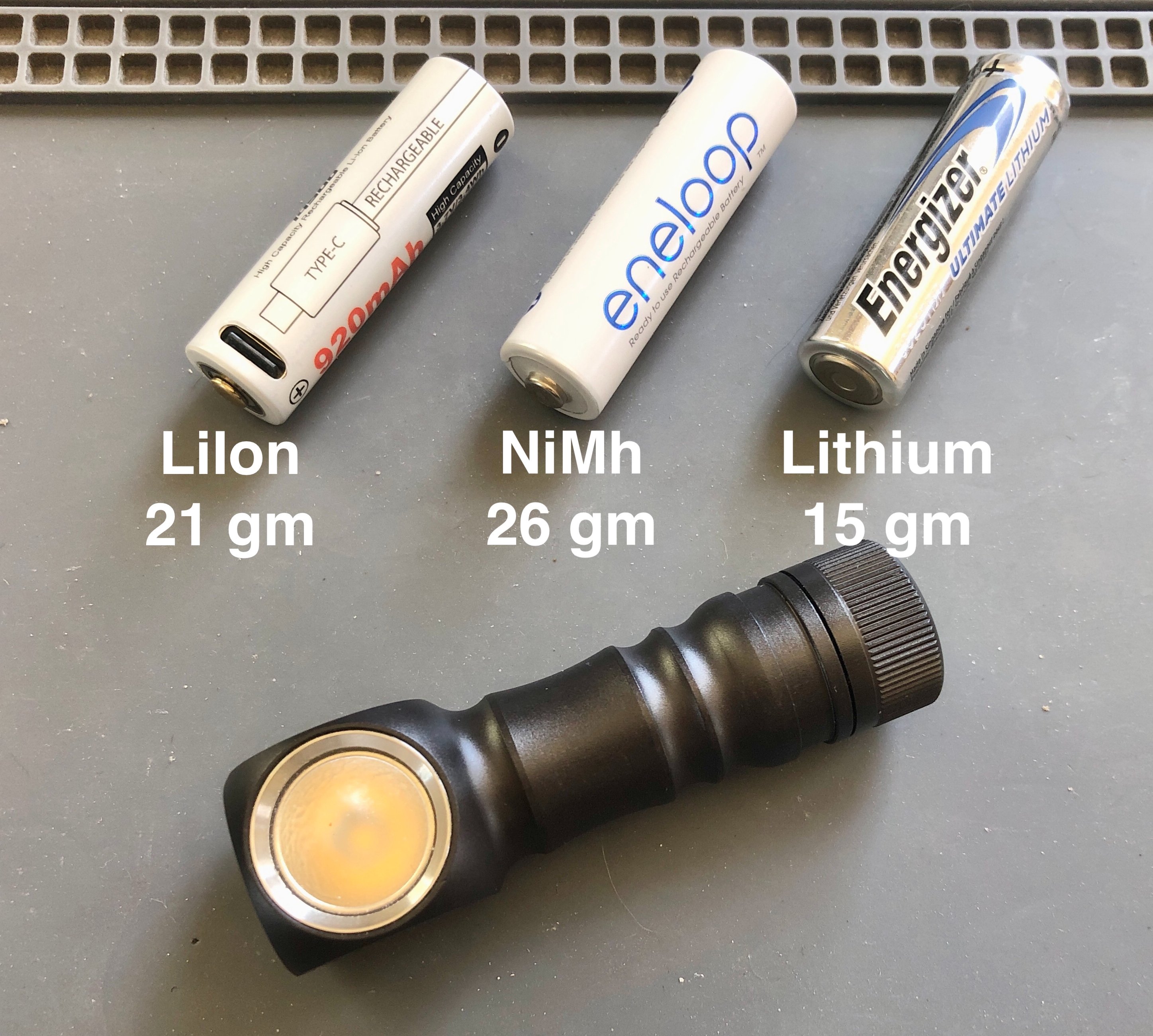

I weighed some batteries, 14500 w USB, AA Eneloop, AA Ultimate Lithium: to
my G6 outputs levels
1C: 3, 5,
Hold: 7, 9,
2C: 10, 12
Eneloop vs LiIon:
Was surprised, that's quite a difference in weight.
AA alkalines, probably the most common of disposable batteries avg. 23 gm.

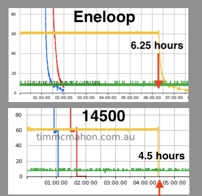

you could test AA Ultimate Lithium until it drops out of regulation on default M1 (level 8)
If you have the ability to observe the M1 output, so you know when the light drops out of regulation,
suggest you use M1, since we have data for that thanks to Tim McMahon:
2450mAh Eneloop: 6.25 hours
920mAh LiIon: 4.5. hours
920mAh LiIon: 4.5. hours and
Similar power densities but disproportionate runtimes...2450mAh @1.2V vs 920mAh @3.7V...must be some inefficiency with the driver at certain modes, or the 14500 is not utilizing ALL its power...
yes, heat from the LiIon voltage being stepped down by a linear resistor:
On the SC53 models it's a boost converter for the Alkaline and Eneloop batteries. Your gonna loose some efficiency getting the 1.2 to around 3v.
Using the Lith-Ion the SC53 light has no Buck Convertor but uses a linear regulator-resistor design to lower 4v down which your going to loose some efficiency on too
Even though LiIon is less efficient.. it is guilt free fun, because the batteries are rechargeable ;-)
It is very impressive to see almost 400 lumens coming out of my tiny H53Fc N
LiIon runtime surpasses Eneloop, when using 1250mAh instead of 920mAh:
I ran a bunch of test at 198 lumens using Sc53 and the Vapcell F12 1250 mah beat the Eneloop Pro by a substantial margin at that level.

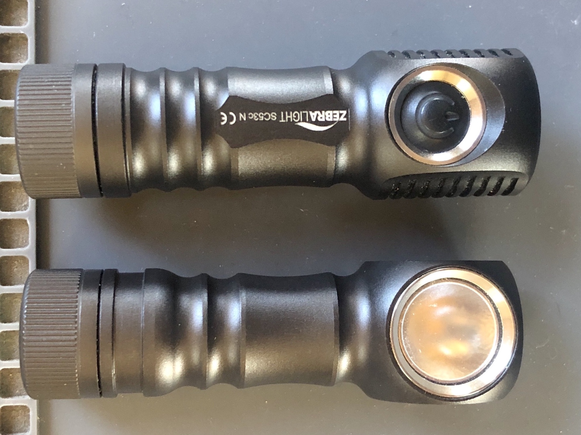

After rediscovering my zebras I've gone back and had a look through a bit before my recent post. It's been interesting to see what's been about since I've last looked at ZL although not much seems to have changed for my tastes.
I did a quick measurement of the old H502d against the online specs of the modern counterpart. The old light is a touch over 1mm shorter and a fraction narrower at the head (measure lens to rear) and a bit over 1mm narrower if their measurement is side to side. They don't give a measurement for the body but considering the old light fits loosely in the headband holder I'd say it's definitely narrower.
