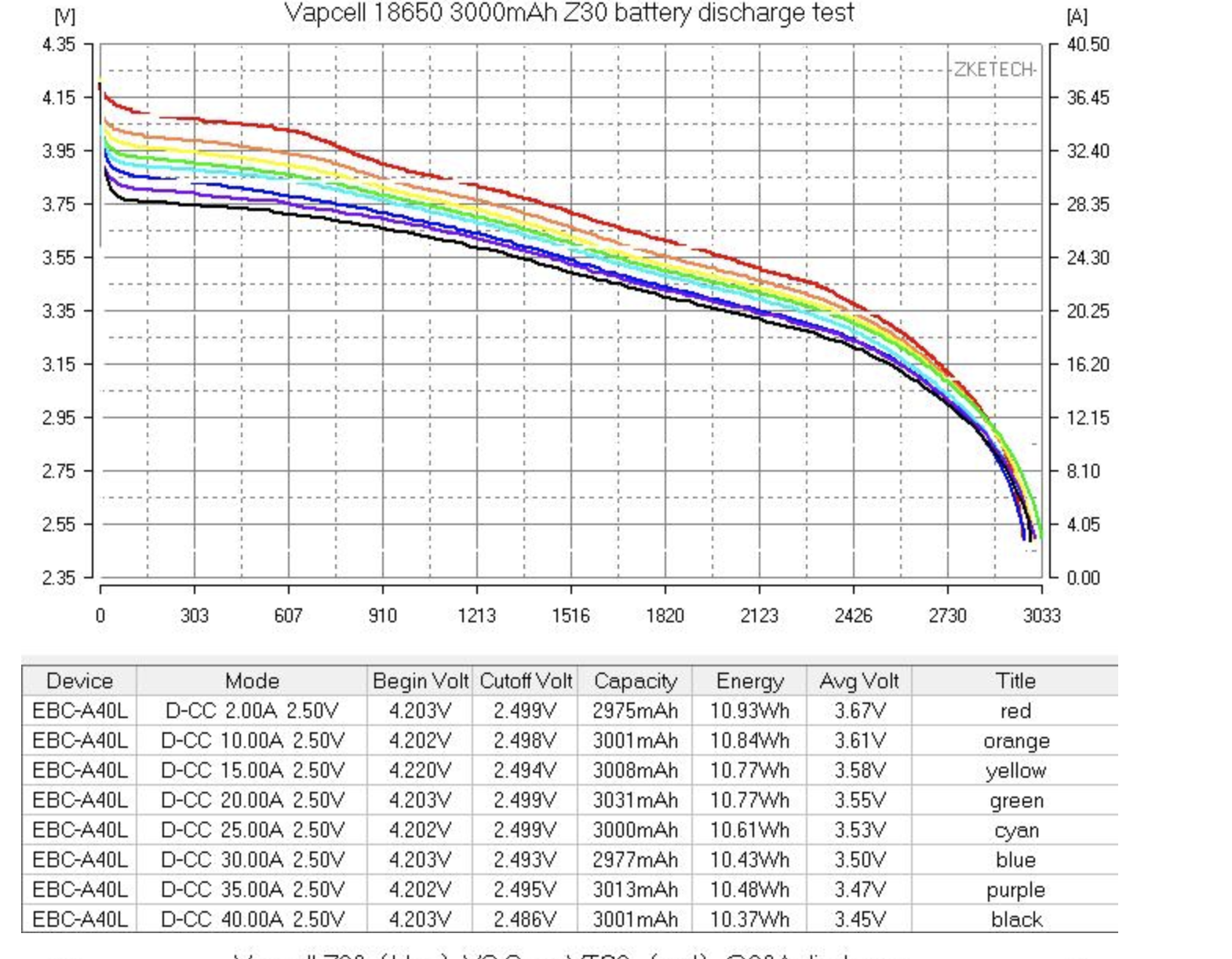

The capacity at 50A is probably doodoo, they CAN hit that peak sustained, but the power delivery is probably like 65% or so...I have just ordered some and will be interested to see how they test. My instinct is that I wouldn't be rating them at 50A. But the test data on the Vapcell website shows no dropin capacity up to 40A. In fact capacity at 40A is higher than at 2A. I would have said that's impossible, but I am ready to be proved wrong. Intyeresting that they don't show results for discharge at 50A.View attachment 79522

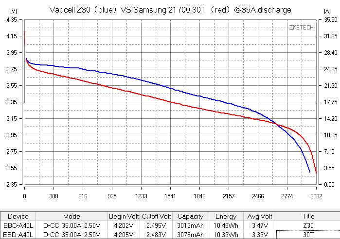

You can already pull 35A from a Molicel P30B, so it's certainly not missing a decimal, as Vapcell wouldn't release a battery with 30A less CDR and the same capacity as a popular battery.If the cell delivers 3ah and you try to pull 50a from it, you'll get about 3.5 minutes of runtime. If your battery contacts don't melt first.
I'm thinking there's a missing decimal point and the actual maximum draw is 5.0a which is much more believable.
Interesting; thanks jacobd.You can already pull 35A from a Molicel P30B, so it's certainly not missing a decimal, as Vapcell wouldn't release a battery with 30A less CDR and the same capacity as a popular battery.
