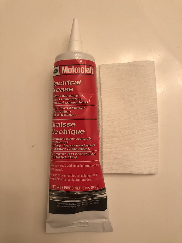

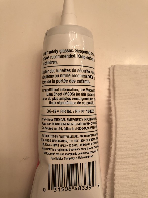

I went to my Ford dealership today and bought a Tube(87grams or 3 ounces)of their XG-12 grease for approx. 13 dollars. It is the same as Nyogel 760g. I called Nye lubricants to confirm. Best price that I could find for the quantity. I just wanted to share, because I thought it was a great find. Sorry, if this has already been mentioned.

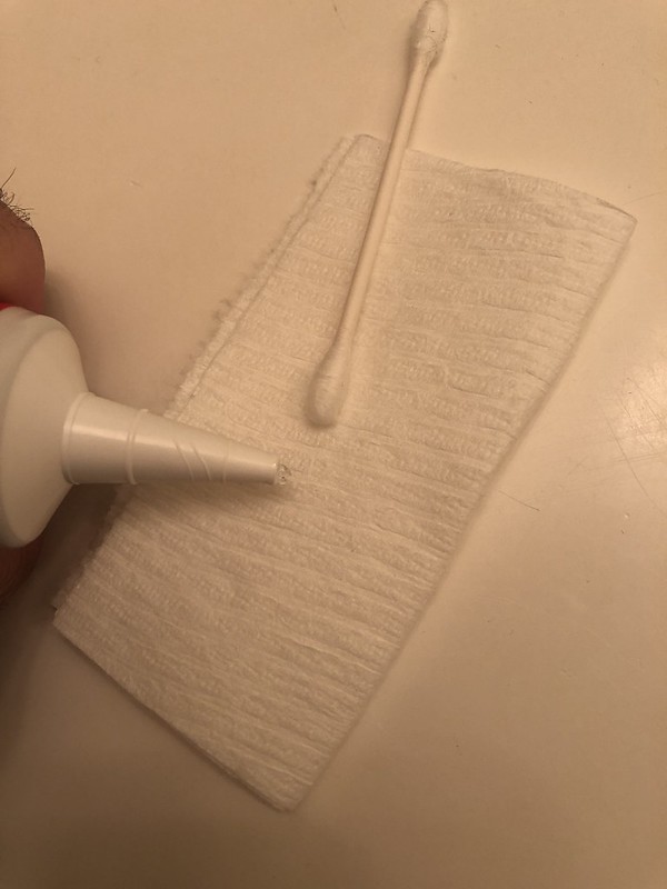

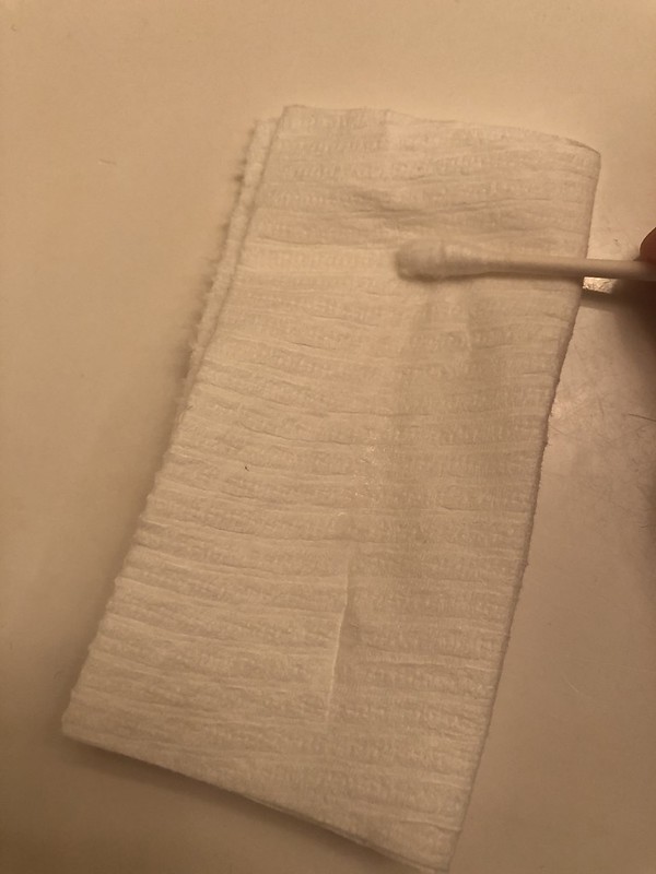

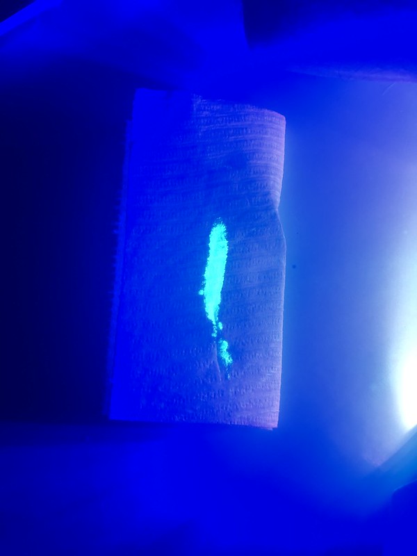

V
Went ahead and tested to see if Ford's Grease had the UV Tracer in it.
Threw some on a piece of toilet paper and hit it with UV light.
Glows just like NyoGel 760G!
well well well..... Ford's Grease appears to be the same indeed.
