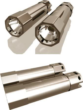

HF - Ti artists impression
The bolt edges are slightly rounded so you dont hurt yourself and slimmed down to the final spec profile.
Its a little hard to grasp how small this is from the images but in Ti, this will be one very sweet light'in'bolt!
tgwnn
p.s. the lightning bolt logo is optional
planning to add serial number somewhere unobtrusive.
the other markings (arrow and off) won't be in the final version.

Serial maybe on bottom of tailcap? Other side of center could just be MBI? I like the idea of having the outside completely untouched, especially if there isn't any knurling. Just my opinion.

That looks fantastic!! I love the bottom of the tailcap idea, but it might wear pretty fast. Also...what is the UI? Turn for light, turn more for WHAT THE HOLY HELL(?)

At 600 lumen and being that small, how do you think the light will cope with the heat build up, especially since its titanium?

I don't understand this obsession with minor differences between titanium aluminum with respect to heat buildup. In a small light you're limited by heat capacity, not heat conductivity. Unless you immerse the light in rapidly flowing water (Or mercury) it will continue to heat up until the LED, driver, or battery fail. Small light and high power ===(A million times equals)=== heating up quickly. Copper would heat up a bit more slowly due to high heat capacity. I don't think a 10280 battery exceeds the ability of a good thermal path to titanium, steel, copper, aluminum, brass, or most metals, to move heat to the body. But no metal will cool it off quickly enough.
