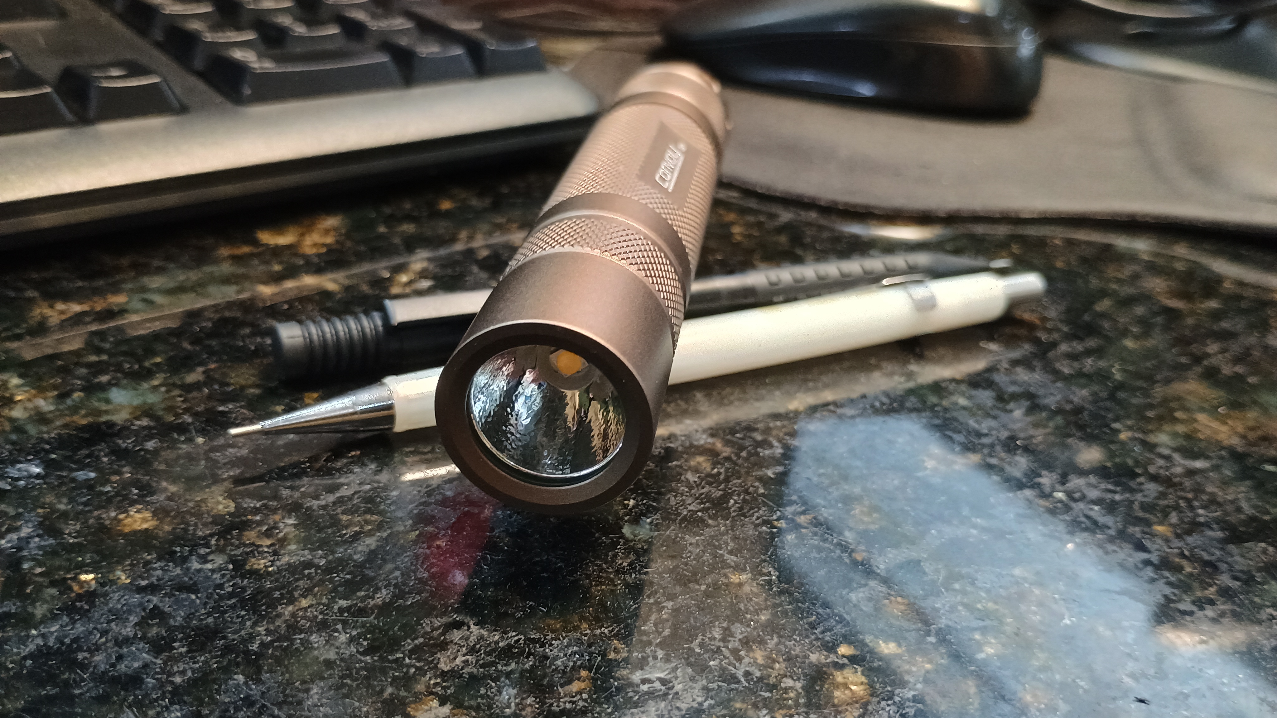

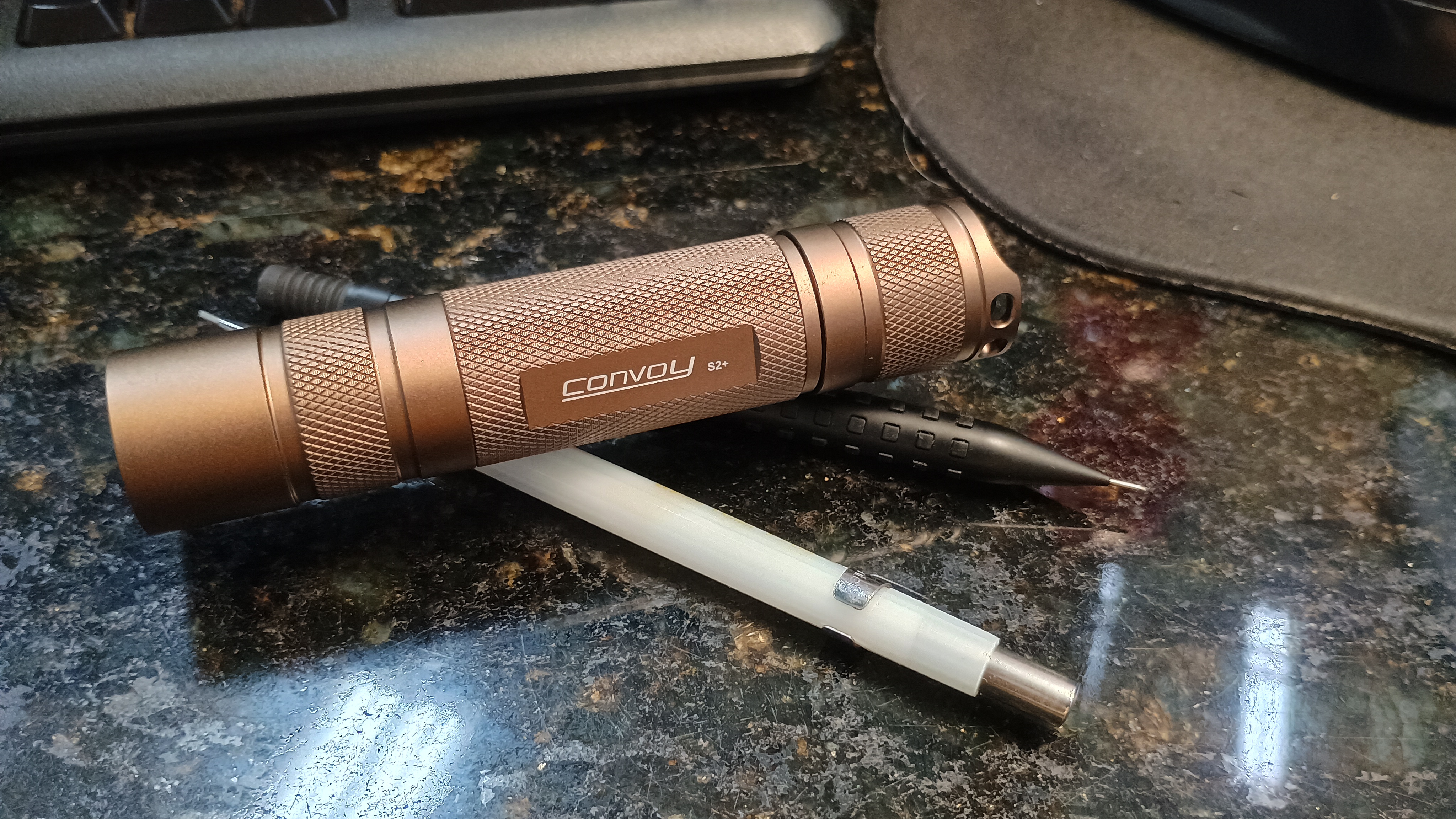

Got this one to test a few things: metal switch (feels nice), buck driver (a lot less hot than a comparable linear) and the desert tan anodizing (good, feels more solid than the bright colored ones like red or orange).
A shot of the emitter (519A 5700K):
I already had another good light with this exact emitter, but it has a linear driver, and I wanted a slightly more compact package for pocket EDC – the S21A is nice on the hand but it bulges a bit when stashed by the wallet and takes some finagling to fit inside the coin pocket; the S2+ is only slightly smaller, but just enough that it has neither of those issues.
(Don't mind the Pentels, I had to prop it up so it wouldn't roll off lmao)
In the same order I also got an S15 host that I'm gonna put together with a B35AM 4500K I have as spare.

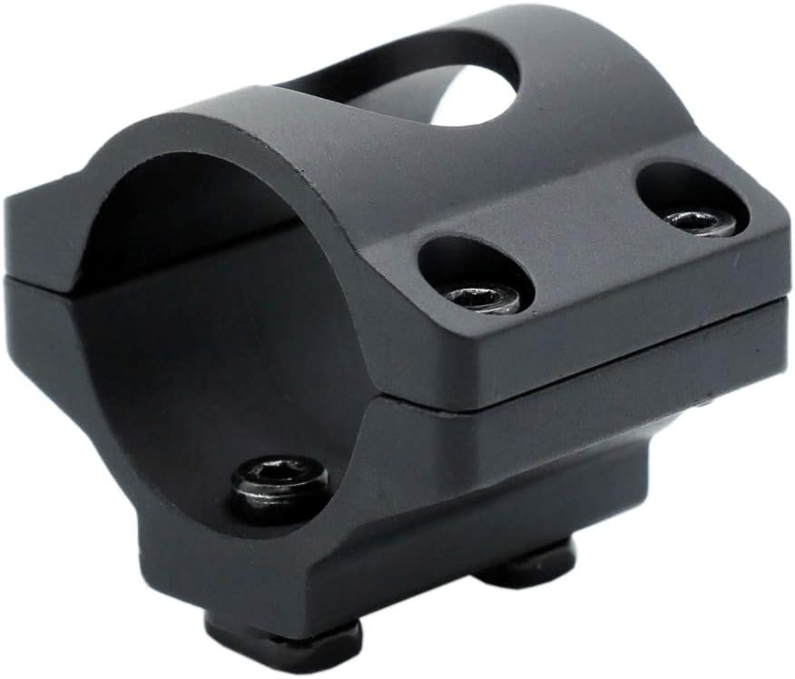

thinking buying a MLOK weaponlight mount and getting a S21E in 5000K for it,, same optic
If you do, tell us if it's holding up.
Personally I'd use an S21A, B or G for that. Same optic/reflector size as the S21E, but no e-switch and sturdier springs, so should in theory be more resistant to recoil.
