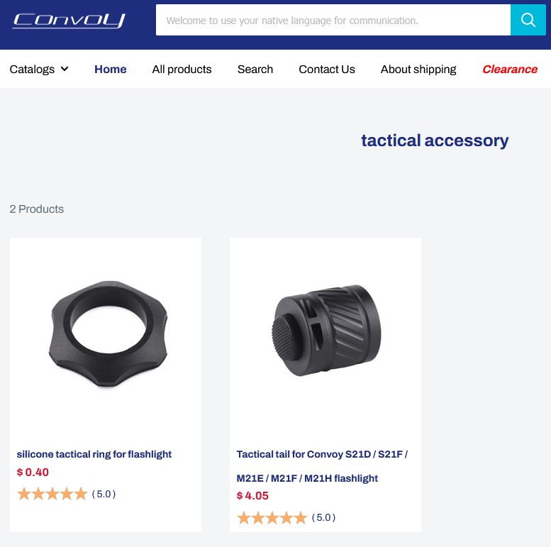

Convoy sells these. I ordered two and they sent four, lol. They work in the last mode used. You can turn it off and use the side switch to set any level and then use the tail-cap in that level...
I've seen the tactical forward tail switches. But didn't know they added that functionality. I assumed it was basically a lockout.

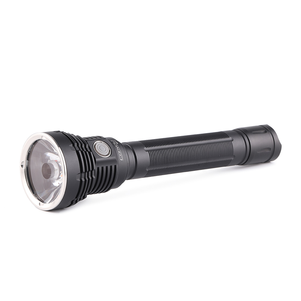

Been meaning to mention this::
The buck driver for the L6 that's 6V @ 8A has a Low Voltage shutdown at 6V
I was ceiling bouncing my L6 and it turned off, so I didn't actually see the Low Voltage 'flash' because I was in my basement.
Mine has a 70.3 in it running 2x26800 cells and the runtime was incredible (must have been 70 hours on low, maybe more)
to the point I checked the voltage on the batteries twice* since I wasn't sure there was a low warning/shutoff
=== there was💫
*the first time my batteries read 3.7V each, laughed to myself thinking how long it already ran.
