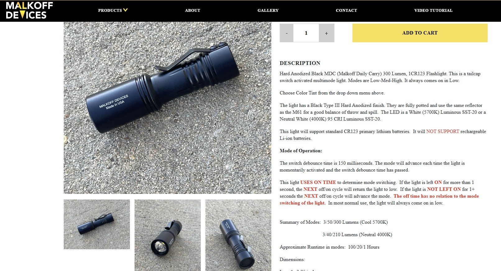

You've described the Malkoff MDC 2AA/1CR123 Flashlights
They're already available

Malkoff (on his site) offers the 2AA and 1CR123 in Neutral (4000K) 95 CRI
    341.5 KB
